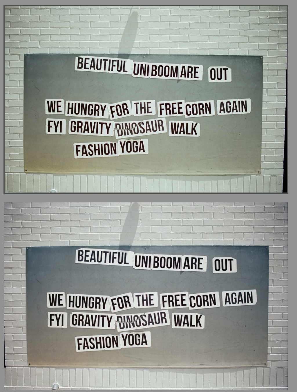

I have a really dumb question. I shot a roll of Ektar last week and had it developed and scanned at my local lab. I took the same photo twice because I thought my settings were off for the first image but apparently it was okay. I do think that one had a darker exposure than the other. Exposure wise they seem fairly similar from the scans, but the white balance on them is vastly different. Is this a scanner issue? I think the yellower one was the "underexposed" one but I wouldn't have thought it would make the bricks yellow.
I know dropping luminosity slightly CAN help make colours more vivid. Also, it looks sunny with light from above. Was the light changing because of clouds etc? Second image is definitely cooler in appearance. Weird one. 2 scanners at the lab? or your scanner getting hot and affecting the colour readings maybe? How are the negatives? are the captured images different?
Two things come into play here:
  • Film is not linear, color film even more so. The individual color layers will not respond to varying exposure perfectly uniformly. This can result in slightly different color rendition is shadows and highlights and will result is slightly different color in overexposed and underexposed images. In fact, a whole family of Kodak color films were intentionally designed to shift color balance toward the blue when they were underexposed. Kodak had found that the vast majority of underexposed images taken with their more amateur orientated films were shot available light, either intentionally or when a flash failed. This shift made adjusting the printer to get decent color out of these images much more successful.
  • The scanner's reaction to the differing densities of the two images may result in its auto-color balancing producing slightly differing color rendition.
These, plus the fact that color negative scanning is a difficult thing to get right, mean that you should expect to do final color balancing after scanning.
No, I think all one scanner. I haven't looked at the negatives, although I know logically that's the right answer. I just don't see color reversal very well....
Light might have been slightly variable, but not that much. The two images were taken maybe a minute apart.

Yes, I don't mind color balancing in post, and I am finding that tweaking contrast on all the scans is giving me much better results for final images. I feel weird doing it, because I grew up using point and shoot cameras with film, and you just got back what you got back, but I know that if I were doing this all on my own in a darkroom I'd have all the latitude that I want. And I can rescan these at home, but I shot two new to me film stocks, so wanted lab scanning for the first roll of each to know what sort of end results I should have going forward. And I have done scans at home with a camera and negative lab pro and there are allllll sorts of tweaks that can happen in the conversion process from negative to positive, and then more after converting, so I am coming to grips with the notion that post processing film is the way to go. 🙂
Thanks for your inputs. I'll look at the negatives later.
