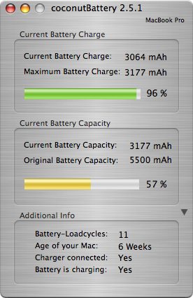

So, I have my 15" MBP - with no issues at all. Battery times are fair - 3.00-3.30 runtime. I installed bootcamp, then followed by windows. Which at first seemed to work fine - but it kept saying "cant find battery driver" in XP. Anyways, it became quite unstable, so I finally deleted WinXP again, repartitioned with bootcamp and everything was bliss - EXCEPT my battery seemed f**** up all of a sudden. Could windows have caused this? Or just a freak coincidence??
(check out my battery-capacity in this coconut-image)
EDIT: I have tried calibrating again - makes no difference!

I would guess freak coincidence. I see stories all the time about batteries going bad, never a story about how Windows causes batteries to go bad.
Is your MBP under the battery recall, mine was, have you had it replaced yet?
I would have to agree with ewinemiller, it is probably just a coincidence.
Nevertheless, if a battery cell is drained below a certain voltage, it can no longer be recharged, and the cell is dead. However, this is probably not your problem, as protective mechanisms are most likely hardwired into the battery to prevent excessive discharge.
Whatever the cause, call Apple and get a replacement under warranty. Just don't mention Windows and battery drivers.
Thx for the replies. No, my battery is not under the call-back. Its brand new, core2duo, only 3-4 weeks old.
I did call apple (didnt mention windows🙂 ) and they will ship me a new one.

This is from MSDN
"A battery driver provides other components of the operating system (OS) with information about the power level of the main battery, the backup battery, and AC power supply of a hardware platform."
All it does is feed Windows the info for the battery icon, when to shutdown because battery is low, that kind of stuff. Windows can't harm your battery through it.
