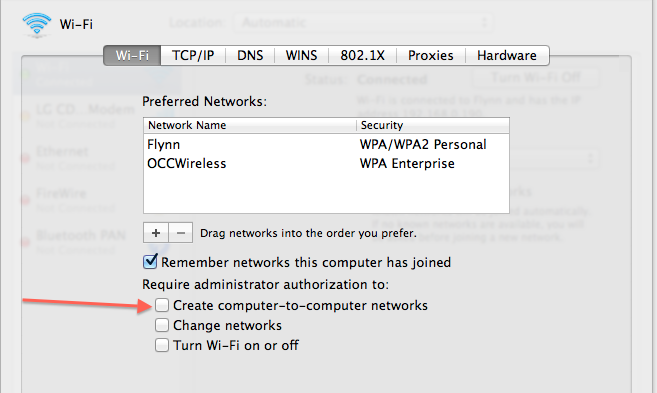

But hey after poking around for all of 5 minutes, I may have found something since airdrop is an ad-hoc connection...

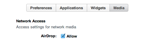

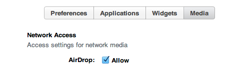

When setting up a profile for either a person/group or device/device group under restrictions you can disable AirDrop completely. So you could have AirDrop off while still having Wi-Fi access.
I'm in a remote location and don't have access to Workgroup Manager (handy that the profile manager is a web interface) at the moment so I can't check the MCX settings and if they are available, I'll check later this evening.

If I had known the question was directed towards an IT setting and not just "I'm concerned about security" my comments may have been worded differently.
Thanks. I have Ad-hoc connections disabled by default, I'm hoping that helps. Apologies if my original follow up to derickdub wasn't clear. In part it is that I'm security conscious, but mostly it has to do with securing IT resources for my agency. I should have been clearer, thanks for the follow up.
Awesome Chris, thank you.
