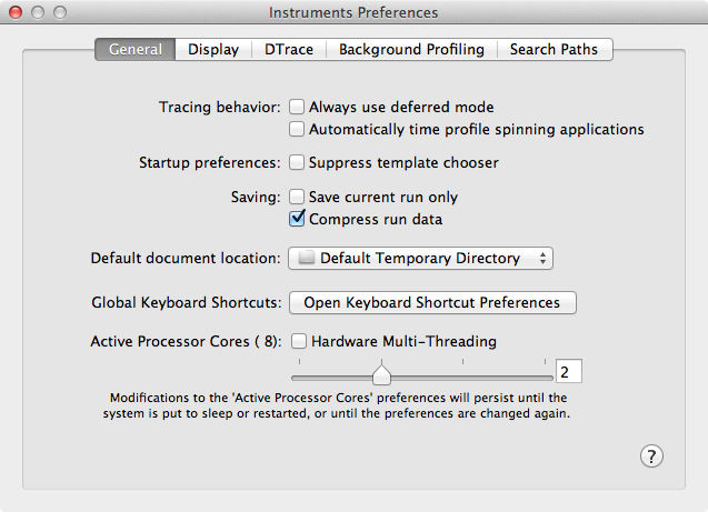

Anim
Yes, you can. Use Xcode Instruments.app. You can set active cores amount in preferences. You can enable/disable hyperthreading as well. See attachment.

I noticed that the Xcode tool had a checkbox to turn off hyperthreading.
