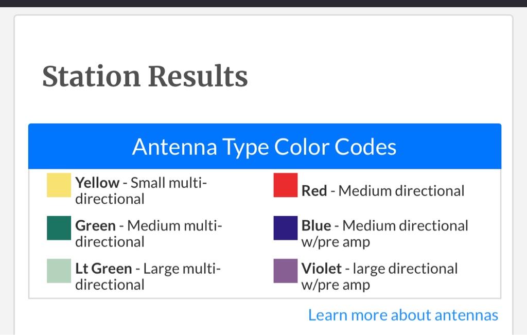

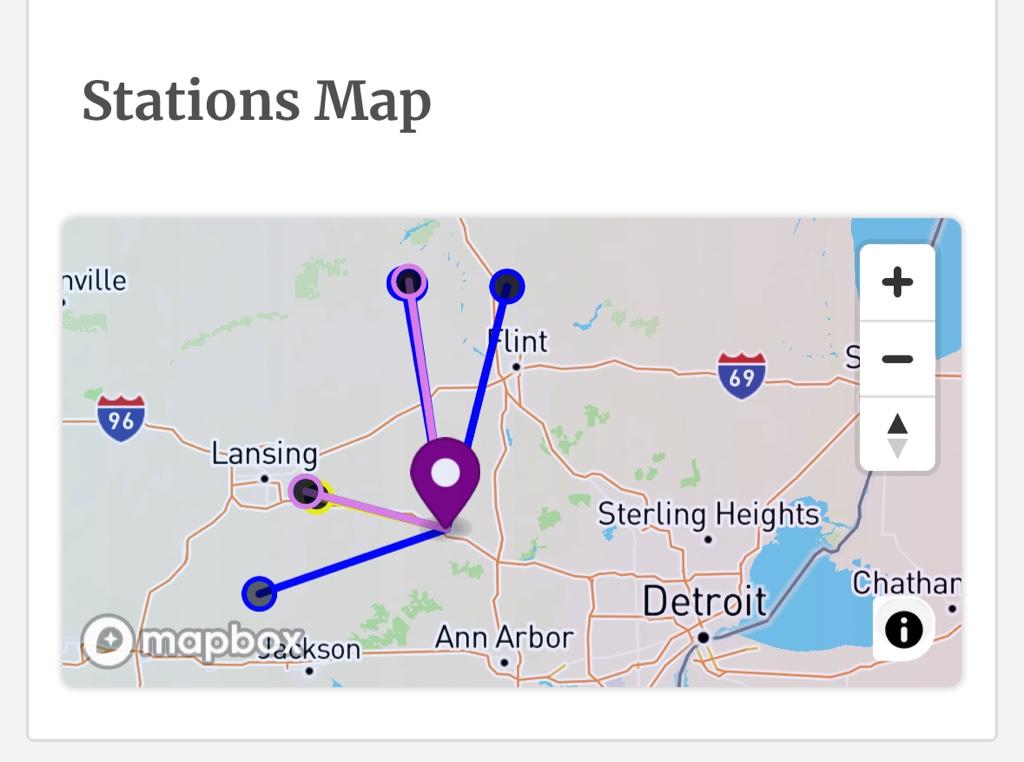

OP, you can use a website like Antennas Direct to locate the direction and distance to any TV transmission towers in your area. There are other websites too, you can do an internet search for them. Most of them want to sell you an antenna, so just ignore that and use the site to see how far away the towers are and what the estimated signal strength each should have at your address.

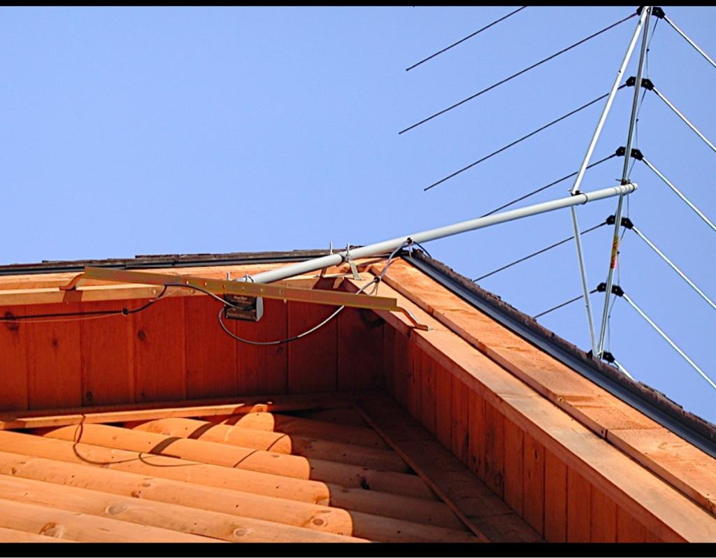

Here ya go. Not the prettiest, but it will work like a champ:
and this….
and this….
Agree with Channels.
But for someone having issues getting a signal a directional yagi antenna is far more suitable. The one you suggested is more designed for receiving signals from different stations and will have lower gain than a good yagi antenna.
OP, many assumptions are being made for you here. You need to share more info for better advice. My suggestions are:
  1. Use AntennaWeb.org to see if you have a real chance to lock signals you desire.
  2. The higher your antenna, the better your chances. Rural mountain top almost certainly better than deep valley. Signals won't cut through mountains to get to you if you are in a valley.
  3. If you find you are too rural, there is no magic solution. Don't be suckered by promises of 100-150-250 mile antennas. Move closer to TV towers or go with streaming services or cable.
  4. Another thing that is going to influence an antenna recommendation is the results of that AntennaWeb.org scan: any desired channels located on VHF frequencies? If some of yours are, that points to some different antennas than assumptions of UHF-only.
Based on your post, I read it like you can find weak signals... so there's hope. But AntennaWeb.org will clarify your actual potential and verify if you can use a UHF-only antenna or need VHF too. Then you need to break out a compass and consider location challenges (like valley vs. mountains) from where you are.

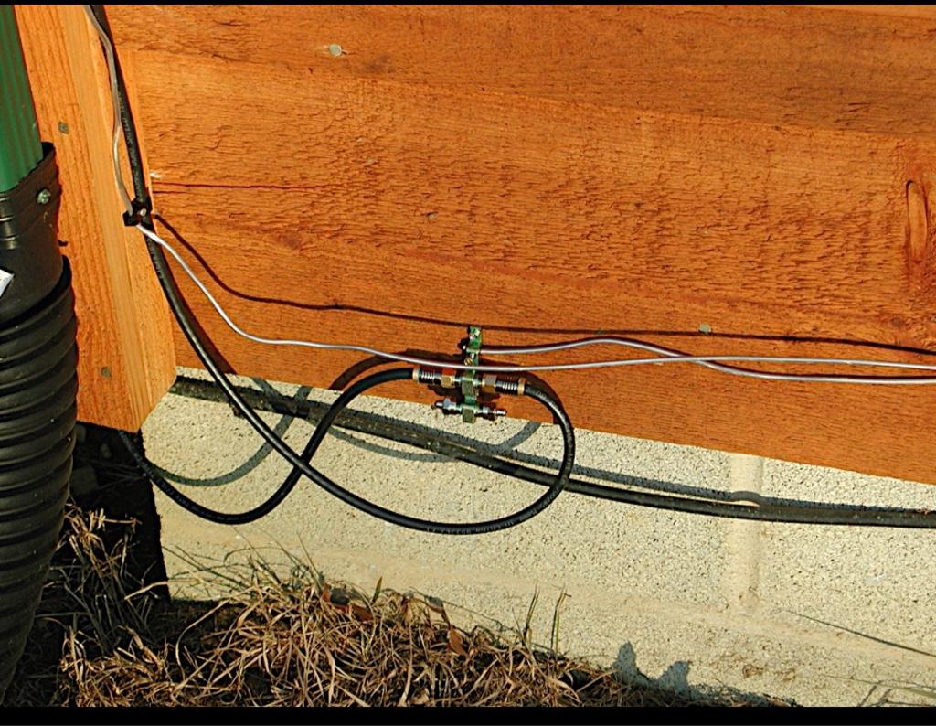

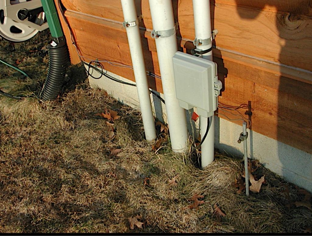

Way back in 2005 I used it, got a channel master deep fringe, use pre-amp at antenna to boost its gain as long coax run into the home, then an amplifier before I split the signal to 4 different home locations.
Proper antenna ground to stake is important for lighting strikes also.
