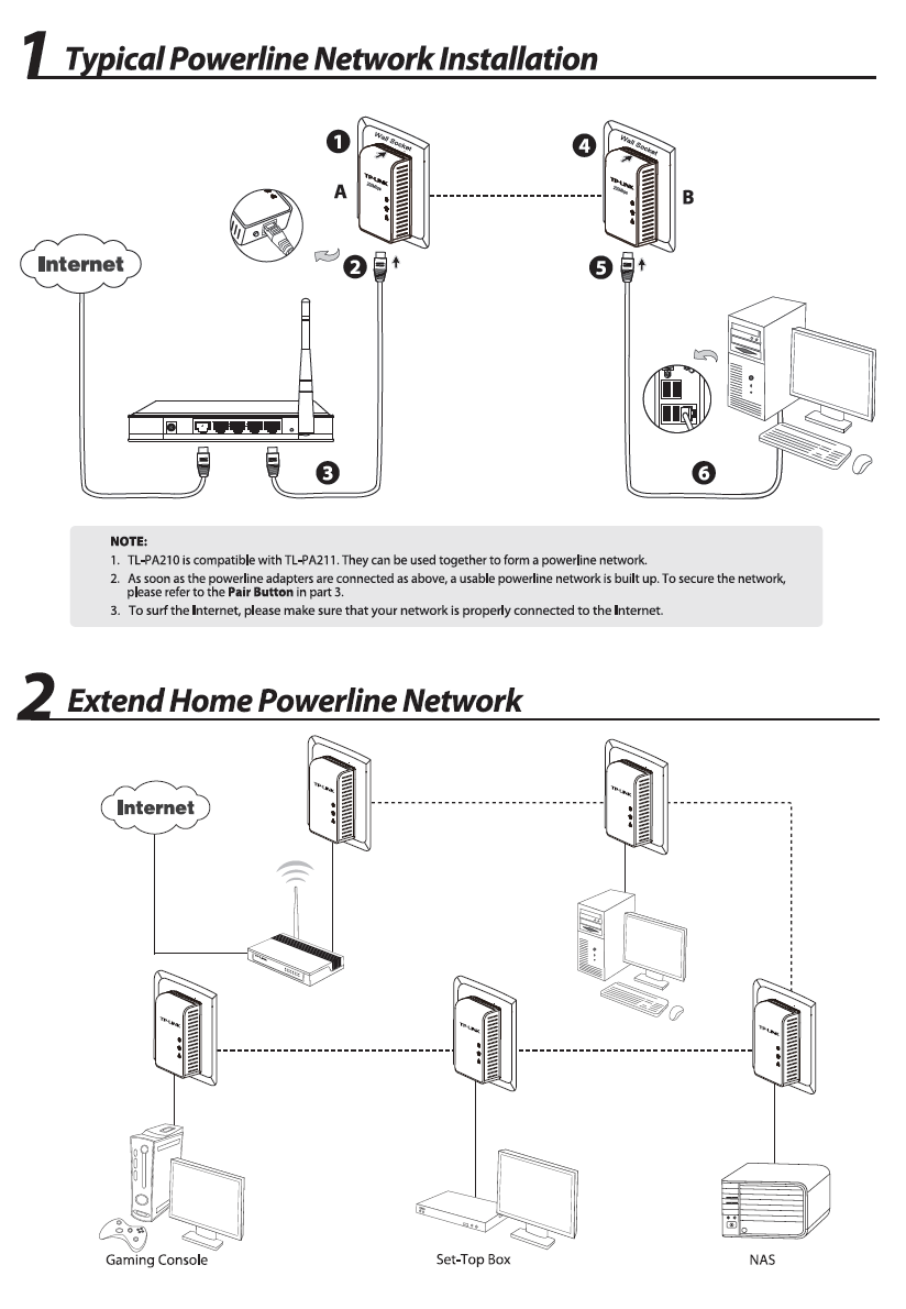

I still think that the ideal solution is to plug a power line into the common router and then a powerline directly into your mac.
The way this works is:
-the powerline box plugs directly into the wall powerpoint and is connected to the router using an ethernet/network cable.
-another powerline box plugs directly in a wall powerpoint next to your computer and the powerline is connected to your computer using an ethernet/network cable
-the data (or internet connection) is transmitted between powerlines through the house's power cables
This only works if your room is on the same phase as the router. ie. there has to be only one fusebox or equivalent in the house. You won't know this for sure until you test it. This is the one I have:
http://www.tp-link.com/en/products/details/?categoryid=1657&model=TL-PA211KIT
Costs about $50 for the pair.

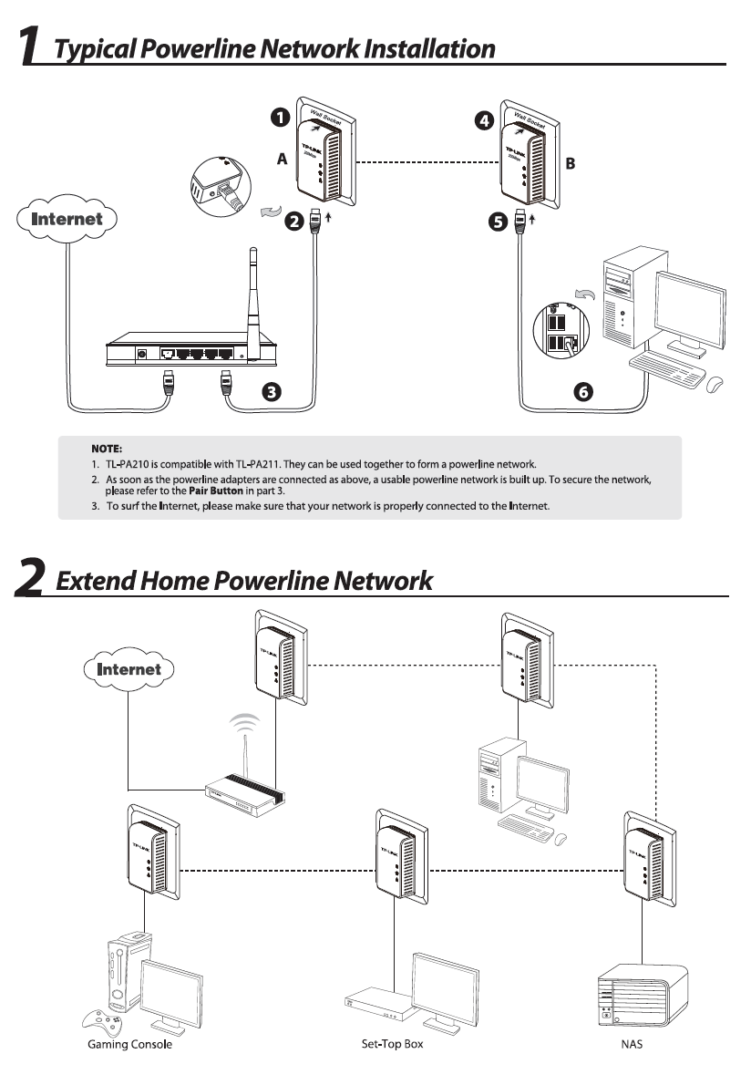

What type of router is it?

Option 1 in this diagram:
BTW that extended home diagram is an ingenious design!
I'm amazed that the circuitry can handle all that power distribution!

The other option is to connect the primary powerline into another router belonging to a renter who you have a better relationship with. The closer they are to your area, the more likely you are to be on the same circuit.
Running a long usb cable is no good. But you could run a long ethernet cable.
If powerline works, though, that'd be a simpler option.
Get a powerline starter kit and talk to your neighbours.
PS There's very little power required when compared to mains power. That's why option 2 works so well. I've got 6 of them!
