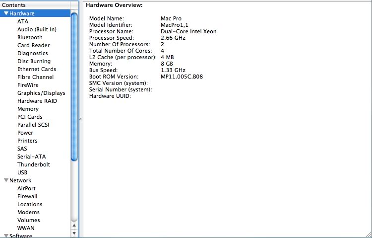

Lately, however, the computer is starting to have more problems. We use it to run our media presentation software (ProPresenter). I make video content that we show with the software and over the last few months we are seeing stuttering video, lag, and other general problems. Also, we use it to record music through our ProTools setup. Problems often surface there.
We have installed two identical video cards. One feeds our main screens in the church sanctuary, another feeds a signal to our overflow areas.
I've included screenshots of some of the current specs here:
So, I want to replace it with a computer with enough horsepower to do what we need, run hi-def video (1080) to multiple video outputs, and handle recording. Can someone point me in the right direction? Thanks!
-jon
Lowest end Mac Pro should be fine. One 5770 should do the job just fine, still way more powerful than what you have now.
I'd almost recommend a Mini for this work, but your drive requirements sound like a little more than the Mini is normally capable of.
thanks goMac. What specifically about our drive needs would you think pulls us away from a mac pro? Would a current mac mini be better than our old mac pro?
just wondering and trying to learn!

1st - I would take the current Mac Pro to an Apple Store for an overnight diagnostic - FREE
A mac pro 1,1 - with 16GB or 32GB should be plenty, since, at most, you are pulling 16 or so channels during recording
Bumping it up to an Apple 5770 video card will help tremendously
I suspect faulty RAM or Video Card/s here, or failing hard drives (I'm assuming you are running a separate internal drive for your Audio Sessions - EXCLUSIVELY for that purpose) - hopefully not a processor, PSU, or Logic Board issue
Although, all of those are fairly easily addressed
You could very likely replace ram, and video cards, and be just fine
Also, what OS are you running? I'm thinking you should be on PTLE8.0.5, but that depends on OS
You could bump RAM to 16GB or 32GB and swap the processors for X5355's or X5365's (5355's far more cost effective), and SSD for System and Audio if you can, and then you have tons of RAM and 8 cores -PLENTY for PTLE while simultaneously streaming video
This would be a cheaper solution than a newer Mac Pro - and still offers performance exceeding what you should need for your purposes
Given more substantial issues, if that's the case, and if you have the budget, then I would suggest a 2009 or newer Mac Pro with as much RAM as you can offer it, and PT10HD which will run in native mode with full capability (Like PT10 (native) with the complete production toolkit) but at a better price
Either way - I would start with taking it in to an Apple Store and having them run diagnostics - FREE - and you can have it back with answers the next day

Run hi-def video and handle recording? An iPhone has enough horsepower to do that. You don't need anything other then a Mac Mini.
I think for sanctuary use you're going to want to stick with a Mac Pro, as opposed to a Mini, because of the video output options (in addition to having the option for internal drives).
While it sounds like a Mini could run your current setup, what if you decide to add a confidence monitor or change to a multi-screen setup (like PP5 can do)? If you're doing any live video work, you might eventually want to add the Alpha Keying module too.
The suggestion of upgrading video cards/RAM on the current machine is valid too -- no reason not to at least try and get that working better (even if you got a new Pro, you'd still have a very capable machine).

These are all valid points. We currently do all our recording to a dedicated hard drive within the unit. It hasn't caused any problems. Granted, we dont tax it too hard. When we record a 16 channel setup, it is done from the front fo the room with a MacbookPro, a Digi003 and a Presonus Digimax to interface with. Otherwise, we use the MacPro for other lighter recording duties, mixing, etc...
I didn't know apple did free overnight diagnostics. That's cool. The nearest Apple store is about 120 miles away, so next time I can get everything together and be somewhere close for at least 24 hours, I think taking it in could prove very beneficial. Good idea, thanks.

The long diagnostic takes around 4 or 5 hours if the machine isn't 'slumping' it's way through it - so a good hunk of the day nearby should suffice
Did a reinstall take place prior to the issues?
You might wanna go through the Mac optimization routine for Pro Tools again to ensure you have the machine configured properly
Also, I haven't noticed it so much with PT8, at least not on my machines (ballsy-ish) - but....
Pro tools will 'look' at ANY drive connected, and DOES NOT play well with USB - so if you have ANY USB drives attached (HDD's, Flash, etc) , this can cause PT to bog the system.
Has to do with disk allocation on a slow bus
Just something to try. Remove any USB drives while running PT
I'll check out the mac optimization routines... its always good to double check that.
As far as a reinstall taking place prior to the issues, no. Its just something that has kind of gotten worse over time.
Yes, you are correct, PT does not like USB attached drives. We never record to them, but we'll try disconnecting during the next recording and see if that helps too.

I wouldnt use a mini for your application. In your setup, failure is not an option and you need a rock solid solution. A mini will give you a maximum of two video outs with an additional USB solution for a stage display. Even then, that would be a lot of pixels to push especially with a couple HD moving backgrounds in there. I love having that internal time machine backup.
Im a worship pastor/ technical director myself. We use a 2007 MBP to push a stage display and 720p projection image and usb stage display with propresenter; we are mobile so a laptop it is. We tried using a macmini for awhile but the usb to dvi adapter didnt like it.
I also have a mac pro 1,1 in my office, a super solid machine but here we are in year 6.
I would get a newer mac pro, maybe not latest generation, but one with newer guts. Also, i just put a 5770 in my 1,1 so so I could run FCPx, and it might prolong your MPs life as well. If you go new, get the base model with upgraded ram (assuming a refresh and not a product overhaul).
Also a Mac Pro would allow seamless expansion With a matrox triple head to go card if you choose to add environmental or side screen stuff later.
