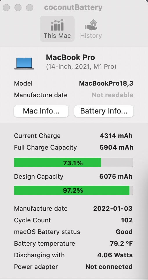

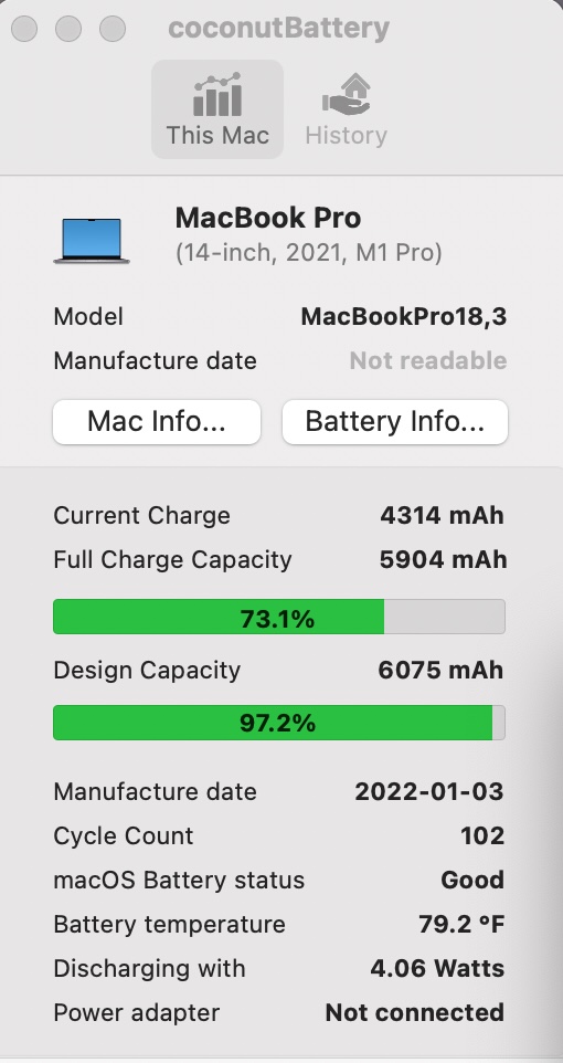

I just checked my own 2021 MacBook Pro 14" (bought in early February, 2022). Coconut battery shows 97% of design capacity still remaining:
That's GREAT for a MacBook Pro 1.5 years old which is used for several hours daily.
So... the charging routine I outlined above seems to work well enough for me. I've never seen battery "longevity" like this before!
A sample size of one isn't enough to conclude anything meaningful
