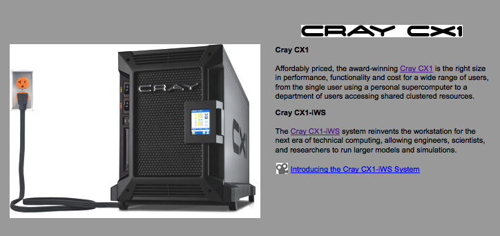

Yes. BUT I wouldn't describe this arrangement as a Supercomputer.
