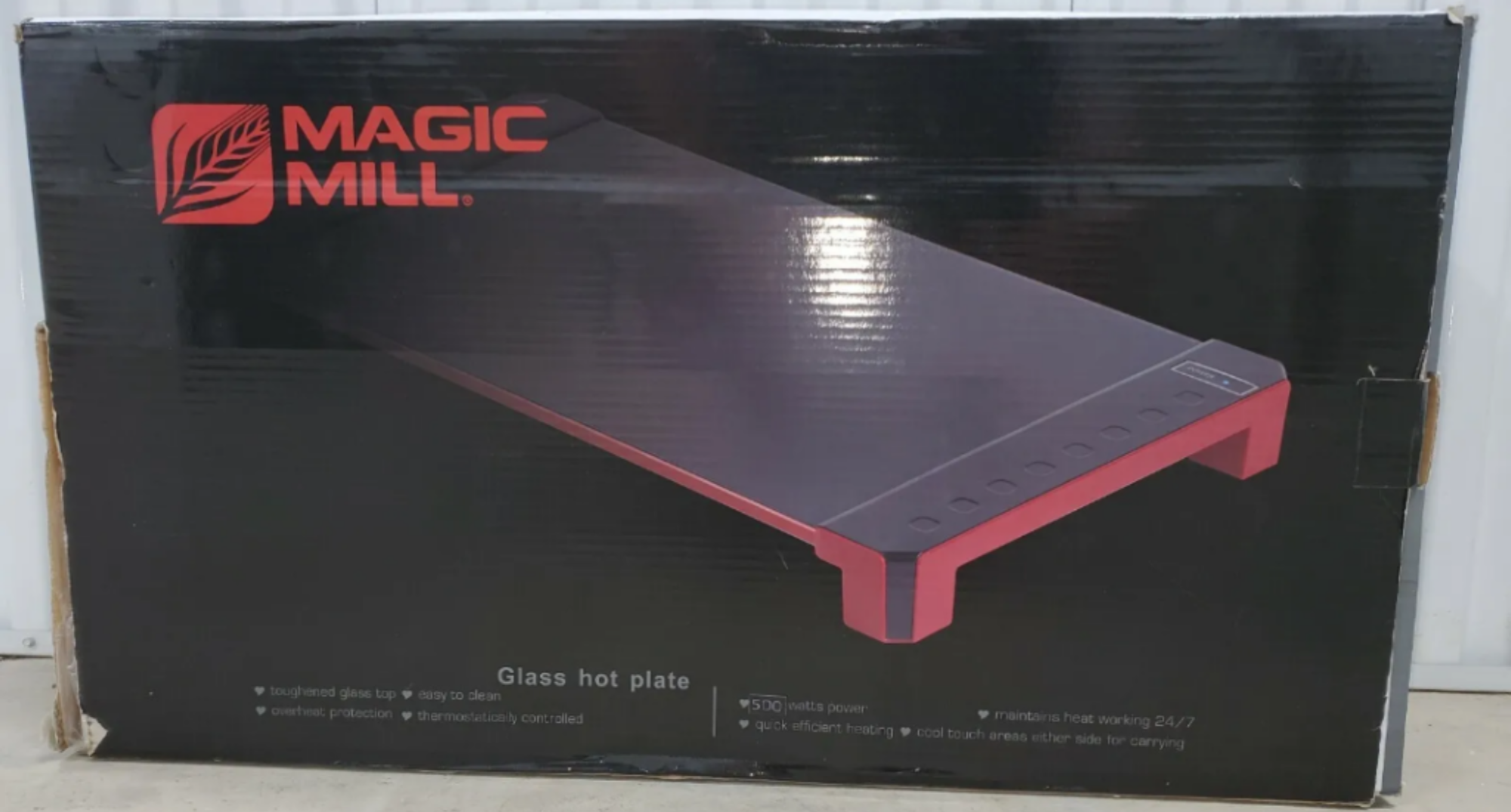

You are incorrect, the glass itself is removable although not an easy task for the average person.
This guide assumes you have removed the display from the machine.
The steps follow the same steps you'd take in replacing the glass on a smart phone.
An idea of the process. In my guide you replace his vacuum hot plate with a cooking hot plate.
Step 1. Buy a Hot Plate on eBay with the width that is the height of the screen.
Step 2. Place the glass on the hot plate.
Step 3. Set the heat of the hotplate to 70-75 degrees.
Step 4. Get a wire and swivel it back and forth in the space between the glass and lcd as you push the display forward off of the hotplate so it doesn't get exposed to heat for too long.
Step 5. Once the wire has made it through the entire screen you can remove the glass from the hot plate flip it over and with the help of someone have them use a blow dryer while you pass the wire through again. This time with the glass facing up. The second person can apply just a little lifting pressure to help remove the glass.
Step 6. remove the glue from the LCD screen. This is by far the longest part of the process as you don't want to use strong chemicals and you want to wipe the lcd softly to remove the glue until it shines.
Step 7. Make sure the room you're working in is not dusty and clean the new glass and lcd a final time. Apply b7000 glue to the lcd and try to keep it even throughout the display. In this step more glue is better than less glue as you don't want air bubbles to form in between the glass and lcd.
Step 8. Apply uv light to the glue so that it may cure.
Approximate repair time 2 hours for a beginner taking extreme caution.

Well I did mention it in my post it was going to be difficult. It's not for everyone but there are people out there that are willing to risk it like me.
Cooking glass hot plate :
