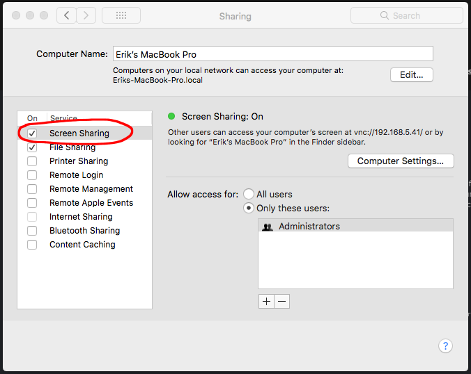

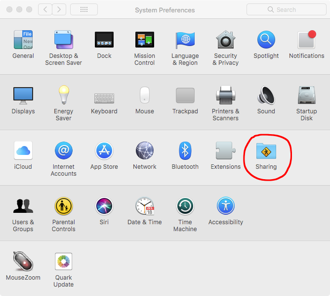

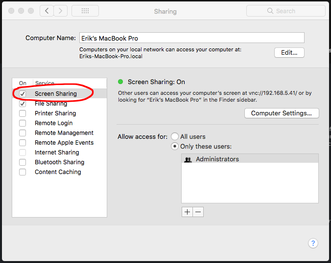

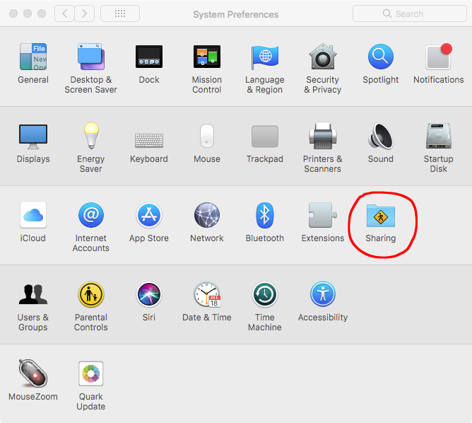

Screen Sharing is a basic function of Mac OS X. It uses VNC.
Open System Preferences, select Sharing.
Check the box that says Screen Sharing to turn on Screen Sharing.
This works whenever your Mac is logged in to your account. If you want to be able to use Screen Sharing from the login screen you'll need something that loads on boot. For that I would suggest Vine Server: https://sourceforge.net/projects/osxvnc/
