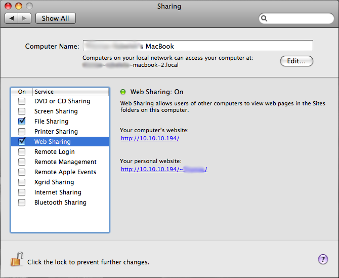

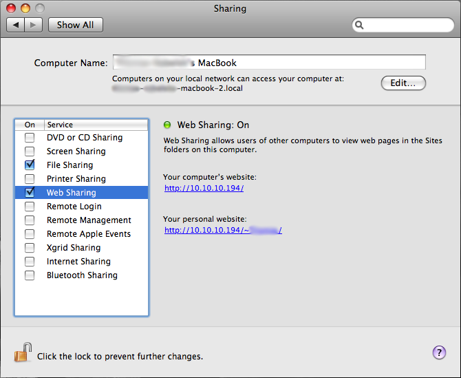

I have been trying to enable the apache server on my computer, but I cannot access it. I have Web Sharing turned on (see attached picture).
But, whenever I click on either link, Safari tells me:
"Safari can’t open the page “http://10.10.10.194/” because Safari can’t connect to the server “10.10.10.194”."
Can anyone help?

I tried restarting my computer, no luck. I just happened to look at the system.log in Console and noticed that every 10 seconds, these four messages appear:
Aug 4 20:22:42 macbook-2 org.apache.httpd[356]: (2)No such file or directory: httpd: could not open error log file /private/var/log/apache2/error_log.
Aug 4 20:22:42 macbook-2 org.apache.httpd[356]: Unable to open logs
Aug 4 20:22:42 macbook-2 com.apple.launchd[1] (org.apache.httpd[356]): Exited with exit code: 1
Aug 4 20:22:42 macbook-2 com.apple.launchd[1] (org.apache.httpd): Throttling respawn: Will start in 10 seconds
What's with that?
And I typed "sudo apachectl -t" into Terminal, and got "Syntax OK".
Resolution
I solved my problem.
For some reason, I had no folder named "apache2" located at /private/var/log/ like I should have. I checked two other computers and they had it, so I added the folder, and it filled with three files: error_log, access_log, and accept.lock.1467. The console errors went away and I can now access the server fine.
