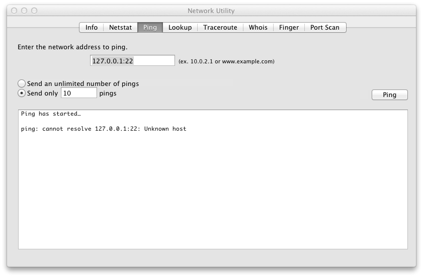

I did. I have ssh running on my system:
Code:
$ telnet 127.0.0.1 22
Trying 127.0.0.1...
Connected to localhost.
Escape character is '^]'.
SSH-2.0-OpenSSH_5.6
But as you can see from the attached image, the Ping Utility doesn't know about ports.
Are you using Lion?
jas

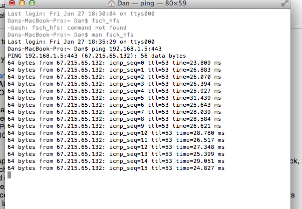

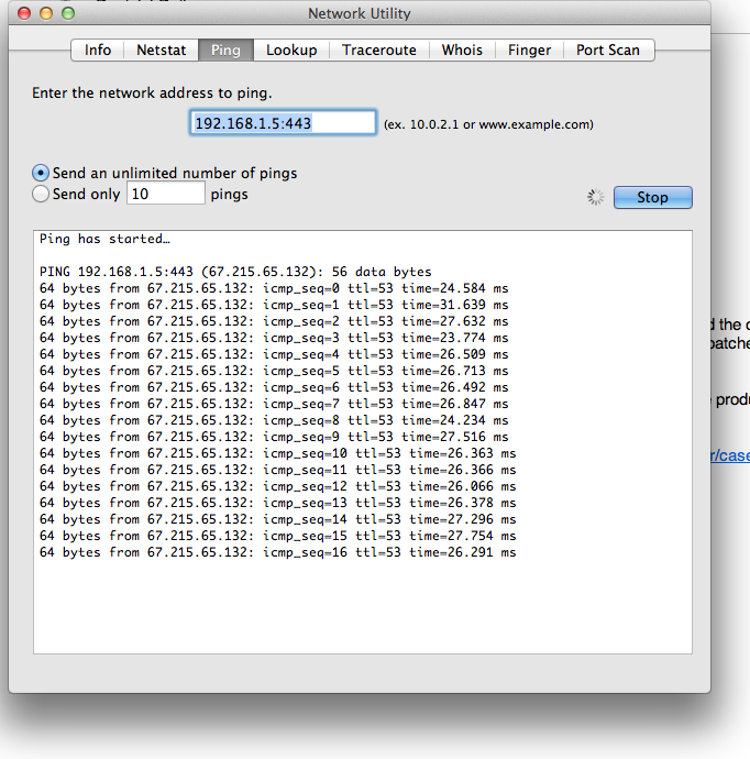

Yes I am on Lion:
Enclosed screen shots of it working for me, as it resolving to the correct web server address
Yes I am on Lion:
OK, I'm not quite sure what kind of network you're sitting on right now, but it looks you have some sort of DNS poisoning/caching/altering going on there. In other words, any lookup you do, you get back the same IP address.
Is there some sort of web-based proxy or firewall (or both) that you have to pass through to get out to the intardwebz? What you're seeing is NOT normal, and is NOT the way ping works. What you're seeing is a funky resolver response that's getting, well, anything, and returning an IP address.
Is that 192.168 IP the one on your Mac right now?
What happens if you try it with the same IP, sans the port?
jas
Sans the port everything returns the way you would expect. With the port, I get redirected to the correct IP address as would be expected for me with the site hosting. Yes these are set up accordingly in my routing table, so no poisoning taking place. Like I said, for me it is working with the UDP settings as I specified earlier. Mine work the same as if you were to ping an url and not just an ip.
An <ip>:<port> nomenclature denotes TCP, as in your example with the http:// prefix in front of it; that's TCP 80. TCP 443 is SSL. Not sure what UDP 443 is, but it appears some have seen it with Skype.
Anyway, ping does not do TCP/UDP. My guess is the port in your example is just being removed/truncated. You can see clearly in your results by the ICMP sequence number. Even better, do a tcpdump on the host you're pinging from and check the packets. That's the only way to definitively prove it. You may think it's UDP, but it's not. I'm not sure why you'd even think so.
My guess is you're using OpenDNS or your DNS provider tries to search for your request automatically. Many ISP DNS providers do this these days, so that if you mistype something, it goes to another host to help you find what you're looking for. In this case, it's trying to lookup "192.168.1.5:443" as a hostname or FQDN, not an <ip>:<port> combo. Thus, it's redirecting you. Another indicator is the ping response time. A local network, especially a home network, wouldn't have response times in the 20-30ms range. It would be much less.
If what you're saying were accurate, you wouldn't get replies from anything but 192.168.1.5. In your case, trying pinging both 192.168.1.5 and 192.168.1.5:443. My guess is you get replies from different IPs. Another option is to disconnect your Internet line and retry the ping.
Linux had a utility to do this sort of thing and it was called hping. Not sure if it exists any more, as I don't use ping to test connectivity.
Nope not being removed/ truncated as like I said when sans the port it returns as expected in this case the same ip address as the original ping.
You keep saying that but it doesn't make sense. Why would a ping (echo request) to 192.168.1.5 receive and echo reply from another address? The only time I've seen that is when you have a routing loop, but then you get a TTL expired, not an echo reply.
Note how it resolved "192.168.1.5:443" in your output window. It resolved that to another IP, so it is going to DNS first, instead of to the IP. That means it is trying to resolve it, like it would any other hostname or FQDN.
