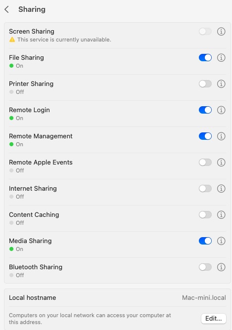

Can you be more specific regarding your file sharing config on the Mac mini.. perhaps a screenshot?
I've quite possibly got things switched on that don't need to be. I don't know why Screen Sharing is showing as "currently unavailable", because it definitely works.

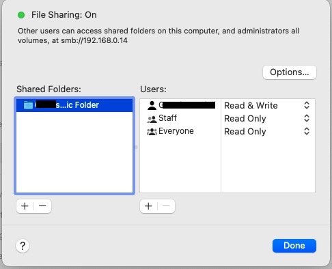

What I can't do is click on the mini in the MBP's Finder, browse its attached USB drive and pull files over the network, which is what I want to do. It used to work perfectly, so this is particularly annoying.
The folder being shared in the screenshot is on the “attached USB drive”? If not, perhaps you need to add the USB drive root folder.
No, it's not, but I don't remember having to enable sharing of specific folders before. I've tried adding the system drive of the mini as a shared folder, and the MBP still won't see it or let me use Connect As to browse the mini, but screen sharing works fine.

As for the original question about file sharing...yes, you need to add folders to share. You can share the entire drive, but keep in mind one may be able to see the share the drive, but still not access everything on the drive due to permissions. Adding the home folder should be enough, as that's where the user files should live.
