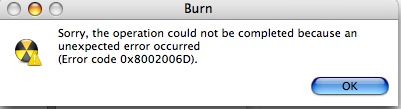

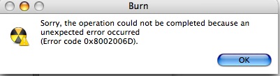

I am trying in vain to burn a dual layer DVD with my new MacBook Pro 15".
It should work..... I tried both the Finder Burner and Toast Titanium 8......
Here are the errors it is giving me :
Please Help !

Possibly incompatible media. I have some DVD+R DL's that don't burn on my PowerMac but work fine on my MacBook. Try using a different brand of discs.
I had the same problem, and continue to have it from time to time. I have heard that zapping PRAM can fix it. Maybe it does, or maybe turning the system off is what fixes it. There are definitely a lot of dodgy drives in the MacBooks.
i'm using Memorex DVD +R DL
and also tried a SONY DVD DL.
it has to be my drive that is bad.......
Had this problem. Setting the burn speed to 2x resolved it for me. Seems that the maximum speed setting wasn't working so well with the Sony DL DVD's I have.
Yes, one of the software updates last fall broke dual-layer burning. I forget which at the moment, but there was discussion on Apple's boards. I haven't yet re-installed the machine from pre-update status to confirm which one did it.
I've had this problem at random with Toast with DL and regular media; seems to be a media incompatibility problem.
