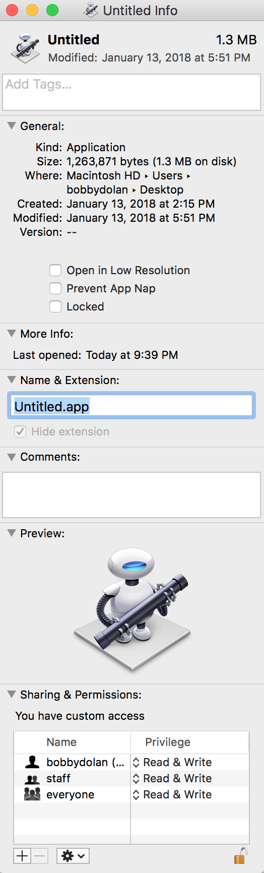

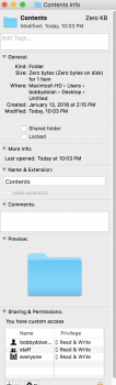

Hey guys! So I saved an application I made in automator to my desktop. Went to delete it today and it won't delete. I've tried everything. In fact, it won't even move off my desktop. I drag it to the trash, it asked me for my password, makes the trash noise, but stays on the desktop. Same thing happens when I try to move it. I hear the drop noise but it is still on my desktop.
If I show package contents the only folder inside is an empty folder called contents, which cannot be deleted no matter what I do. I have tried every terminal command (unlocking, rm, etc.), disabled system integrity, tried several third party apps, and repaired permission.
Please help!

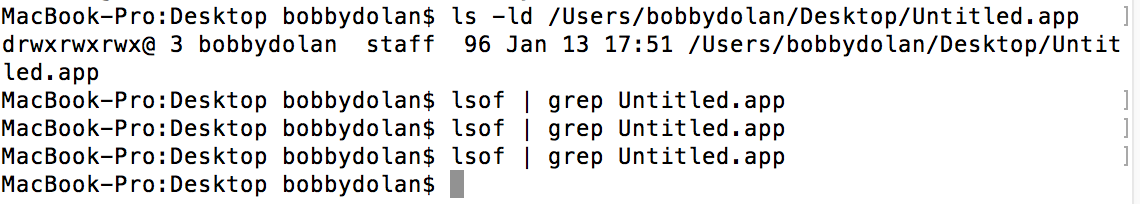

Untitled.app is a directory (as all .app "files" are), so what you're getting is a list of the contents of that directory, which is another directory inside it named "Contents". To see the permissions of Untitled.app itself, add the 'd' switch to ls:
ls -ld /Users/bobbydolan/Desktop/Untitled.app
BTW, your ls above is telling you that "Contents" owner is "bobbydolan" and group is "staff" (both are as expected).
The problem is most likely not permissions, but that the app is still in use somehow, i.e., some file(s) in that .app directory are still open. This can be checked with:
lsof | grep Untitled.app
This will list all open files and then filter that, returning only lines containing "Untitled.app" in the path. The first name on each line is the app owning the file, which you may be able to quit to release it.

Okay I did what you suggested and got the following.
(1)
drwxrwxrwx@ 3 bobbydolan staff 96 Jan 13 17:51 /Users/bobbydolan/Desktop/Untitled.app
(2) I put in "lsof | grep Untitled.app" and nothing was returned.
