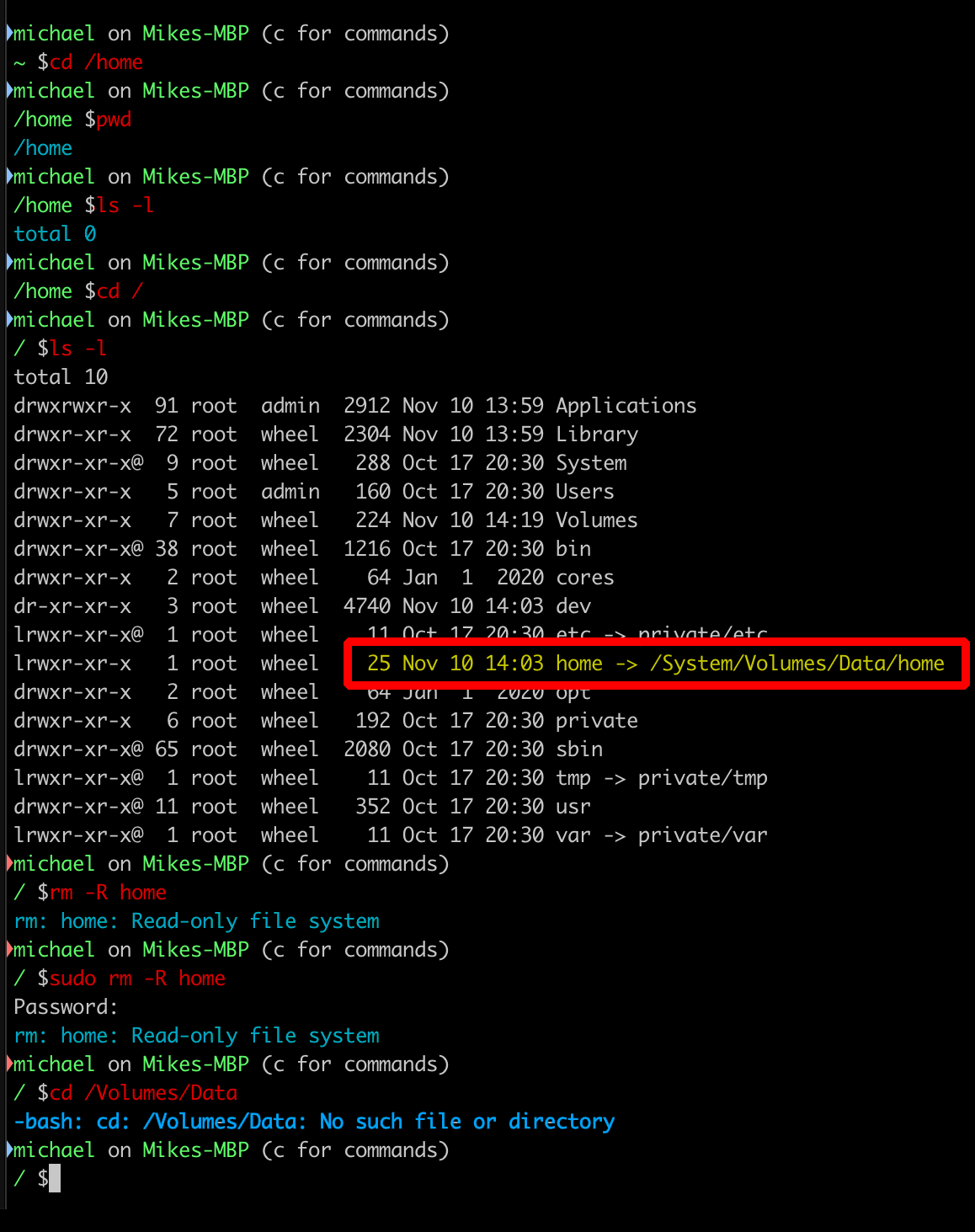

Hello,
I have an interesting problem.
I have a link file in the root of my boot drive called 'home' which is giving me grief and seemingly impossible to deal with. When I do an ls -l / it shows me this:
lrwxr-xr-x 1 root wheel 25 Oct 25 23:13 home -> /System/Volumes/Data/home
It should be noted that the drive /Volumes/Data is NOT mounted and is in fact disconnected physically from the computer. It is an external, 8TB drive.
When I issue this command, I get this response:
$rm -R home
rm: home: Read-only file system
I tried rebooting into recovery mode at which point I was able to see AND REMOVE home from the MacOS - Data volume (which is an APFS container and NOT the actual external drive called Data). However, when I reboot, the file still exists and I cannot delete it.
When I boot into single-user mode, I don't see the file, though I'm not sure I'm actually looking at the root of the same volume and I'm not quite sure how to know that I am looking at the same volume.
Any ideas on how to deal with this file or how to remove it?

Also, as I stated in my OP, I did try to remove the link from within terminal without success. Here is a screen shot that I just took showing that I can CD into the "folder" / symlink without any arguments from the file system, and then I go to the root and do an ls -l where you can see that it's a folder pointing to a non-existent location (/Volumes/Data DOES NOT EXIST) which I show by attempting to cd into that location. I colored my commands and the responses for contrast, making it easier to see the relevant information in the screenshot.

There does appear to be a standard symlink from /home to /System/Volumes/Data/home. On my machine, that directory exists, but is empty. It is a read only directory. Your 'rm -R home' command is trying to delete the file hierarchy at /System/Volumes/Data/home, which exists and is read only.
It looks like you are saying /Volumes/Data is not mounted, but this link is pointing to /System/Volumes/Data which is a different directory and not a removable drive.

Do NOT remove this link, it is part of your OS.
If you look on your SSD container disk 1... in the current macOS, you have two volumes by default. System volume, mounted read only under normal conditions, with system. And then each user (I think?) has "...- Data" volume. this is where all the Applications and user data are - this is read-write. This is the new layout of system protecting the OS files.
This link is simply OS created link to homes for user on that SSD volume called "... - Data" where your data reside. On my mac is it called "Macintosh HD - Data". Look in Disk Utility.
The fact you have another external drive with name "Data" is inconsequential, this has nothing to do with your Data external drive.

Leave it alone. That symlink is supposed to be there. It has a purpose. It's present on all my Macs.
As a network engineer, this might be hard for you to hear, but stay out of the root of the system. Let the OS manage things at that level.

You're absolutely right ... how in the hell did I miss that? wow... I think I just saw Volumes/Data and since that's been the location of my external data drive forever ... I just zero'd in on that part of the path ... damn... nice catch.
And so it seems that I have seen a problem where none exists because I have had a /Volumes/Data folder for years up until recently... this might be the most useless post Ive ever made. ☺

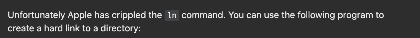

Just to be thorough on this topic ... here are some discussions where clearly other people are talking about apple nerfing the ln command ... and I specifically remember this being an issue for me in the mid 2000's - ish... here are some links where Apples change to the ln command are specifically mentioned:
and this one ...

I think whoever made that comment got it wrong. I'm pretty sure no modern unix variant allows general hardlinks to directories. In some flavors you can try to force it with flags, but I'm not sure it works much better than pushing the walk button at a busy intersection.
What Apple did when they introduced TimeMachine is reintroduced directory hard links (that's how incremental backups are done) but only TimeMachine gets to use them. I've seen people write their own custom linkers using the link() system call, but...
