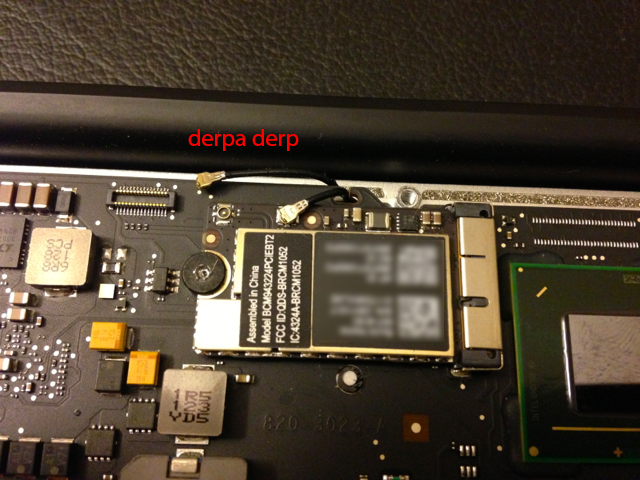

.... and it's fixed .... once again showing that "Apple Genius" is a huge misnomer to say the least.
As you can see, after replacing my logic board, one of the antenna wires was completely unplugged. That picture below is exactly how I just found it after opening the case.
Thanks Apple. Good thing everyone has a pentalobe screw driver in order to open their Macs and double-check that the Genius (now I'm using it sarcastically) plugged in everything that needed plugging in.
Seriously, an unplugged wire was the last thing I expected. I opened the case to see if reseating the wifi card would fix my issue.

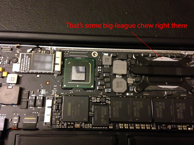

As an aside, check out that planet-sized glob of thermal paste. Eesh, I'll have to redo that another time.
