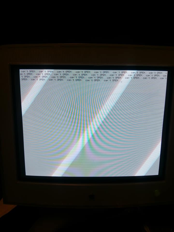

This G3 just refuses to boot OS X. It's a 300Mhz "Mini tower". 384MB of ram, and an ATI Radeon 7000 32MB GPU. According to LEM I have a REV 2 logicboard.

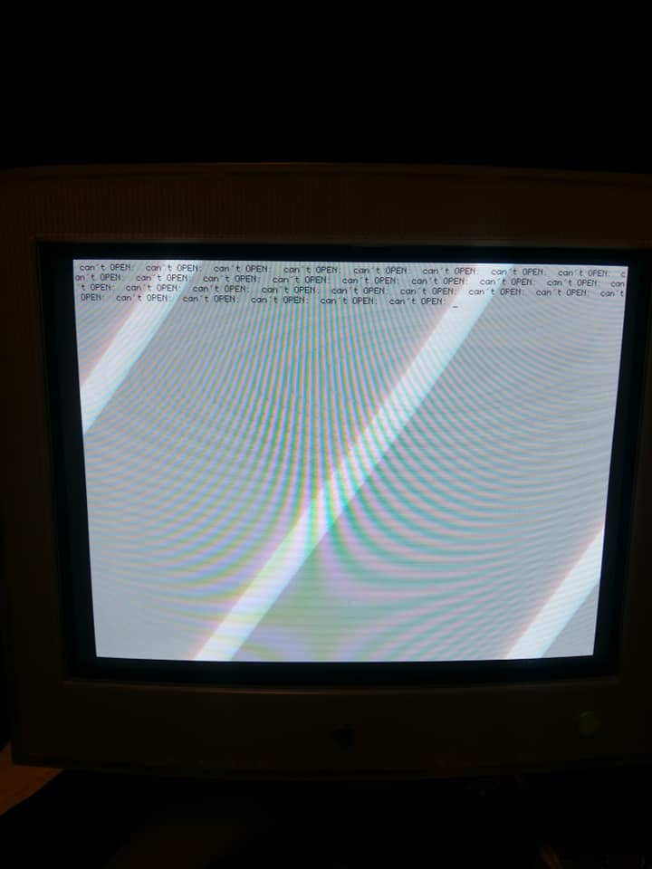

Mac OS 9.2.2 installs and boots just fine. What happens is when selecting the OS X install disc in Xpostfacto, it gives me this "can't OPEN" over and over again and eventually reboots.
I am trying to install Tiger. Now, this also happens with Jaguar which is officially supported on this machine. It can boot the Jaguar install disc, but once installed booting to the internal HDD with Jaguar gives me the exact same output, forcing me to boot back into OS 9.
I have been at this for about three days. The only thing on google I can find about this is to "Make sure the hard drive jumper is set to Master". Trust me, it is. So is the optical drive.
I've tried different hard drives, removing the ZIP drive completely, I even put in a DVD drive to try a regular Tiger DVD. Same story. It just doesn't work.

What is going on here is Open Firmware can't boot from you HD.
Either your 8GB partition isn't the first partition on your HD, or the partition table is wonky. Some people had luck with the 2nd issue partitioning the HD with Intech Hard Disc Speed Tools, while other times it was necessary to completely replace the HD with one that is compatible.

the cant Open message in open firmware means its been told
"Hey load this file from this location and boot from it"
but open firmware cant find it, hence the repeated "cant open"
OpenFirmware is being told to Boot from somewhere/something it cant either find or read properly

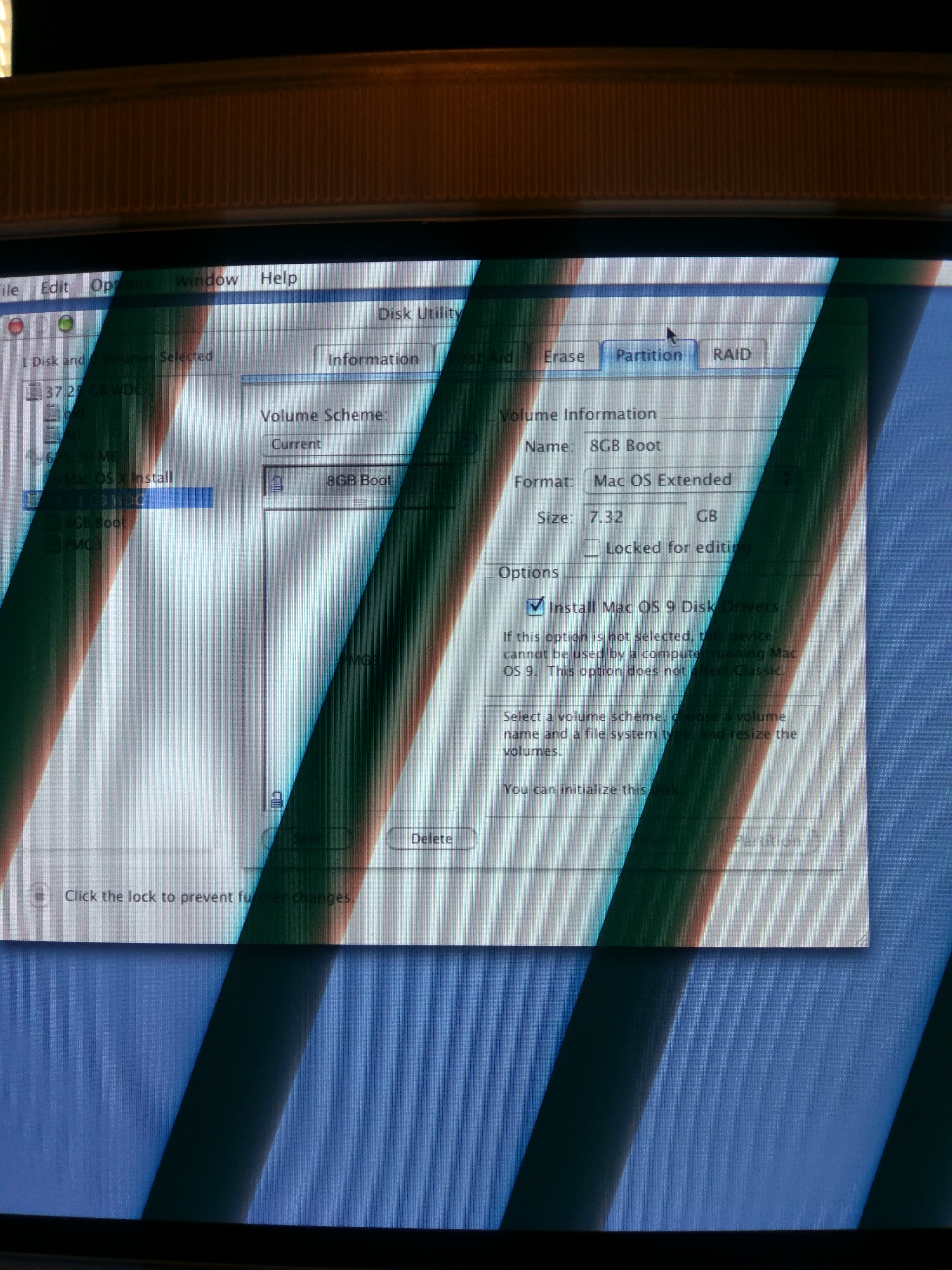

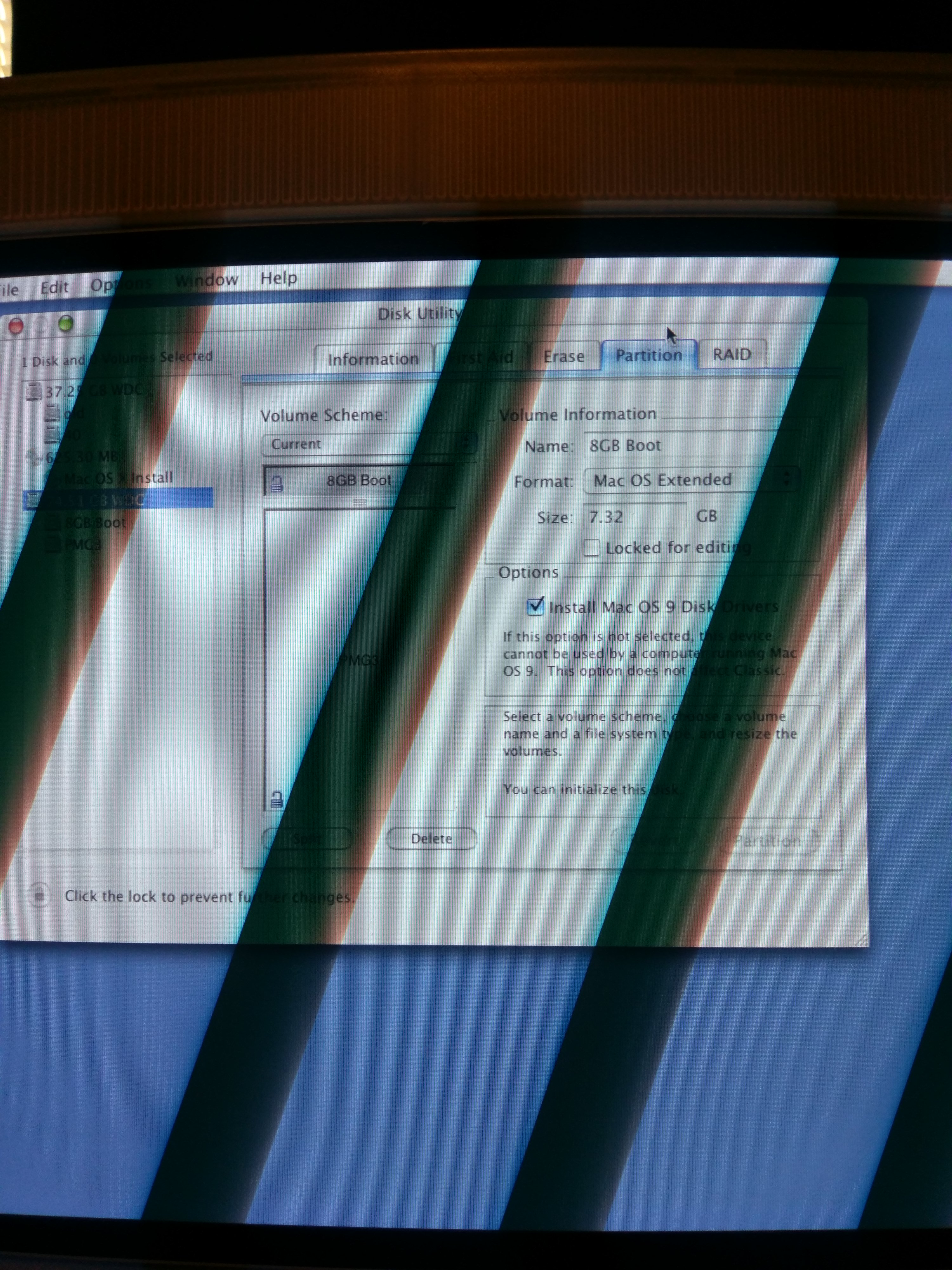

post a picture of your partition setup in disk utility I want to verify with my own eyes that its good if you dont mind 🙂
(mind I imagine if you got it wrong, 10.2 would not let you install as its installer checks its within 8GB)

Here is a picture of Jag's DU on the install CD. I apologize about the lines, I'm using a Studio Display CRT on this thing. Under 8GB at the beginning of the disk.
Though I think I may try again using the ATA card. I actually have 2. The aforementioned one I just figured out is a Sonnet Tempo ATA133. The other is in my B&W, and I'm thinking that might be the ACARD one. I'd prefer not to open the B&W if I can help it.. It's location on a shelf requires me to move an entire desk out of the way, the tower is too tall to be pulled from anywhere but the side. Will the Sonnet card work in this Beige?
yep partitions look good to me, you can try the Sonnet card, it SHOULD work in theory

Correct, installing OS X to the 8GB partition results in the "can't open" error.
I can try that, Jaguar is still installed on the drive I was using the first time. I assume that has something to do with why when booting the CD, the computer restarts after the happy mac, then proceeds to boot the OS X CD?
exactly 🙂 the OS X installer is setting the NVRAM to boot OS X directly from the CD, which in my experience also works for booting OS X off the HDD too if ya plug the HDD into where the ODD was plugged into

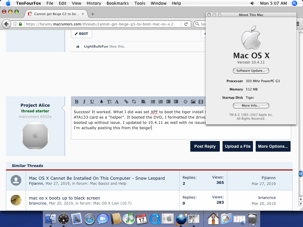

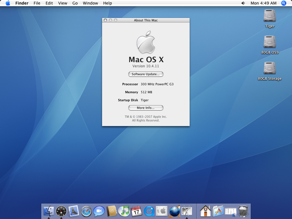

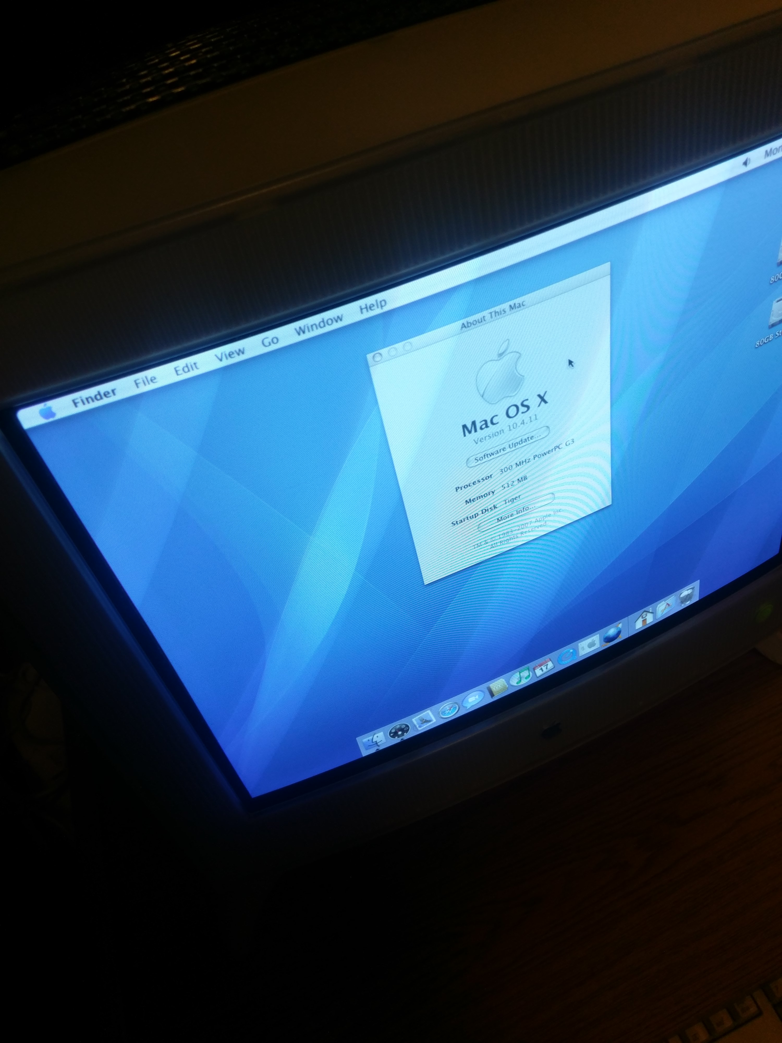

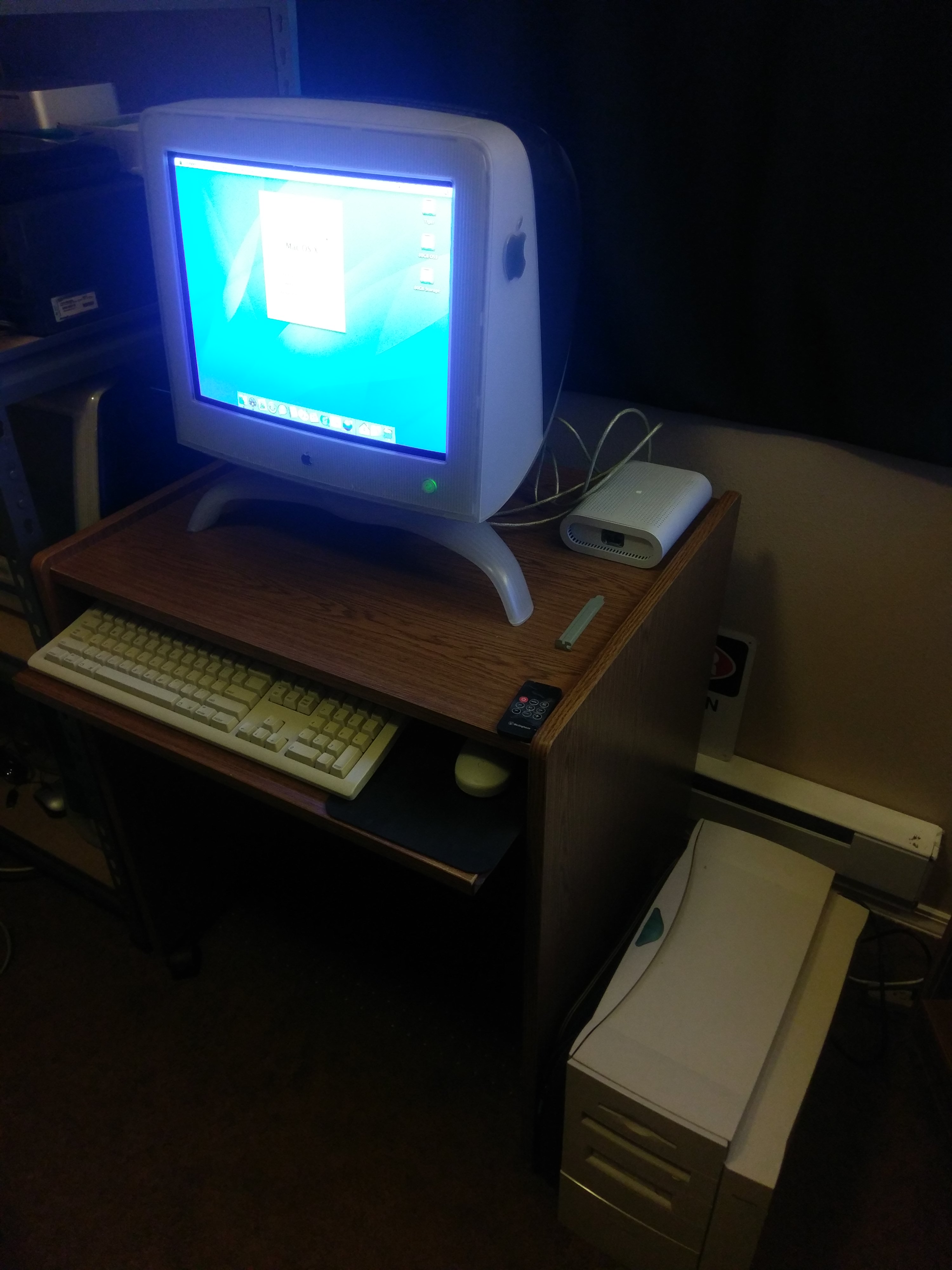

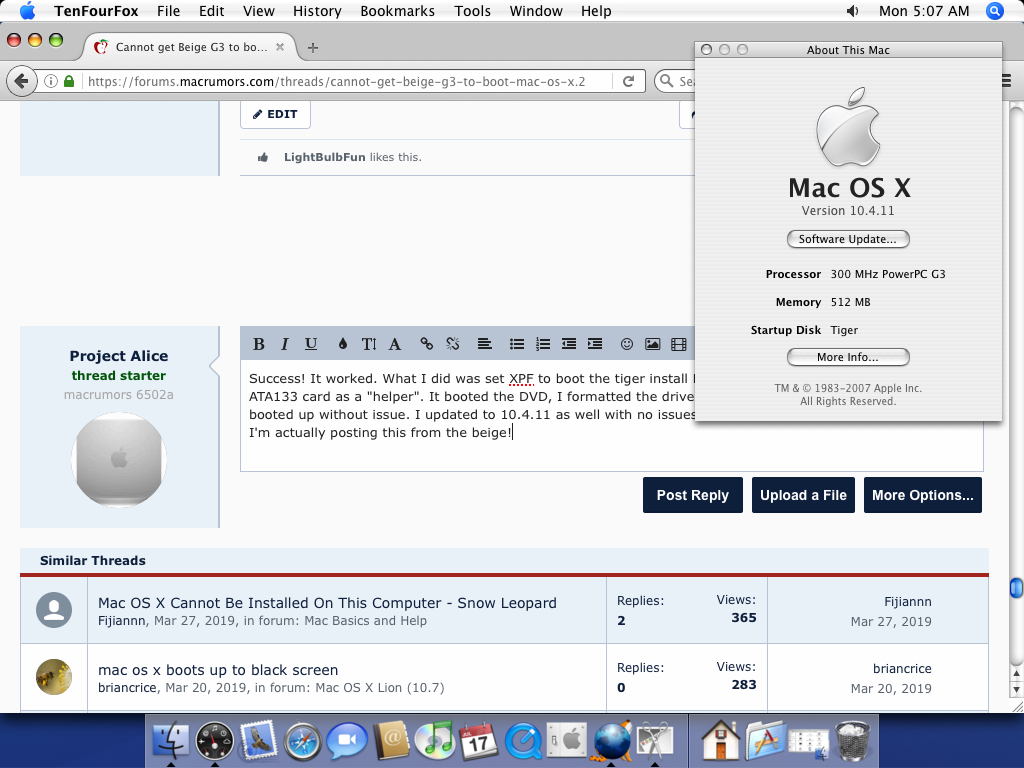

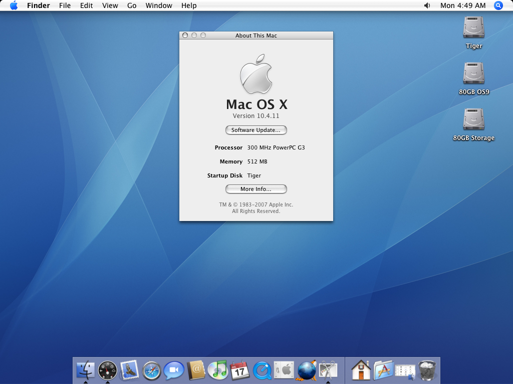

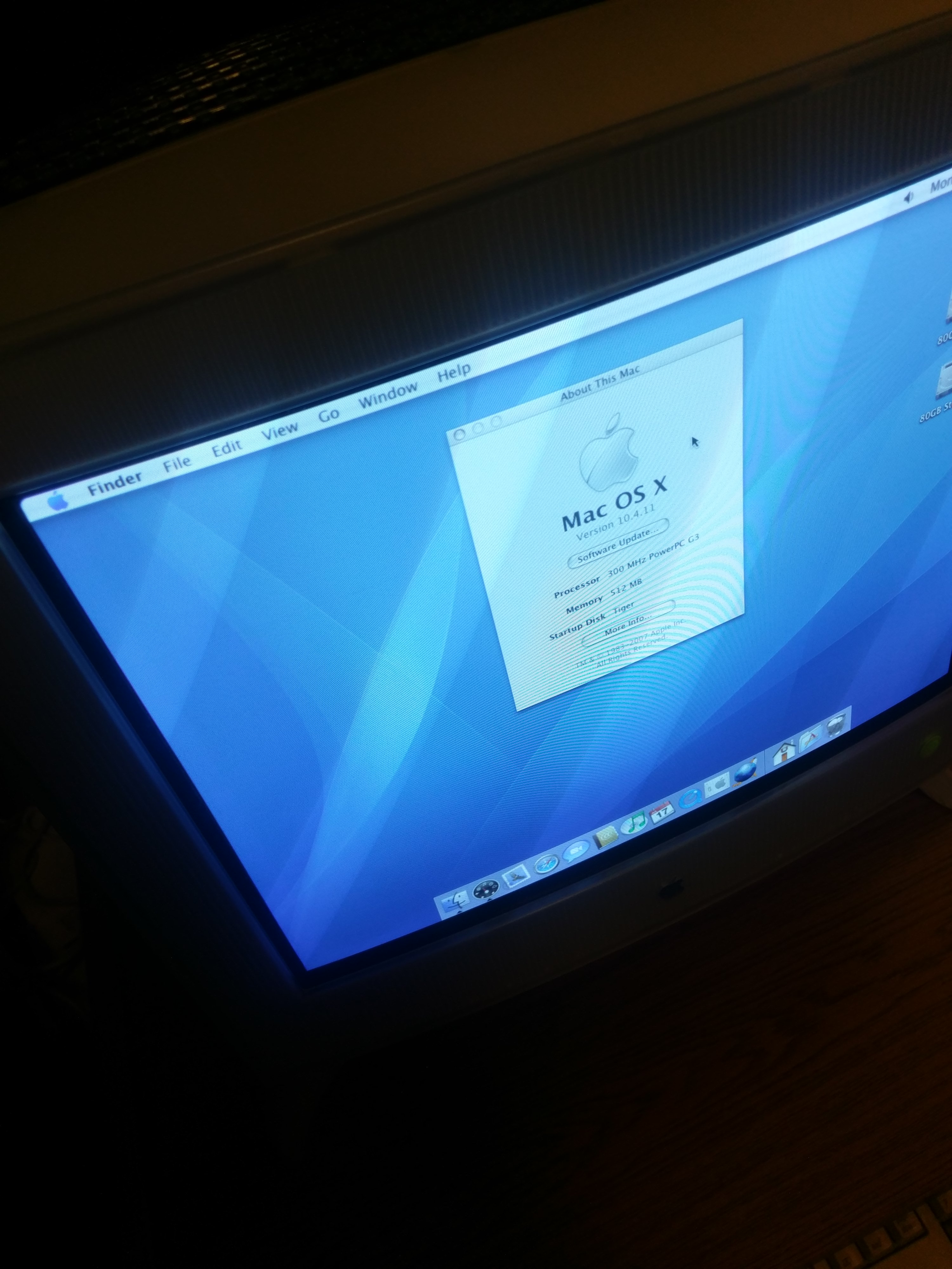

Success! It worked. What I did was set XPF to boot the tiger install DVD by using the drive connected to the ATA133 card as a "helper". It booted the DVD, I formatted the drive with a single partition and installed. It booted up without issue. I updated to 10.4.11 as well with no issues.
I'm actually posting this from the beige!

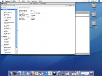

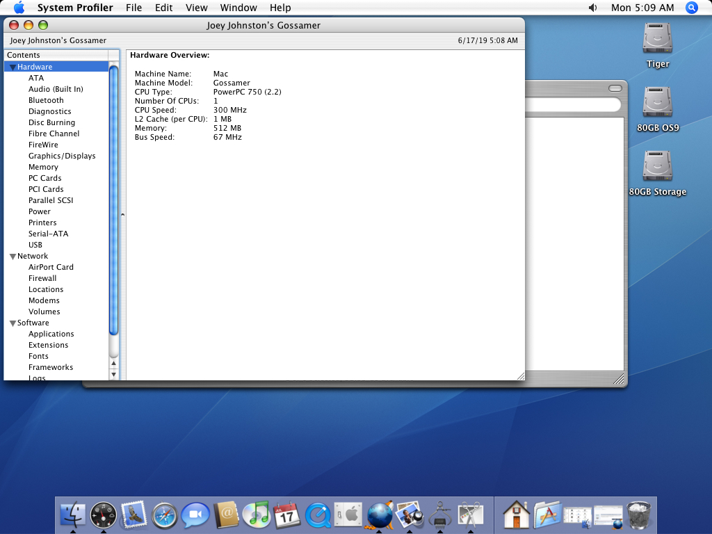

Also, what is "Gossamer" that shows up under System Profiler? I assume it's a code name for this mac?
Reactions: LightBulbFun
very cool stuff happy to see you were able to get it working in the end 🙂
the Gossamer thing, is the G3 Beiges Open Firmware name, while on NWR macs this was meant to be a user visiblething, it was not really meant to be a user visible thing on OWR Macs, hence why its its something "weird", indeed Gossamer is a code name 🙂
(specifically its AAPL,Gossamer however system profiler automatically lops off the APPL,)
To answer all of the basic questions so none of you have to ask:
Yes I am installing to a partition under 8GBs (7.4 to be exact). Partitioned with Drive Setup under OS 9.
Yes I am positive it has a DVD drive, I installed it myself and tested it with a movie.
Yes I checked all the jumpers on both the HDD and ODD. Both are Master on their respective controllers.
Xpostfacto is configured properly - this shouldn't have anything to do with the Jaguar problem, though.
My goal is a dualboot of Tiger, and OS 9. I was only installing Jag to see if it made a difference to upgrade to Tiger instead, that's when I found out Jaguar wouldn't work either.
I appreciate all the help I can get with this, I'm stumped!
Early G3s with Revision A ROMs (and by the way this is an Old World ROM) don't support slave drives on their IDE controllers, these ones have the Rage II+ video card. Ones with Revision B and C ROMs support slave drives on their IDE controllers, with these ones having the Rage Pro (B) or Rage Pro Turbo (C) ROMs.
So, what is your video card?
I've never had any luck getting a slave drive to work on the main(HDD) ATT bus of one regardless of the revision.
This is why bootable ATA cards are very, very valuable. They get around all the quirks of the built-in controller, including requiring OS X to be on the first partition that is no larger than 8gb in size, and the 128gb drive size cap.
