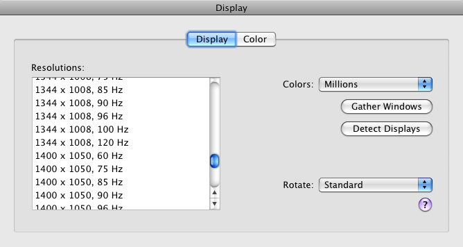

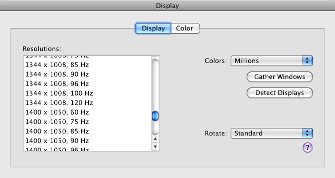

Also not available. The resolution my TV is calling for (and the one you suggested) just simply aren't available 🙁 (even though every other resolution ever imagined is)
That 1344x1008, is absolutely bizarre...at least it calculates out to a 4:3 ratio ("square" TV ratio)
One last one I just thought of, is 1600x900 there? Heh, this is crazy. One other thing, is your VGA cable missing 1 pin? A lot of cables lack one pin, I'm not sure what it does, but if you can find with WITH that pin, maybe that will help the MB detect the TV better?
I'm at a total loss right now.
Edit: What model TV is this that we're working with? Also, what model Macbook (which graphics chip more importantly perhaps, GMA 950 vs x3100 for a plastic MB)?
Interesting. I've hooked my SR MacBook up to two different LCD FHDTVs and both TVs were recognized by the computer and indicated at the top of the display control panel the model of the TV (where your pic says "Display" at the top of the window, mine would say "VO32L FHDTV 10A".
This is true for both VGA connection as well as DVI --> HDMI connection. I don't think I had all of those whacky resolutions, though.
Have you tried selecting the "Detect Displays" button again? You might try having the TV connected, putting the MacBook to sleep, then waking it up. Sometimes computers don't want to fully recognize displays just by plugging them in. Sometimes you need to reboot or come out of stand-by/sleep.
It may also be that the MacBook just won't correctly recognize the TV. I've run into some monitors where my MacBook wouldn't identify the model of the monitor and I wasn't able to select the native resolution of the LCD. And that was booted into OS X or XP -- either way, no native resolution.
Also unique that there are so many frequencies listed. When I connect my MacBook to my TV, all I get is 60Hz. I like the idea above about checking the VGA cable. That sounds like a winner to me.
There is a tool called SwitchResX which allows you to create custom resolutions, but I haven't used it so can't speak to its efficacy.
Good luck!
