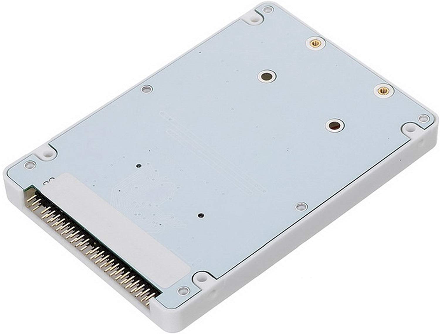

I'm trying to set up my PowerBook 17 with an SSD. This computer is from the pre-SATA era so it expects parallel ATA internal drive.
So I acquired this adapter, specifically for housing a mini SATA SSD and providing the connections for an old-fashioned ATA environment:
Looks just like the one in the original post for this thread, up above, doesn't it?

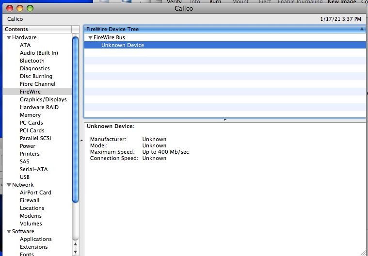

a) The PowerBook doesn't mount it as a volume; Disk Utility doesn't see it as a drive. System Profiler sees there's an "Unknown Device". MacOS 10.5 PPC.

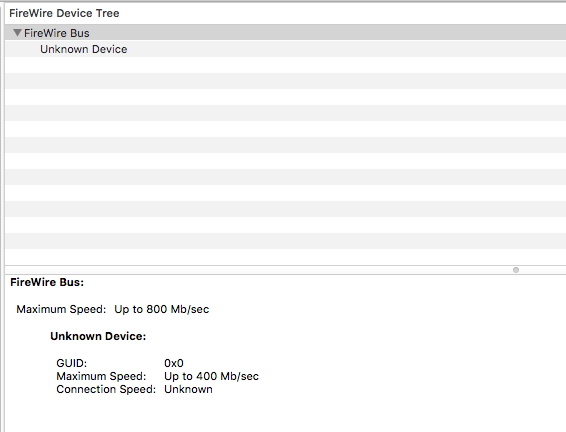

So then I take the same enclosure to my more modern MacBook Pro which has FireWire 800. Plug it in via a 400-to-800 cable. Again, doesn't mount and Disk Utility doesn't see it as a worthwhile target for formatting. System Report (MacOS 10.11.6) sees it as an "Unknown Device" but at least recognizes it as having a GUID formatted storage device of some sort.
What are my next steps?

Can you check if the Mercury enclosure works at all, ie with a PATA drive? Just in case.
And even though your adapter looks the same as the OP's on the outside, it may have a different converter inside that might be incompatible or quirky and causing these issues. Adapters with green PCBs are known (around here) to possibly be less reliable.
The Delock 62495 adapter, for example, is a little on the expensive side but known to work. It has a striking red PCB inside.

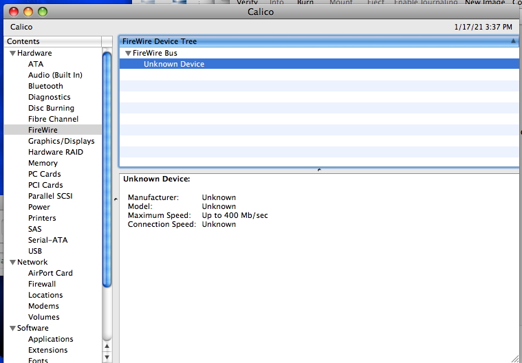

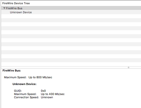

I have a 128GB Zheino mSATA in my 17" PowerBook so I highly doubt it's your SSD. It could be, but unlikely.
I am way more suspect of the adapter you got. A lot of people here have had success with this but so far my experience has been that these are cheapo garbage. Spend a few $$ to get a decent adapter and you won't regret it. There's one mentioned farther up in this thread.
