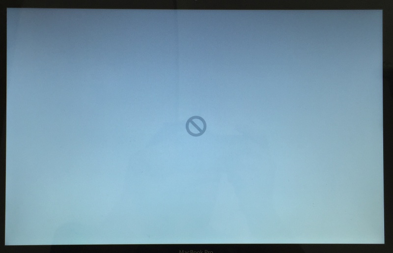

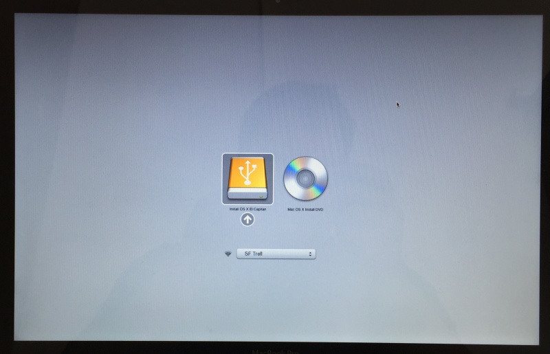

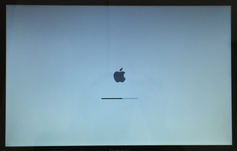

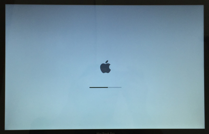

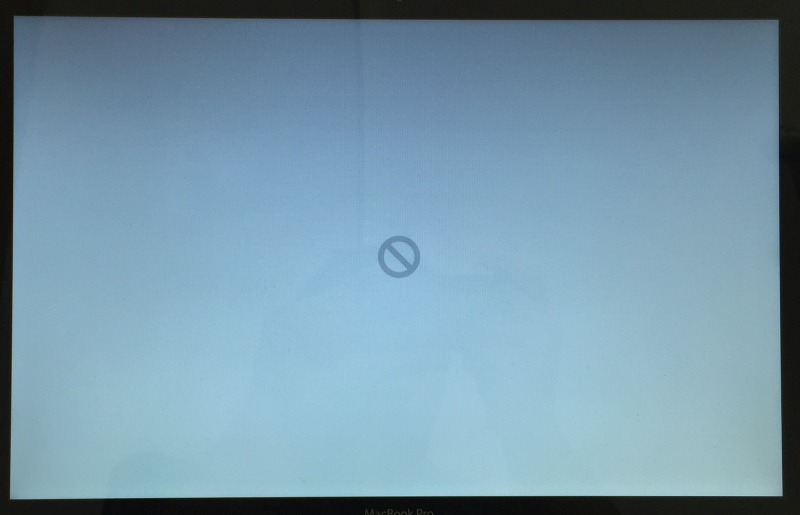

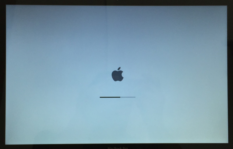

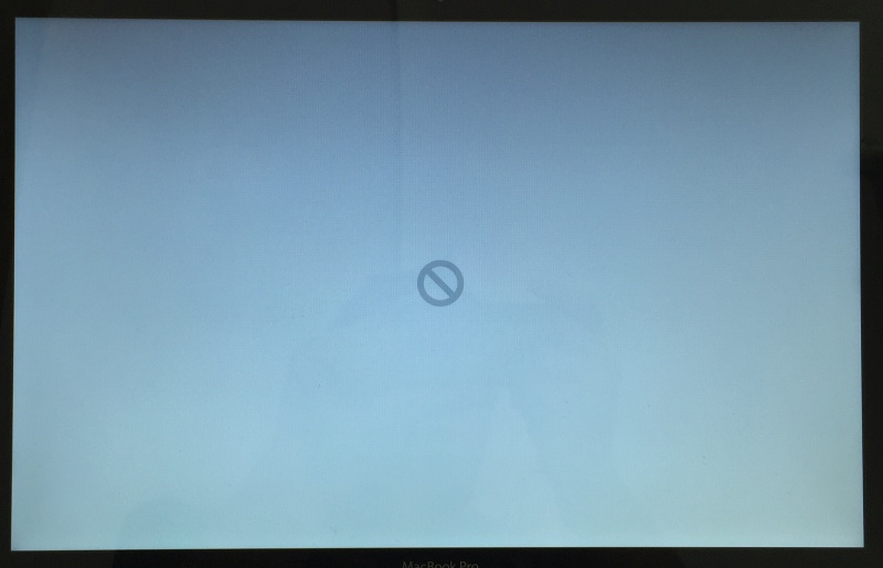

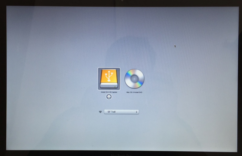

Hello,
I'm having a problem with installation of any OS X on my MacBook Pro mid-2010. I have switched from HDD to SSD and performed clean install of OS X 10.11. Few days later i switched to bigger SSD and was planing to repeat the installation. But the Mac is stuck after 2 minutes at booting to installer itself. I have tried with El Capitan (USB) and with original DVD with Snow Leopard. I have also tried with different SDD and previous HDD. No luck. Hardware failure? I'm attaching the photos describing the situation. What should i do?
PS I hope this post is in the right section of the forum - it's my first thread here.

If you put the old HDD back in, will it boot?
If it does, hold CMD+R on startup to boot into OS X Utilities. Plug in your SSD via SATA dock/USB. Format SSD through Disk Utility and select 'Reinstall OS X', then point it to the SSD. Once OS X is installed on that, swap the two drives back over, and it'll be up and running.
If the system will not boot with the old HDD in (assuming the old HDD was working before, and you haven't formatted it or anything), there has to be a hardware failure somewhere.
As for the moment it does not boot from old HDD. This would clearly point to some hardware issue but...
The old HDD is pretty much broken. I changed it at its very last breath, because it kept failing to boot more and more often. Now when i connect it to other Mac via SATA-USB adapter, it is visible but hardly accessible (very slow access occasionally).
From other similar topics i am thinking that the SATA flex cable inside the MacBook may be broken. But it doesn't show any visible damage. Can it be cracked anyway?

Ok, installation is ridiculously slow. Progress bar at 1/3, 7 hours to go and going up. Gonna leave it overnight. Anyway, it's not an internal flex cable. Macbook is booting from this one particular HDD without problem. But the fresh installation still fails.
