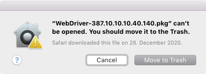

So i tried to reinstall the drivers. But everytime i doubleclick the package i get this error:

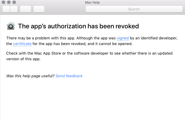

And by clicking the questionmark, this note shows up:
Is there any solution for this or is installing NV-webdrivers just not possible anymore. Not even for High Sierra.
Thanks in advance for any help

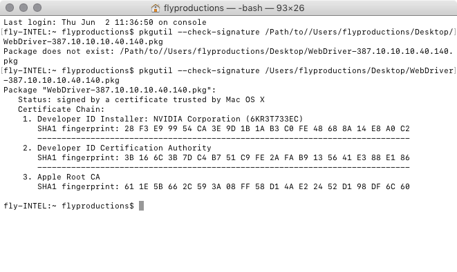

It would be curious to see what the instructions here reveal:
Reactions: Ashok.Vardhan

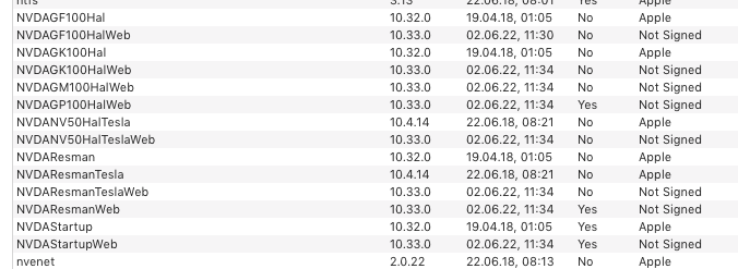

I tried but sadly with no success. Went trough the whole stripcodesign-process for every single of the webdrivers kexts. And reinstalled them. Afterwards they show up as "unsigned" as expected but still refuse to load.

Update with partial success!

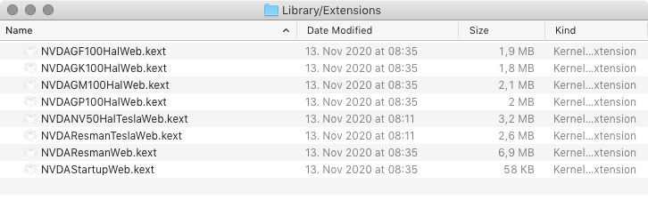

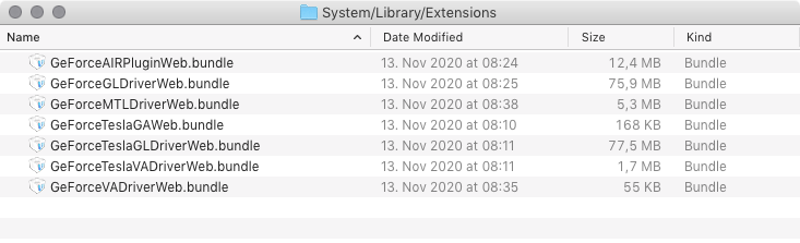

I just missed to patch "some" of the neccessary kexts and bundles. Now, after treating all of the following extensions in
Library/Extensions...
...as well as System/Library/Extensions...
...the way described in this video at least the GUI-lagging is gone, wich renders the machine at least basically usable again.
I still cannot open the driver manager even with all the apps inside the package also "unsigned". And GPU benchmarks like the Unigine apps still don't run. So there seem to be parts of the package still missing. But in all, unsigning in the way you suggested seems to be the way to solve this. Thanks again!
