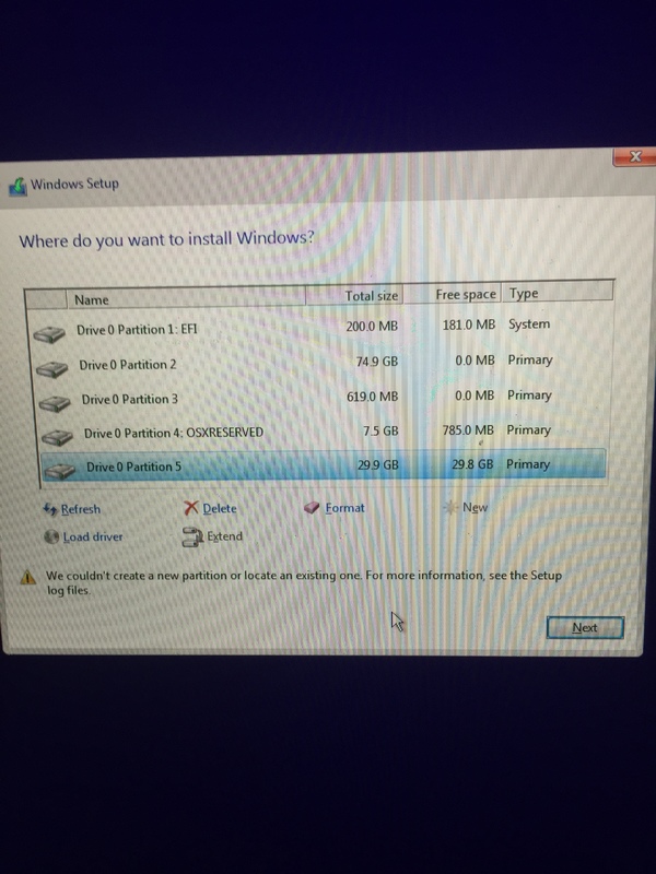

I come unstuck when selecting the partition, please see the error below. I did click format too.

Did you format the partition intended for windows as NTFS? Bootcamp creates a FAT partition but Windows needs NTFS
What is the "OSXRESERVED" partition that is only 7.5GB?
Which partition is the one that you want to use for Windows?
How much space did you want to use for your Windows partition?
Did you use the Boot Camp assistant to create that partition?
I did what was prompted by boot camp by following the instructions on the apple site.
It asked you to choose a size of the partition, point it towards the location of the image and thats it.
It then downloads some more 'stuff' for windows then you get to the image I posted.
Thanks.

No idea.
I can only presume BOOTCAMP is the partition that bootcamp created.
Yes i want use OS X but I need windows for a few things and I only want 1 computer in the house.
Thanks.
Try formatting the BOOTCAMP partition to NTFS and then continue on in the windows installation process.
Like I said, Bootcamp only formats it to FAT, but Windows requires NTFS, if you didn't reformat the drive to NTFS, windows will not install.

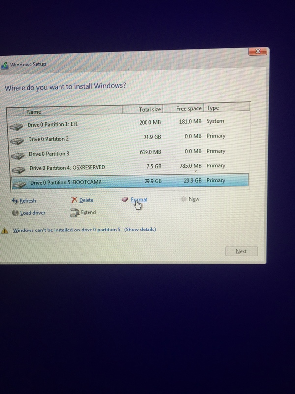

Ok, now I can get to the stage in the picture in my first posts.
I selected the BOOTCAMP partition, pressed format and off it went. (I have tried this before)
Then it said it couldn't continue and asked me to restart, which I did.
Now I have this everytime I re boot.

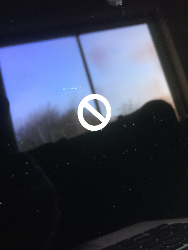

2 choices, 'untitled' and 'Windows
Windows says it will restart due to a problem.
Untitled is the black screen.

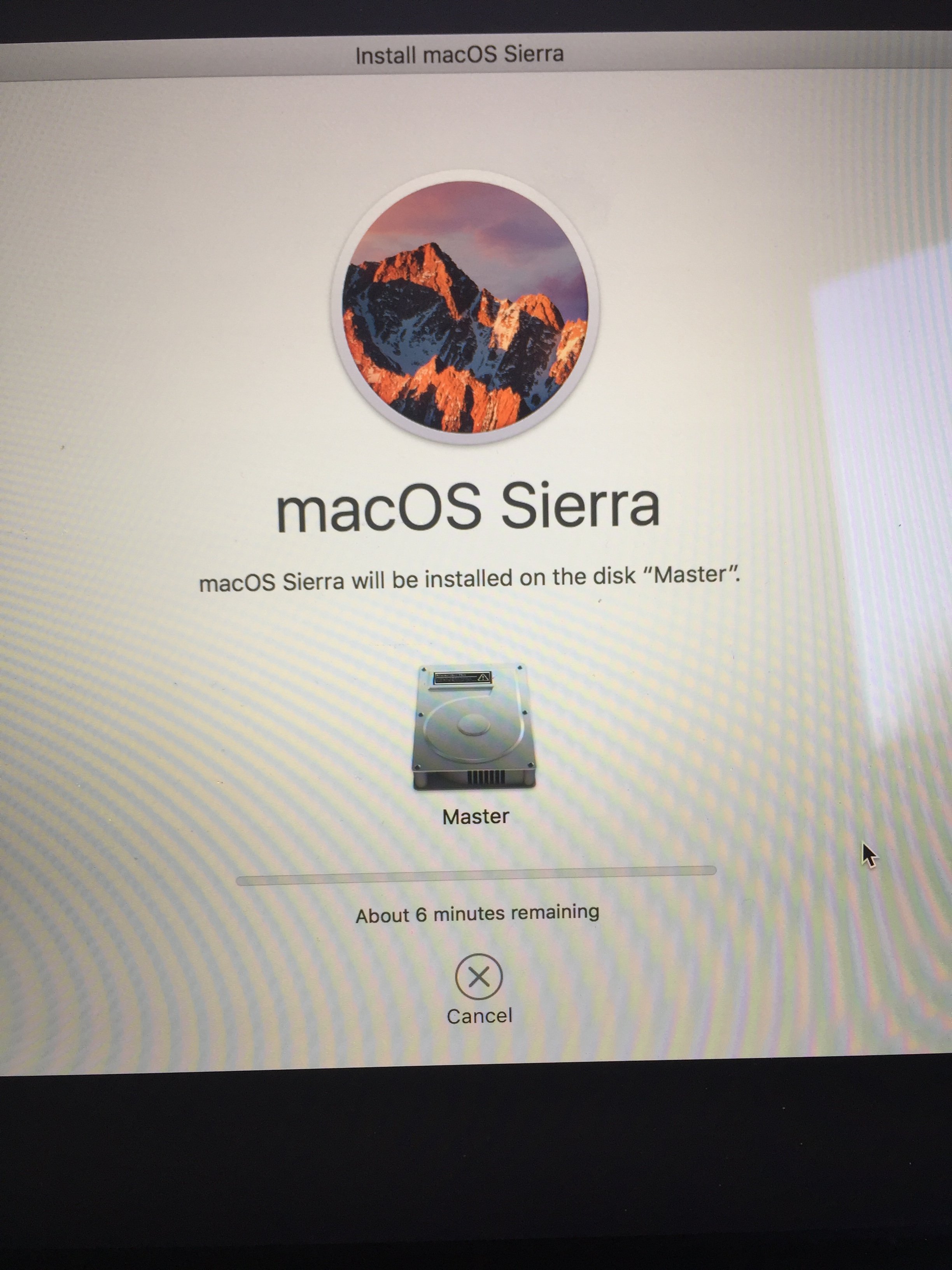

[doublepost=1483107026][/doublepost]Right,
Step 1.
Reinstall the OS
Will do.
I cannot do any damage can I like completely wiping the core brains of it?
Step 1.
Reinstall the OS
Will do.
Step 1.
Reinstall the OS

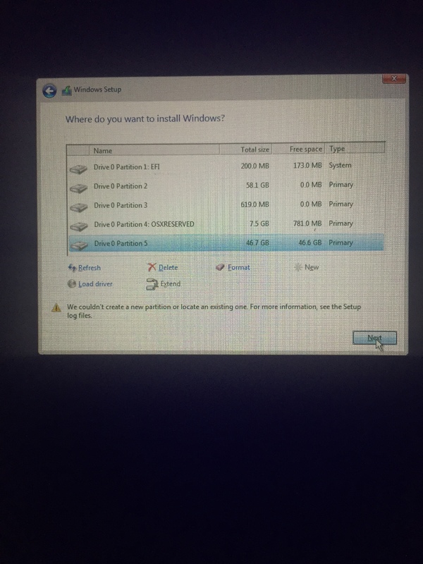

I ran boot camp and got to this stage.
windows 7 print screen
So I formatted boot camp
upload pictures online
Now it's not called BOOTCAMP and I get the above error.
Still would like to know what that OSXRESERVED partition is.
I'm thinking that you have too many partitions on your hard drive, more than the Windows installer will allow.
The OSXRESERVED partition may be the problem.
If you boot to OS X, then run your Boot Camp assistant, will it let you remove the boot camp partition?
If it will not let you remove the boot camp partition, you will likely need to reformat your hard drive and reinstall OS X (start over from scratch)
Reactions: LeeH22

No, BOOTCAMP is very simple. It asks you to choose the partition size and select the location of the ISO. That's it!
I have done 4 complete formats and re installations today! Everytime BOOTCAMP puts the same 5 partitions back.
Anyhow, I know what it is.
You have to remove the flash drive after reformatting the BOOTCAMP partition and pressing next.
