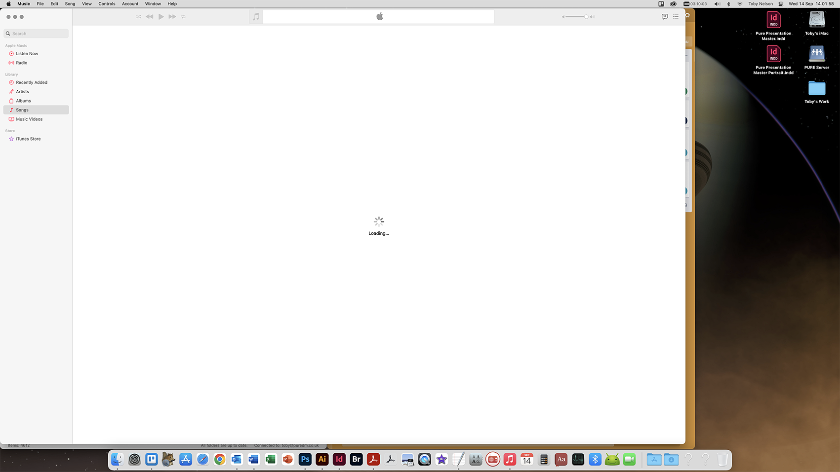

So, I've been using iTunes as my main music library on my PC for over a decade now, and I've been periodically backing it up to an external hard drive, and then copying it to my iMac and opening it up there with all my playlists, play counts etc intact for all that time without a hitch, using iTunes on Mac and the later 'music' iteration of the app.
Doing my backup as normal today and when I option-open the music app on the iMac to point it at the .itl library file music just sticks on 'loading' forever and nothing happens. Before, upon reading said file it would immediately open my library fully intact and away I went.
I've tried deleting the library and re-copying it from the hard drive, making changes to the master library on the PC so it overwrites the .it file, then copying it back to the Mac, and nothing, the same thing happens. I can't seem to find anything online about the music app suddenly not being able to read this critical file, has anyone any ideas? I've never had this problem before.

I use the windows PC as my master library so It's portable, I back it up to a hard drive, then copy it to my iMac, so I can listen to music whilst I work, and it serves as a further backup. The music app simply will not read the .itl file any more it just says 'loading' - left it for hours too. It used to read the library file straight away and open up my music library with all the play counts, ratings and playlists intact.
It's also worth noting that the app will also not read any of the .itl files in the 'Previous iTunes Libraries' folder either. Surely this points to something that's broken on the music app. Is there a way to uninstall it or reset it somehow?
This is all I keep getting when I try to select any library file

So as an update to this in case anyone else has this issue. A kind soul over at Apple Support Communities has sorted this issue for me. The problem is Mac OS Monterey not converting the .itl file to a music database file. I emailed him my .itl file and he converted it using a machine on Big Sur or Catalina then emailed it back to me and I pointed the music app at it and hey presto it worked, all I had to do was point the music app to the media library in preferences once it had opened with my playlists etc (as all the files were listed but missing) and it seems to be ok.

The latest Monterey update has a bug that stops it from converting the windows iTunes .itl file to a .musiclibrary file. This causes the music app to hang indefinitely and not load the library.
I have had to get someone using the previous OS (Big Sur/Catalina) to use the music app to convert this file to the .musiclibrary format (as all our machines are on Monterey). This has worked and the problem has been resolved.
