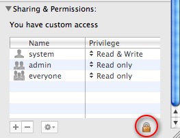

The "Item" you are attempting to delete may be locked...
Try to right click the item "Apple/CMD" click - A window should pop up then select "Get Info" another window should pop up... at the bottom of this window should be a little lock icon... If it is locked try to unlock it (You may require your System Administrator Password to do this. Once this is all done try clearing the trash again.
If you're referring to the padlock icon at the bottom of the "Get Info" screen, that only gives you access to the Sharing & Permissions settings.
That icon does not indicate that a file is locked, and it's not the way to unlock a locked file. If all you do is click the icon and enter your admin password, you have accomplished nothing.
