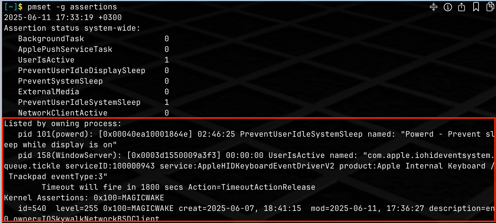

You can see all processes that are keeping system awake. In this example we can see powerd (reason - display is on), WindowServer (user input activity) and network activity by kernel assertion. These are normal when system is in use.
One of worst offenders for me has been coreaudiod, which is often invoked by playing media or web browser (by some media in some webpage). If it is web browser then usually I have been able to solve it by quittting the browser session or tab with offending webpage.
One of worst offenders for me has been coreaudiod, which is often invoked by playing media or web browser (by some media in some webpage). If it is web browser then usually I have been able to solve it by quittting the broser session or tab with offending webpage.

That network assertion is related to "Wake for network access" setting and disappears if that setting is disabled. Presence of that assertion does not however mean that system cannot sleep. It is there to wake system up to be able to access network even while asleep ("powernap"). Same goes for user input monitoring, so you can wake computer up from keyboard or mouse and sleep is prevented when computer is actually used.
Actual problems can arise from other assertions which were not present in this example.
