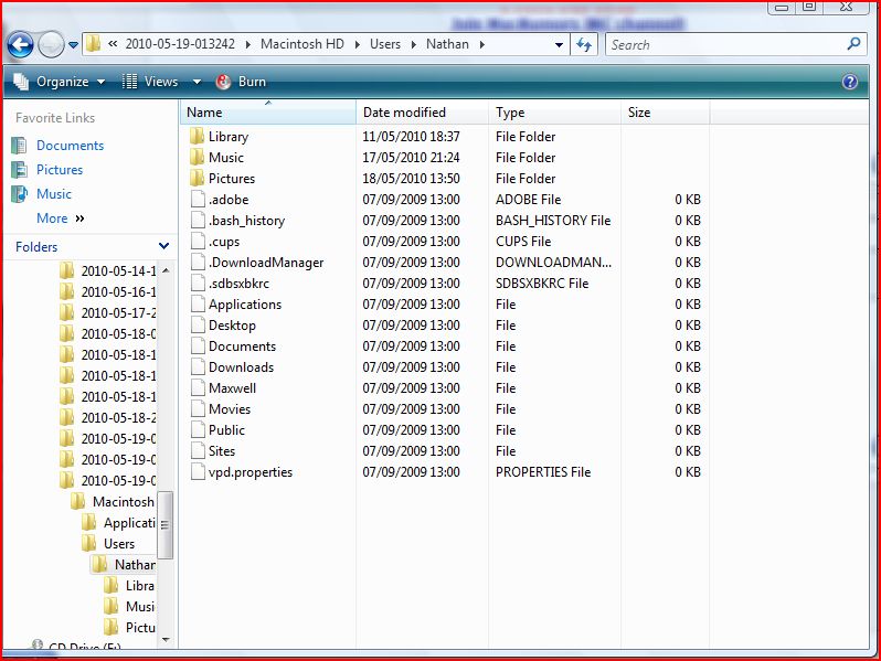

I need to open some documents on a PC from an external hard drive that I use for Time Machine. I've downloaded Macdrive and I can now see the external HDD but when I look in the backups, the files are just blank files ?
I really need to open the documents folder but it's not there !!!!! HELP

Your documents etc are stored in your user's folder so open users, select your user and open documents folder
Done that... see attatched as it shows the path.

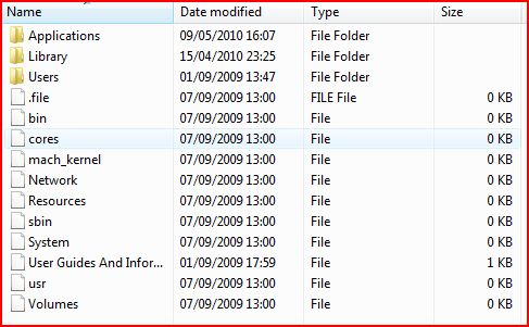

My Mac is not with me, it's been sent of for reapir as it's becoming slow, crashing and exceeding 105 degrees celcius. It was collected from me today...
The vista PC shows that the external HDD has a lot of content ( 300GB of backups )
