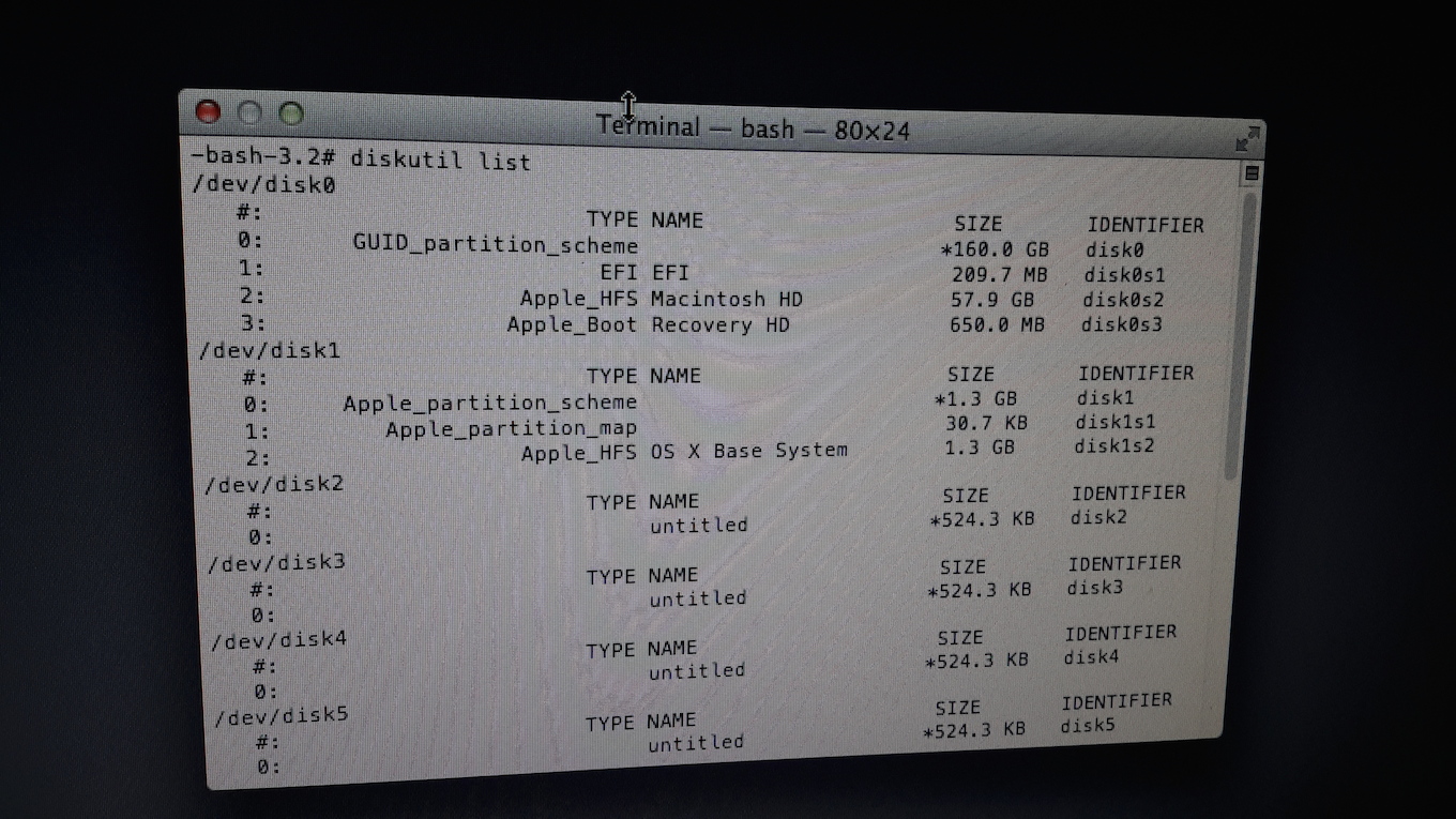

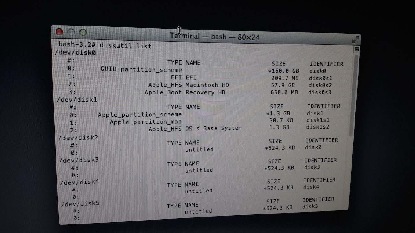

Enter "diskutil list" (without the quotes) in Terminal and tell me what it says.
Here's what the command says
It's the partition that has the size of 57 GB I'm trying to alter...

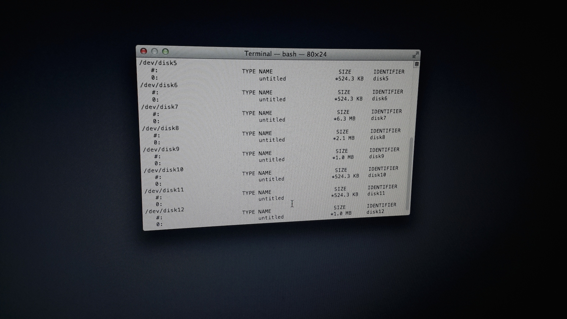

See all those other disk5 disk6 things on there... that is concerning and sometimes means a bad drive, or less commonly a bard drive cable.
