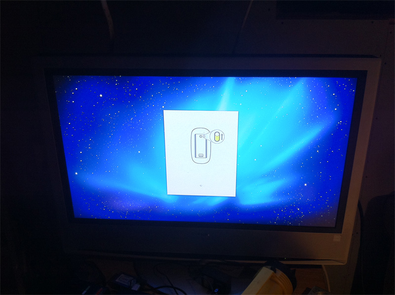

Here is the picture I'm getting exactly every second reboot - what would that mean?
Its telling you to turn your magic mouse on. I got this the first time I started up a Mac Mini, even though I had a USB mouse connected. After several seconds it was fine.

After visiting Genius Bar at Apple store unit has been declared defective and ordered to send back to Apple.
Hope to have it back in a week - 10 days. 🙂
You are in the same place I was 3 weeks ago, lol. I didn't have a Magic Mouse but had the Apple Wireless Trackpad but since 10.6.3 doesn't recognize the trackpad (at least until you install it) I couldn't get past that screen either. I had to go buy a wireless mouse ($20 Dynex one) just to be able to get setup to run.
Hmm.. Interesting.. Why did not you use any generic mouse? It should work.
And - folks at Genius Bar tried to install using apple's mouse and keyboard and could not..
But this is valuable info. Thank you very much
Received new unit. Installation was a breeze, so the previous unit indeed was defective.
