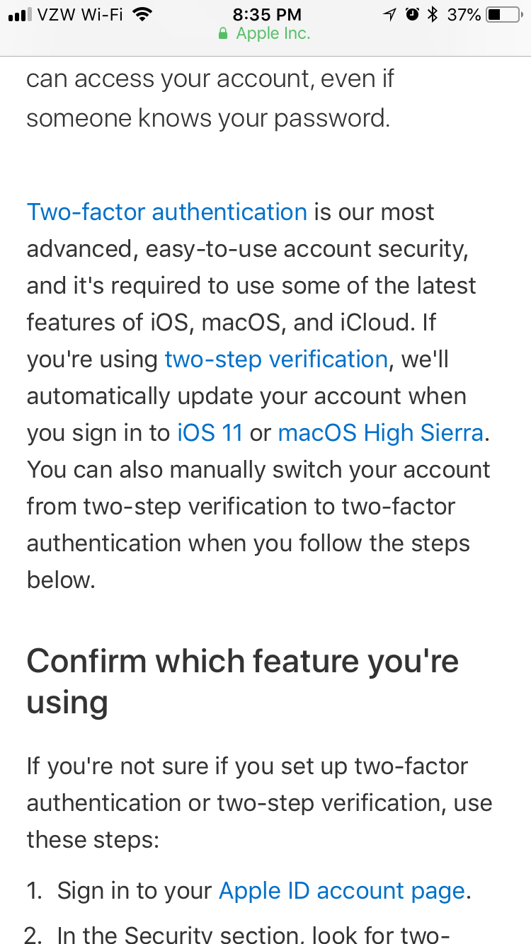

I was just going by this
Found here
https://support.apple.com/en-us/HT207198
I skimmed it and already had it on so I didn’t research it much. I guess it means new device log in?
