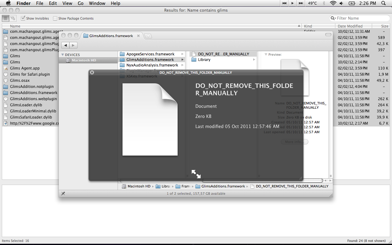

Removing Glims manually isn't recommended apparently. OP, try re-applying the Glims installer, then use the provided uninstaller.
Regardless of what the folder is named, it's perfectly safe to remove it manually. I have successfully uninstalled glims using the manual method, with no problems at all. There's something else affecting the OP's situation.
hey well the genius couldn't figure out why it was doing this either. tried to set up a separate safari folder, and also tried to re-install safari but no luck. Had to re-install Lion OS X.
There was definitely something strange going on if you couldn't manually delete all the necessary files. Glad you got it resolved, though!
I was simply pointing out the developer's specific block capital instructions not to do so. So you experienced no obvious adverse side effects - fair enough. But they still put that file there for a reason.
