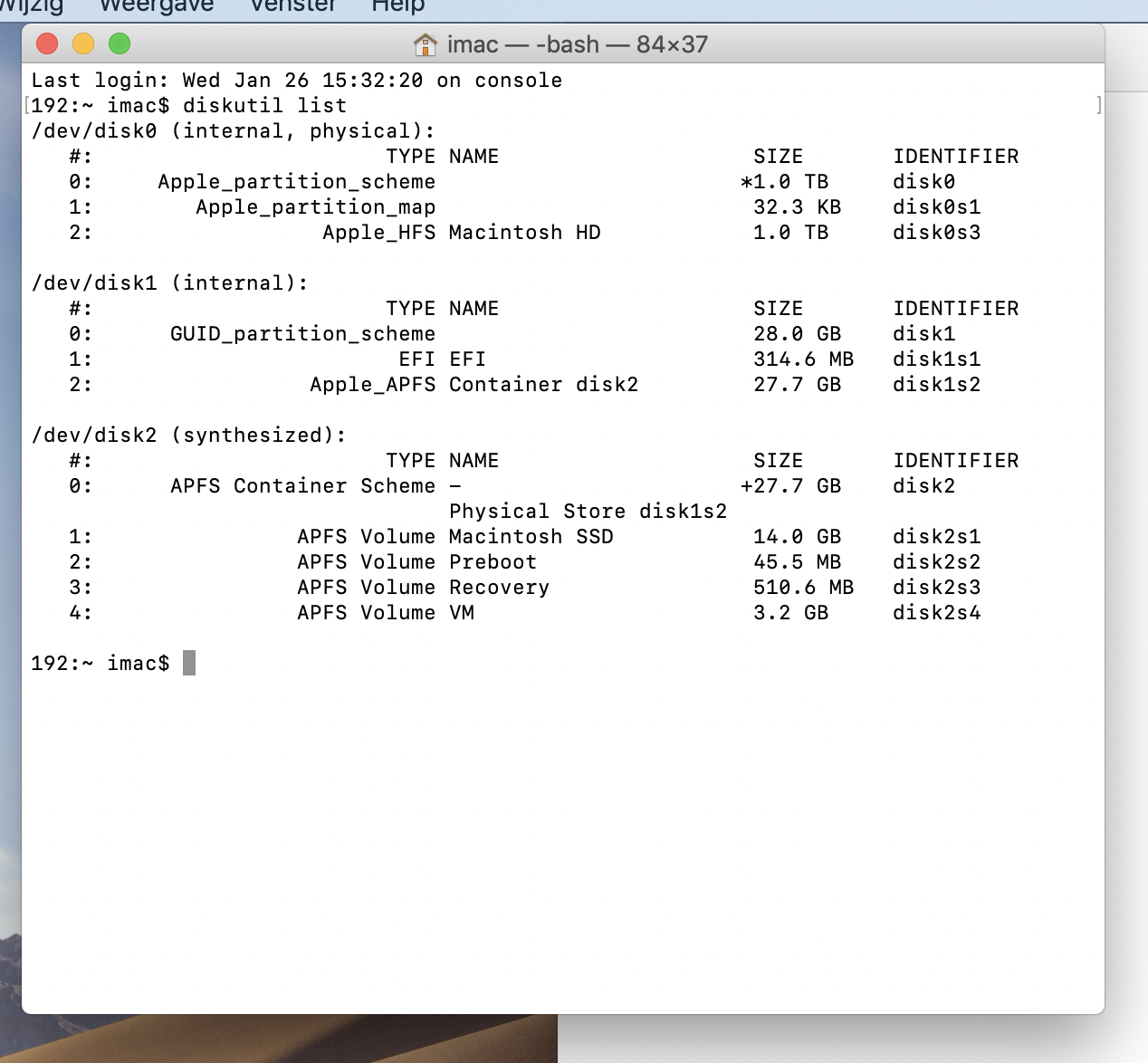

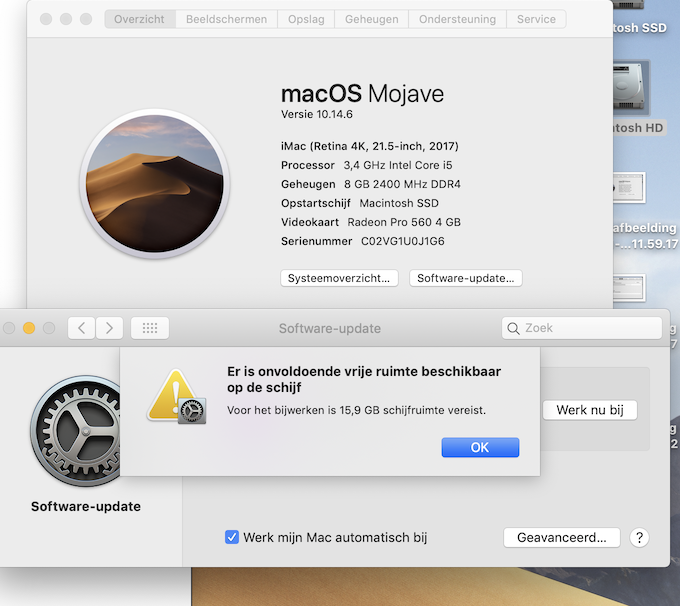

I bought this new 2nd hand iMac with Mojave installed. When I try to update to Monterey there's not "enough space on the disk" available.

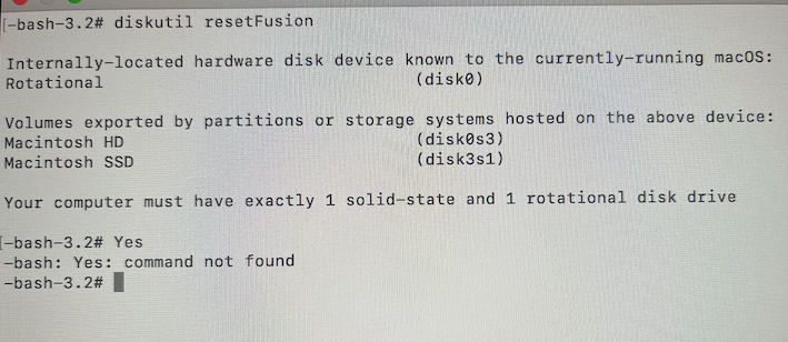

Usually I have the installer in an external USB, and when I run from the USB I go to terminal and do the resetfusion command

I would suggest to put the installer in an USB drive, boot from that drive and from there you can erase all the partitions from both disks, or you can also re-do the fusion drive and it will erase everything for you, then you can install

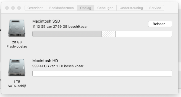

But there is no space on the SSD for updating.
15,9 GB needed for update.
Why don't you
- create a bootable installer https://support.apple.com/en-us/HT201372
- move your data from Macintosh SSD to Macintosh HD
- make a clean install of Monterey on Macintosh SSD (See “Use the bootable installer” in the link above)
