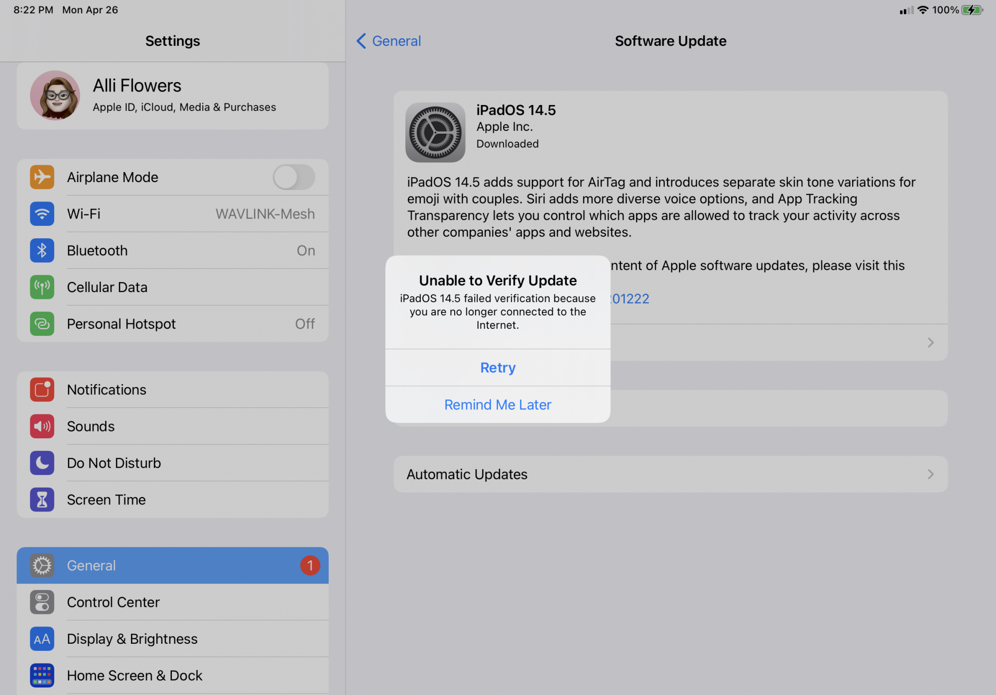

Except that I am on WiFi. This is only happening on my iPad. Phone, Mac, and Watch all updated no problem.
Anyone else seen this? As you can see from the icon in the upper right - full WiFi.

For me it could do the search for and find the update, but not download the update and everything else on the internet was working, WiFi only iPad so no fallback to cellular in play.
