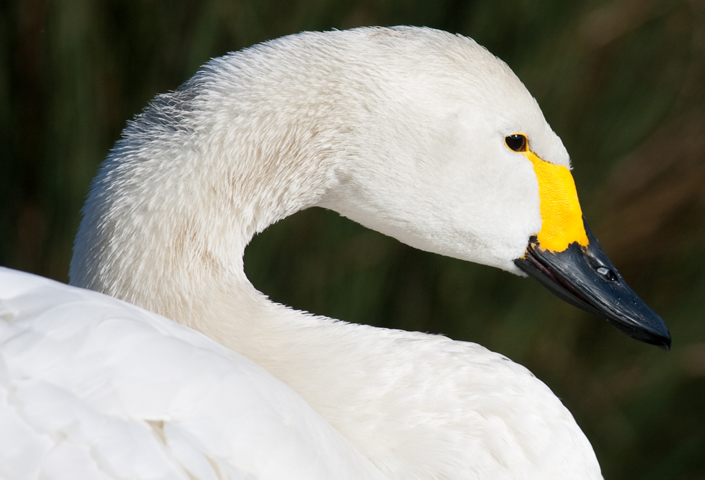

I think I'm a rarity of enjoying my lens wide open.
100% crop
But you need good light and a good eye for focus through the viewfinder.
You also need to be aware of how fine the DOF can be, which can easily mislead the unaware to beleive that the lens is soft wide open. I guess that some might be, but some slight movement, or mis-focusing can cause softness. Compare the softness of the eye against the sharpness on the bird's shoulder.
