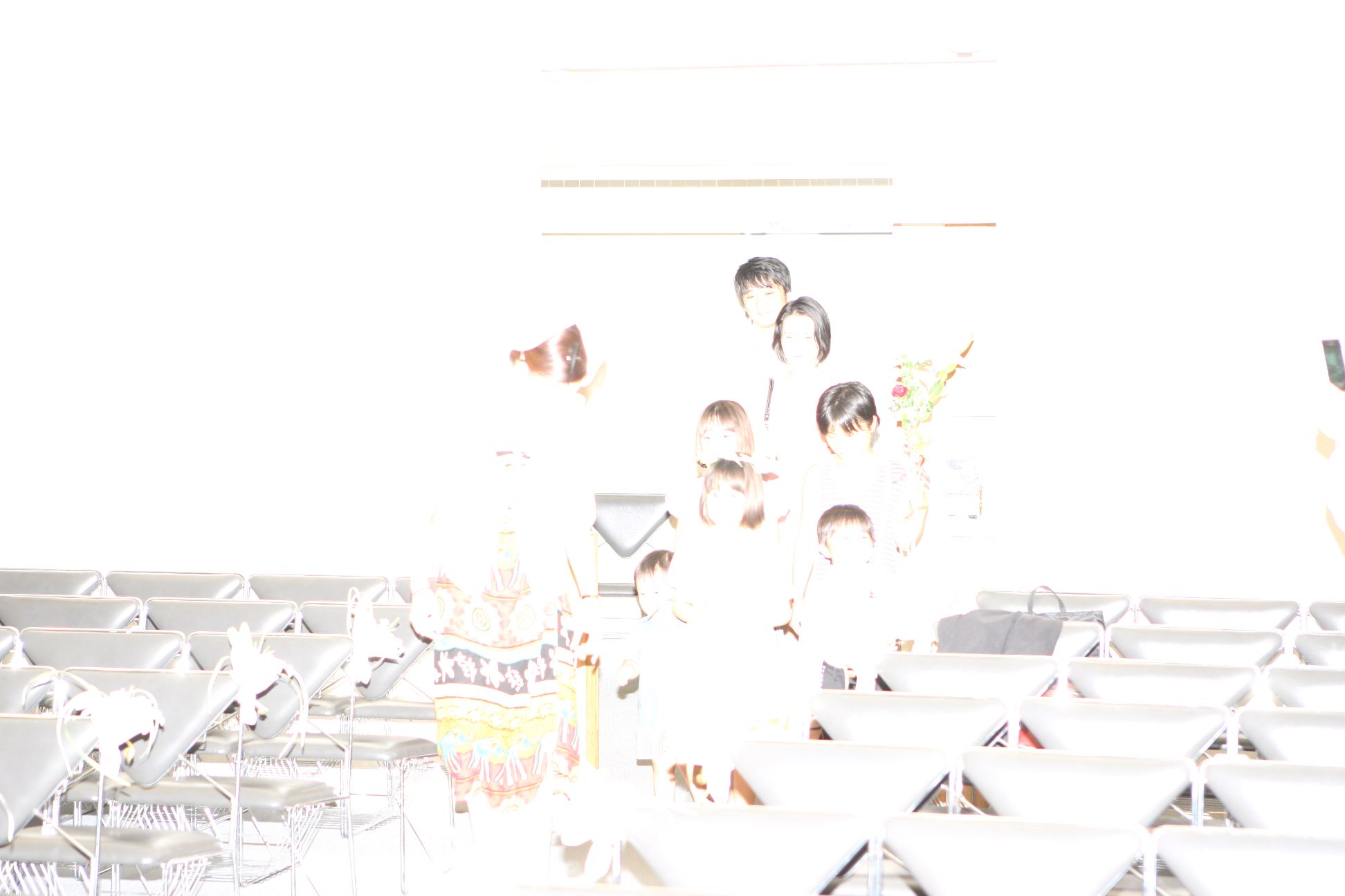

Thanks both for your reply; with respect to flash photography I kind of have to agree not having too much practice. I had in the past some good results with ambient light and fill-flash. This time not.
Attached one sample of a number of 5 consecutive imaged completly strange.
Something must caused the flash thinking to emit a huge amount of light. Before exposed ok; one after underexposed; after that went back to normal. A bit erratic to me; for sure not reliable.

Was this manual flash or ETTL?
This is horrific overexposure, suggesting either (a) you used manual flash at high power and didn't realize or (b) something is wrong with the Speedlite.
What was the ambient light exposure?
Unfortunately the copy of the image you've attached no longer contains the relevant EXIF data, but I think Edge's hunch may be correct.
