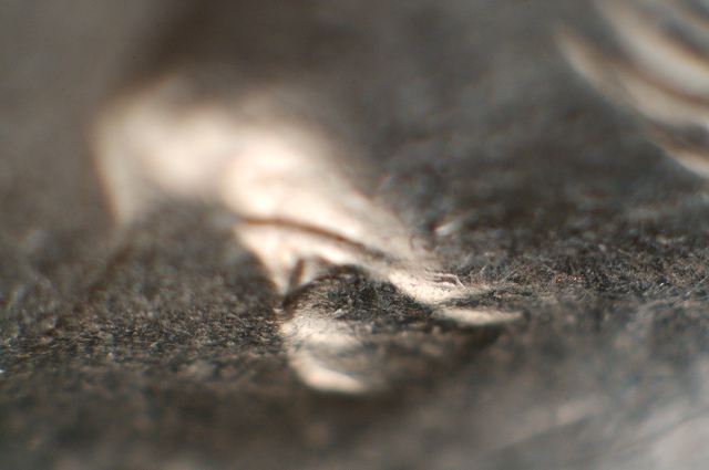

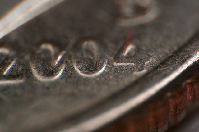

Nah, the physics of reverse-mounting are similar to what I described as the second way to make the image circle wider. So if a lens is reversed the "blow up factor" at the rear depend on the front focal length. So wide angle lenses make for more impressive reverse mount lenses. Because they are designed to take something huge like 100º angle and make it very small for the image sensor. So when you turn it around they make something very small, like a bug, into a much bigger object on the sensor. Hence with my 10-20mm lens at 10mm reversed I can fill the frame with subjects like these. They are the both on the head side of a US dime.
Oh, and the low DOF is because I don't have step down rings to mount this on my reverse mount, thus I hand held and its wide open. Oh and they are not cropped, thats full frame. Nothing has been tampered, RAW strait into Aperture and exported.
