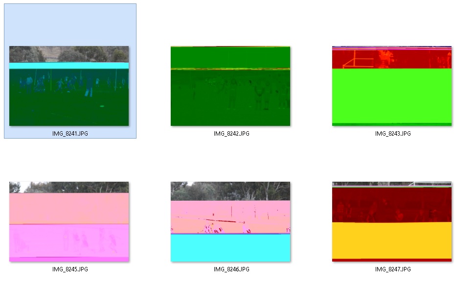

So, I have recently discovered an issue where by if I copy files directly off the SD card with it inserted into my computer that they are not right (see attached). If I copy them off the SD card with it in the camera, they are fine and can be viewed on the PC without any issues. I can live with that for now.
Recently I took some photos and not knowing about the above issue did a cut and paste onto my computer where I found I had this issue. Straight away I took an image of the SD card and have put it aside. I have restored the image to other SD cards to see if any of the recovery software can help me but they all have issues. Just to be clear they can all recover the files but this is with the SD card plugged into my computer which has the same issue as above. I can't find any software which will undelete the files on the SD card (which is different from recovering them to a different location). The other option would be software that can see the SD card while it is plugged into the camera. When I plug the camera into my computer I can see it as a device (not a drive) and I am yet to see any recovery software that can connect to it.
Not to confuse the issue but when I open the folder the files are in and change to view as icons they initially appear correctly but shortly after change as per the picture. About every 7th photo is fine and some are worse than others. The photos below are the worst ones.
Any help would be greatly appreciated.

The screenshot appears to show an Icon view in Finder.
Have you opened the images in an app like Preview, and confirmed whether the image itself matches the corrupted Finder icon?
I ask this because I think Finder might read a thumbnail from the iamge file, rather than the image itself, and it would be possible to have a damaged thumbnail with an intact image. Or the problem could be vice versa: intact thumbnail and damaged image.
How is the SD card formatted: FAT16, FAT32, ExFAT, etc.?
It should be possible to use any file-recovery software that works with the file-system format to recover data. This assumes that data is recoverable at all.

I see this issue on all computers I use, they are Win10 and 11.
The issue happens ion several cards with several card readers.
The image is the same when I open it in a photo viewer or editor.
I find that when I copy the files off the SD card with the card in my camera I dont have this issue.
Just to be clear about what Im trying to do, I am looking for software that can either
1. undelete the files directly on the SD card (not recovery them as this is not the same)
2. That can recover the files with the Sd card in my camera (this should replicate coping the files with the SD card in the camera which works).
The data is 100% recoverable, the issue is that when I do it with the card connected directly to my computer I end up with the same result.
I have tested coping the files with the SD card in the camera and this works with other cards that I took some test photos. The test photos have the same problem as per the attached picture if I connect the SD card directly to my computer and copy them. My issue is that the previous photos were cut and pasted and there for are no longer on the card as visible files. Hence I am look for option one or two to help recover the files.

Looks like I have found the issue, it appears that the later Windows operating systems cause the issue where the files are copied with the SD card in the computer. I went back to Windows 7 and installed Disk Drill and I was able to recover the files from my original SD card. They preview and view fine. If I move the card to a Windows 10 or 11 computer and use the same software they have to issue.
