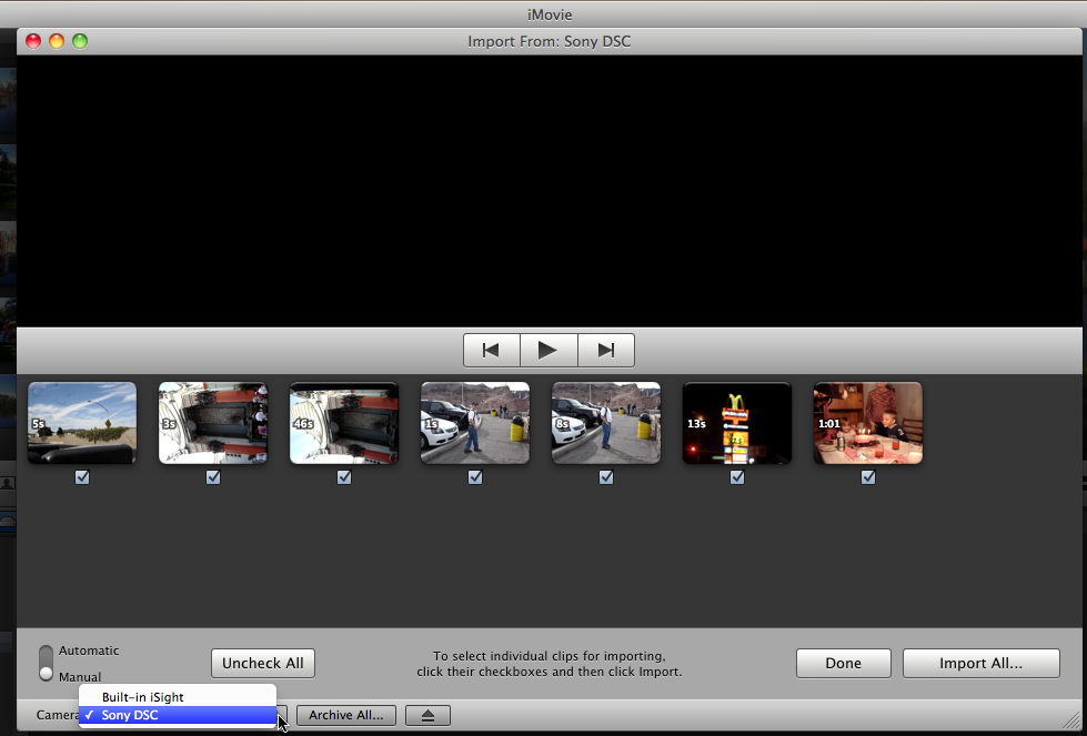

I'm not sure I understood what you just said. Here is a screen shot using my old point & shoot. It did take a while, less than a minute, for it to appear in the pop up list. I don't know if your camera would show up quicker.
Notice at the bottom where I've selected 'Sony DSC'. That is the popup I'm referring to. When I did that, all those thumbnails showed up. They are all checked marked for import, but you can check only the ones you are interested it.
Click on the image to see a bigger sharper image.
