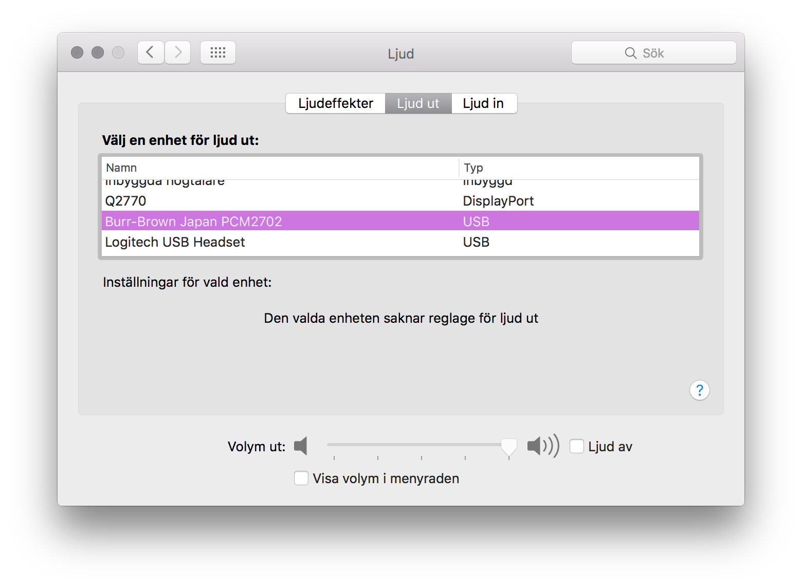

After upgrading to El Capitan I've lost the ability to adjust the volume of some of my connected speakers. Both the built in speakers in my display, connected through DisplayPort, and my DAC connected through USB.
I do get sound out, I just can't adjust the volume under System Preferences -> Sound -> Output (it says "The selected device has no output control"). However I can adjust volume for internal speakers and also a Logitech USB headset. (That USB headset though, does not work reliable since the upgrade.)

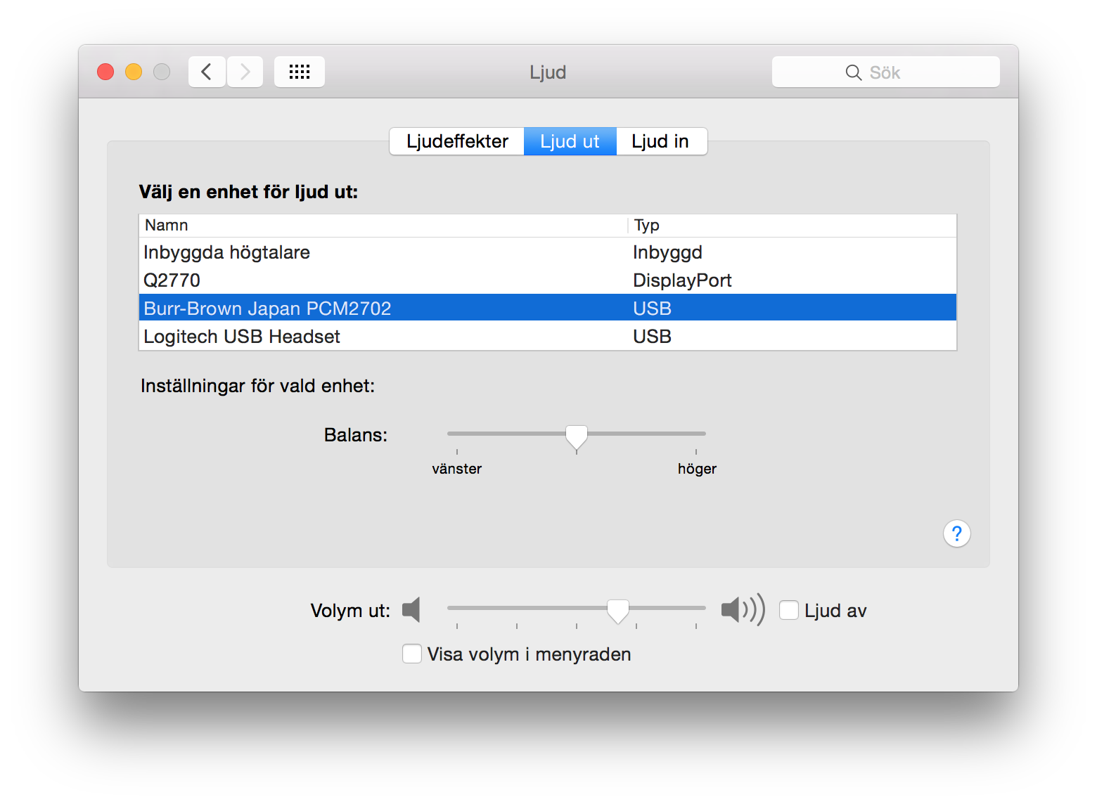

You were right, it was the same thing for me, I remembered it wrong. I installed Yosemite (10.10.5) on an external HD and booted from it, just to check. Indeed there were no volume controls for my monitor speakers connected through DisplayPort.
But the volume control for my DAC, my main issue, was back. So this is a clear regression (from my point of view) between Yosemite and El Capitan.
Yosemite:
El Capitan:
(Sorry for the Swedish, it says "The selected device has no output control".)

Well, I'll be damned but it seems like this issue is fixed in Sierra!
I stayed on El Capitan until Sierra 10.12.2 was release yesterday, so I don't know if this got fixed in 10.12.0, 10.12.1 or 10.12.2. I have a faint memory of trying 10.12.0 (booting from an USB stick) and that the volume control still didn't work, but I'm not sure about that.
Anyway, unless this is a fluke I am very happy that Apple reversed the wrong-doing (IMHO) in El Capitan and returned the ability to volume control my USB-DAC.
(Yes, the screenshot is Swedish, but I just wanted to show the difference between this and the old screenshot from El Capitan.)
