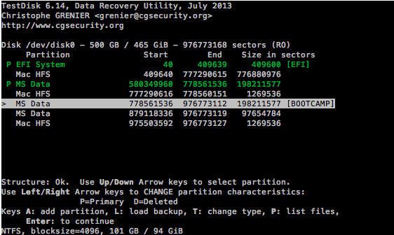

So @murphychris
I would like to turn your attention to the results I got from testdisk. As you can see from the image that highlighted MS data is the one I want. It has the 101GB that I allocated for my windows partition. If this is correct how can I fix the partition table using this.
Just out of curiosity, as now I'm back from where I've started - is there some "secure" way of splitting my OS X partition into two, while the new one gets a ntfs formated "D:" partition, I could use with windows?
The nearly secure way of anything is multiple backups with a tested restore method, so that your penalty for an irreversible mistake is near zero. And I also haven't tested this, but it should be possible in your case because you're in the unique situation without a Recovery HD partition taking up one of only 4 slots in the MBR.
But the other question what's the point of separate partitions on the same disk? It tends to just increase seek times.
It's an open question how to do it though. I'd use diskutil resizevolume <device> limits to see the min-max sizes available. If the OS X volume is highly fragmented or full you won't be able to shrink it by much anyway.
And then you either need to take a blind leap of faith doing this with Disk Utility. Or diskutil resizevolume. And just check both MBR and GPT after each step to make sure things aren't getting out of sync. And for sure have current backups.
@o2themar
Press P to list files. Make sure it doesn't say the filesystem is damaged/corrupt and you can actually navigate folders/files. You can even extract files at this point so you might consider doing that if there's something important you want.
Make a new window so you can keep the testdisk one up. And you'll need to use gdisk to create a new partition using the Start and End values from testdisk, when gdisk asks for First and Last sector values for the new partition. And use partition type code 0700. And then w to write out the change to disk. Reboot.
At this point you should have read only access of the Windows volume from the OS X Finder. Another opportunity to get at your files.
Next, you'll go back to gdisk and create a new hybrid MBR, adding, in your case, partitions 2 3, say yes to putting the EFI GPT in the first MBR entry, accept the default values for type/hex codes by just hitting return when asked, and don't make partition 2 bootable, but do make 3 bootable.
Ok so I am able to retrieve files from using the p command on that volume. So you said to first create a new partition using the start and end values from testdisk using gdisk. Do I use the o command to create a new empty GUID partition table (GPT) or do I use the n command to add a new partition? Also ,even though I am not at that part yet, when I have read access in Windows would I do the second part in Windows or OSX?
New partition. NOT new partition table! 😱 If you make a new partition table you'll nuke all of your data on the disk.
You will NOT have read access in Windows. You will have read-only access when rebooting OS X, in the Finder. And the 2nd part, to create the new hybrid MBR is done in OS X also in gdisk in its recovery menu.
OK actually, since you posted your GPT to this forum, if you were to accidentally create a whole new GPT, while you would lose access to all of your data, it is recoverable. The partition table is not stored in the same location as your data so the data is completely intact.
Ok so after doing the first part this is what I got:
Final checks complete. About to write GPT data. THIS WILL OVERWRITE EXISTING
PARTITIONS!!
Do you want to proceed? (Y/N): y
OK; writing new GUID partition table (GPT) to /dev/disk0.
Warning: Devices opened with shared lock will not have their
partition table automatically reloaded!
Caution: More than one 0xEE MBR partition found. This can cause problems
in some OSes.
Warning: The kernel may continue to use old or deleted partitions.
You should reboot or remove the drive.
The operation has completed successfully.
When I rebooted and held down the options key windows wasn't there. I am assuming that it shouldn't appear until I complete the second part is that correct? Also I do not see Windows in my finder. Did I do something wrong or did it just not work?
