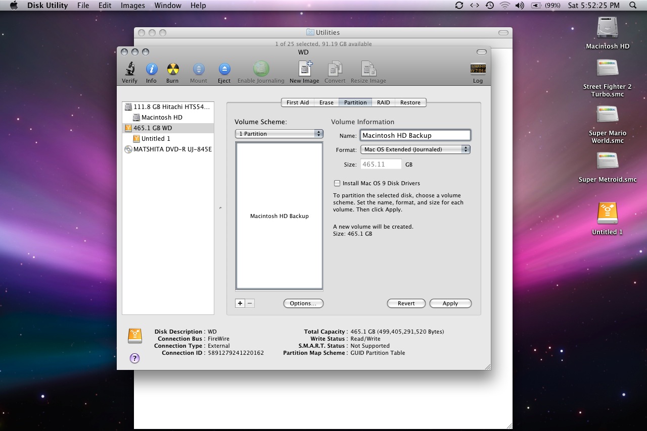

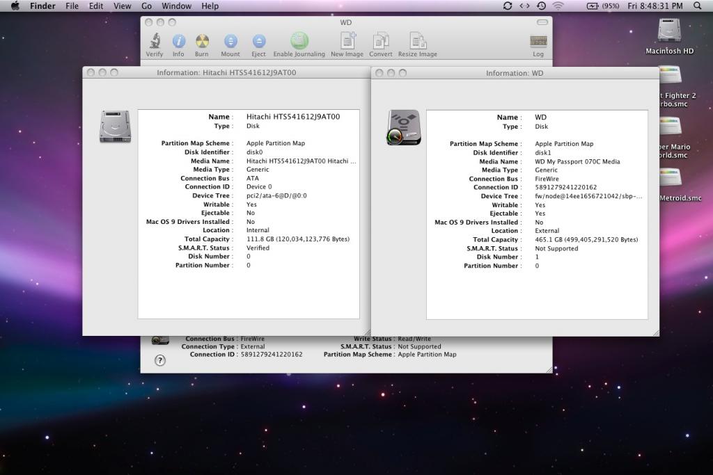

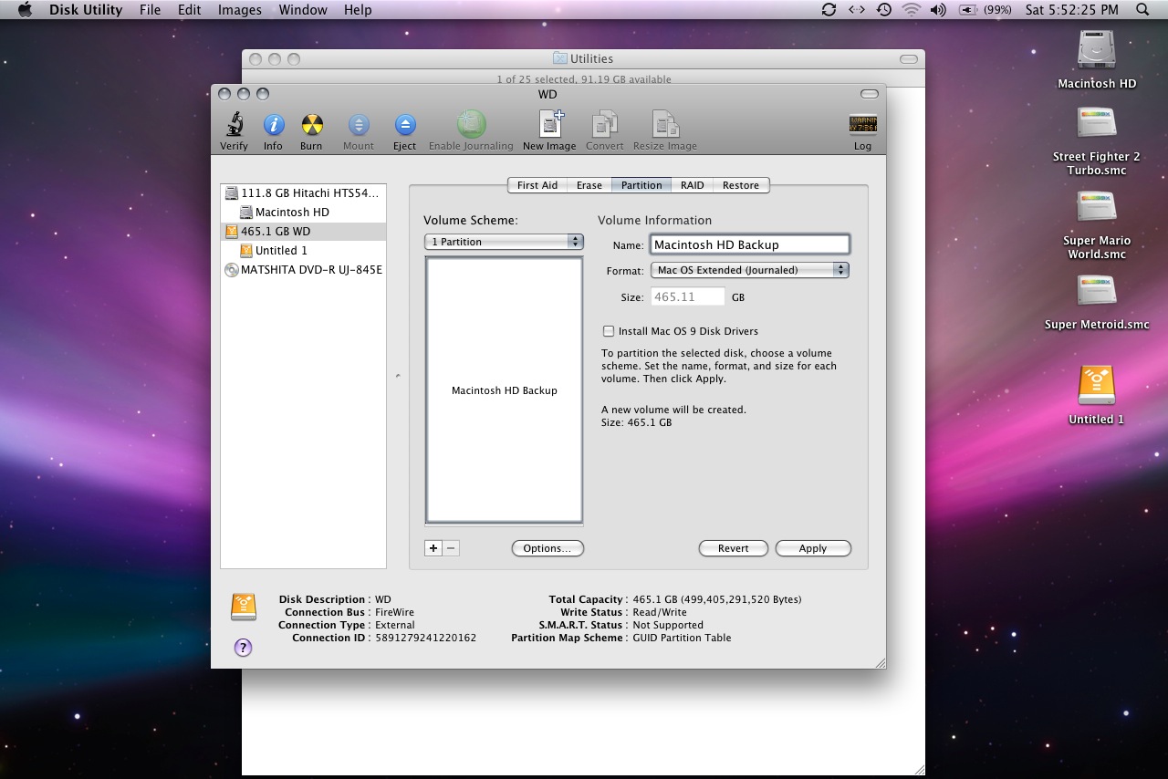

I think I figured out the problem. Apparently there's a partition for the "SmartWare" and I think that's interfering with me being able to boot.
Is there any way to remove this partition? I've tried everything.
Format the drive with GUID or MBR, then back to AMP. That will get rid of any hidden partitions on it.
I too have a WD drive. It's pretty irritating that most every drive has junkware preinstalled that does nothing but get in the way.

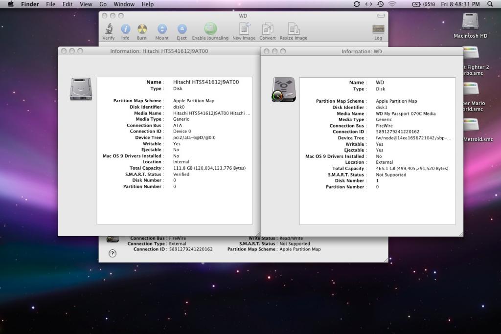

Yup. No dice getting rid of it. I tried partitioning to GUID and MBR then back to AMP and it's still there. I'll attach some pics..
The first pic you can see the small partition at the bottom.
The second pic shows that there is some used space showing even though the drive was freshly formatted.

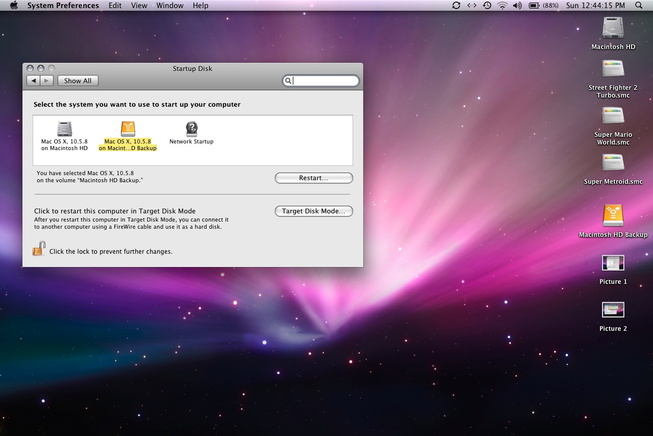

The third pic just shows that the OS is installed and I can boot if I use it as my start up disc but that is all.

Which Western Digital Drive is this? My WD Mac specific drive is not bootable on a Mac, I don't know why.
Check WD's website to see if it is just the drive.
It's a 500GB My Passport Studio.

There is some issue with the WD external drives and PPC Macs. I think you'd have to break the hard drive out of the WD casing and put it in a new external firewire case (after reformatting) to make it work. Search MR, there is someone else here who had that problem.
It's not a WD bare hard drive issue, it's some issue with the external casing/wiring.
I've never owned these types of external drives/casings -- only firewire MacAlly and Acomdata (now defunct!) and lately an Apricorn universal usb thingie that are made for macs.

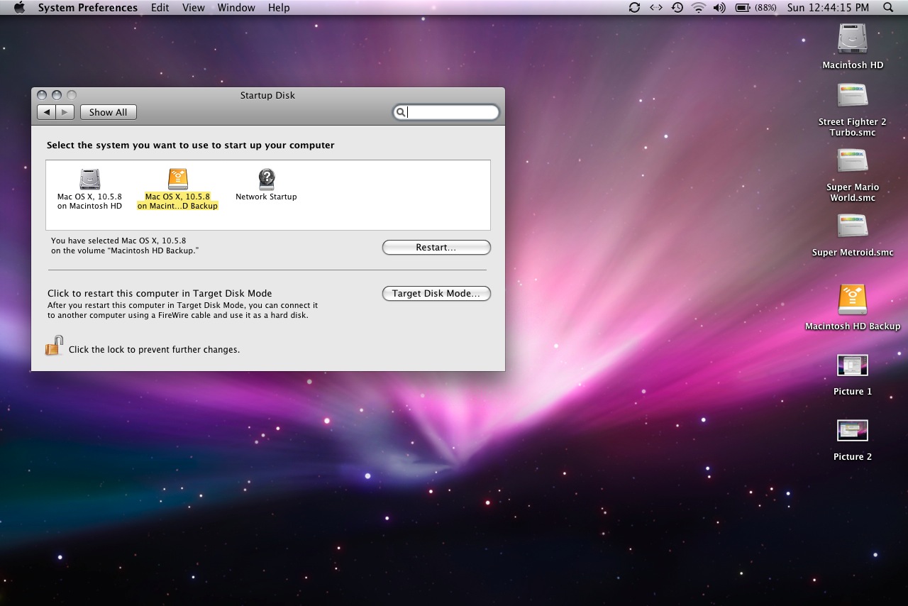

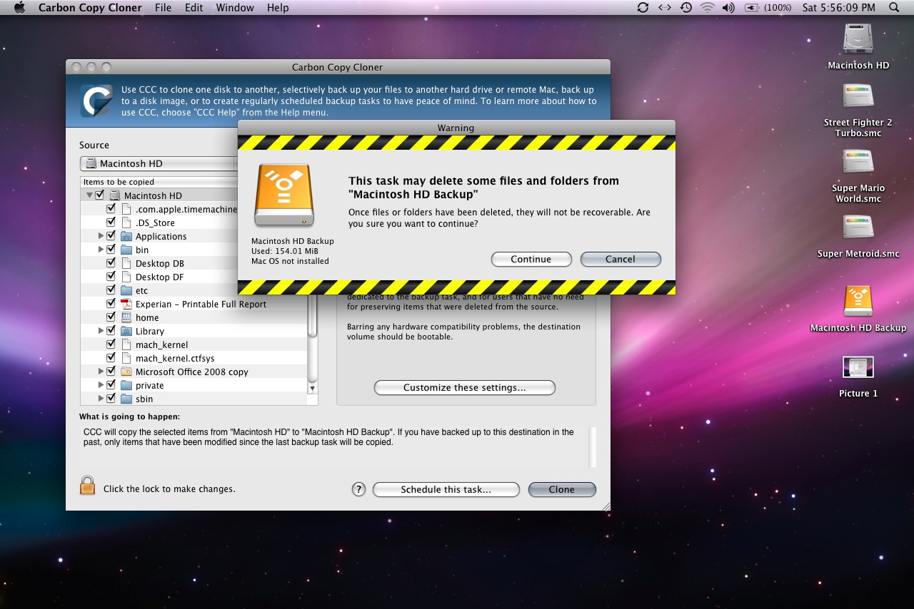

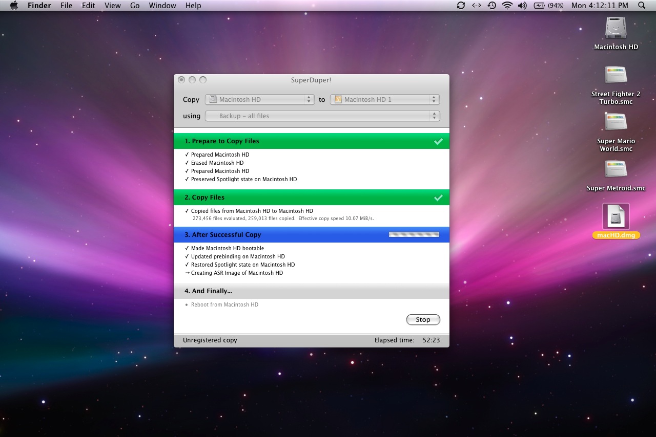

I'm about to give up. No matter what I do, I can't boot from my external. I actually realized that even when put it as my startup disc, it still boots from my internal.

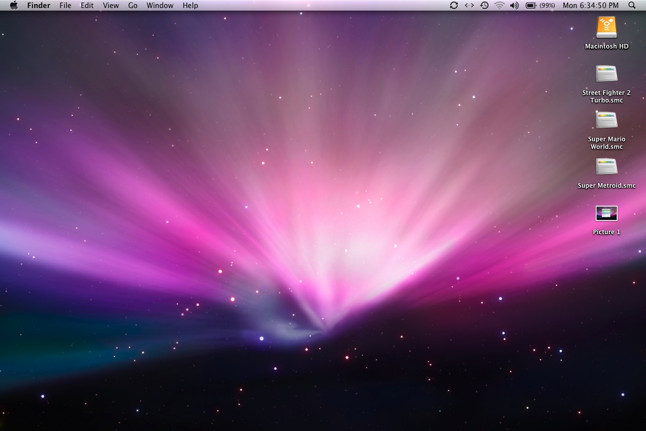

I also realized that neither CCC or SuperDuper! were cloning all of my files. See the first attached pic for that. Can that be the issue?
In the second pic, it's "booted" from my external and looks like it's booted but I can actually eject the drive so it can't be running from my external.
Use the Restore function in Disk Utility to make an exact copy of your internal drive. Just drag your internal drive to the "source" box, and your external to the "destination" box. Make sure to check the box marked "erase destination". This is necessary in order to be able to start up from the destination drive. At least, that's how it normally works.
I found the following page on WD's website. Sorry to say it appears your external is listed as not bootable on Power PC Macs. So, my previous recommendation can be ignored.
I tried it before anyway with no luck of course. So, this has been resolved I guess.. Not what I wanted to hear but at least I'm done wasting my time.
