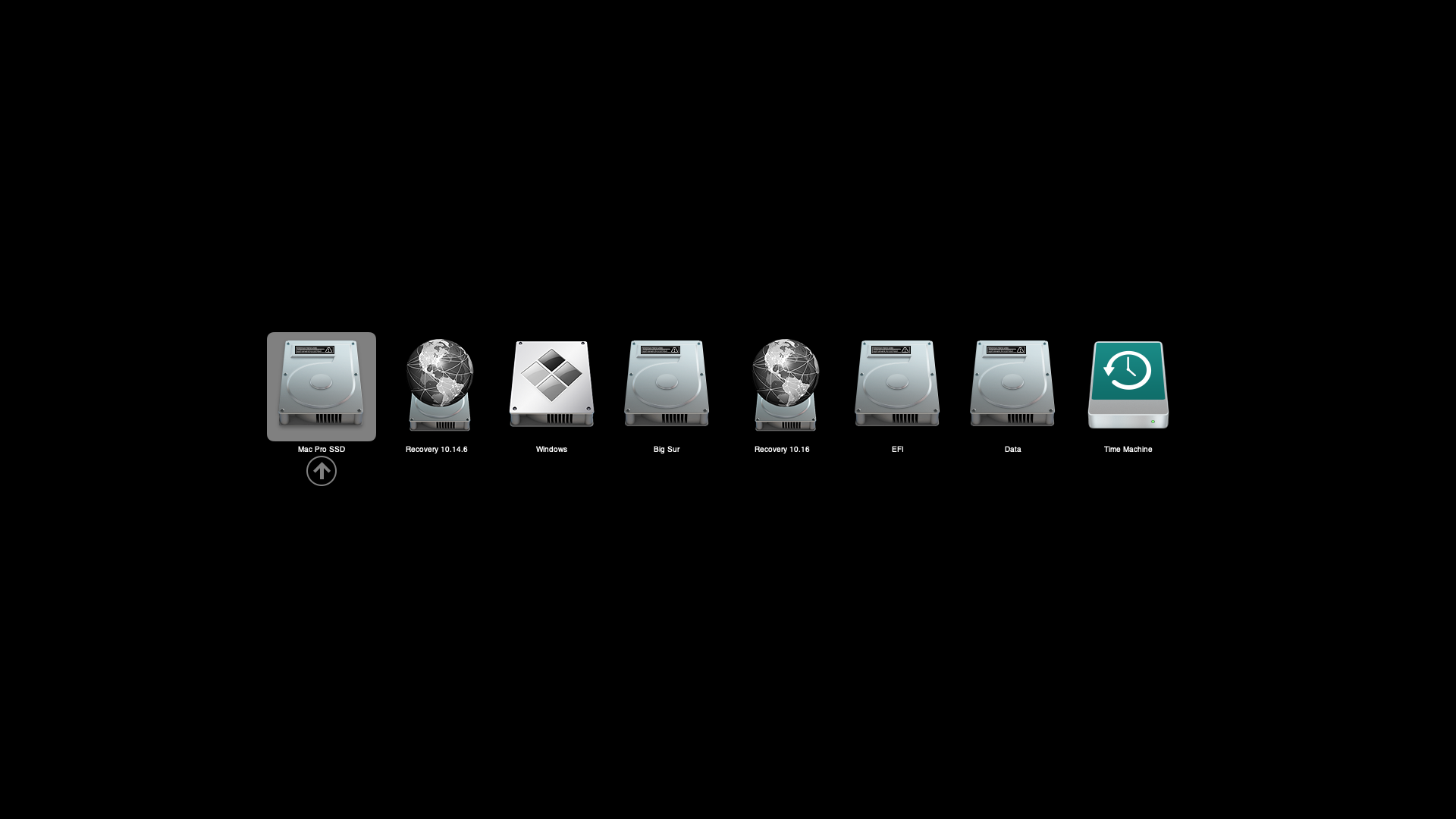

Anyway, TM Backup is bootable. It depends on how you connect the TM drive.
I did some more investigation today, and no, I don't think Big Sur Time Machine backups disks are bootable.
In Catalina there is a checkbox in Time Machine settings, "Exclude system files and applications". That checkbox is gone in Big Sur.
In Catalina if you don't check this, a time machine backup will contain both the "Macintosh HD" system volume and the "Macintosh HD - Data" user data volume. In Big Sur, which doesn't have the checkbox anymore, a Time Machine backup only contains the "Macintosh HD - Data" volume. It's not bootable and you can't restore the entire system from it.
Maybe those of you who still see it as bootable are "continuing" a time machine backup from your previous Catalina install?
