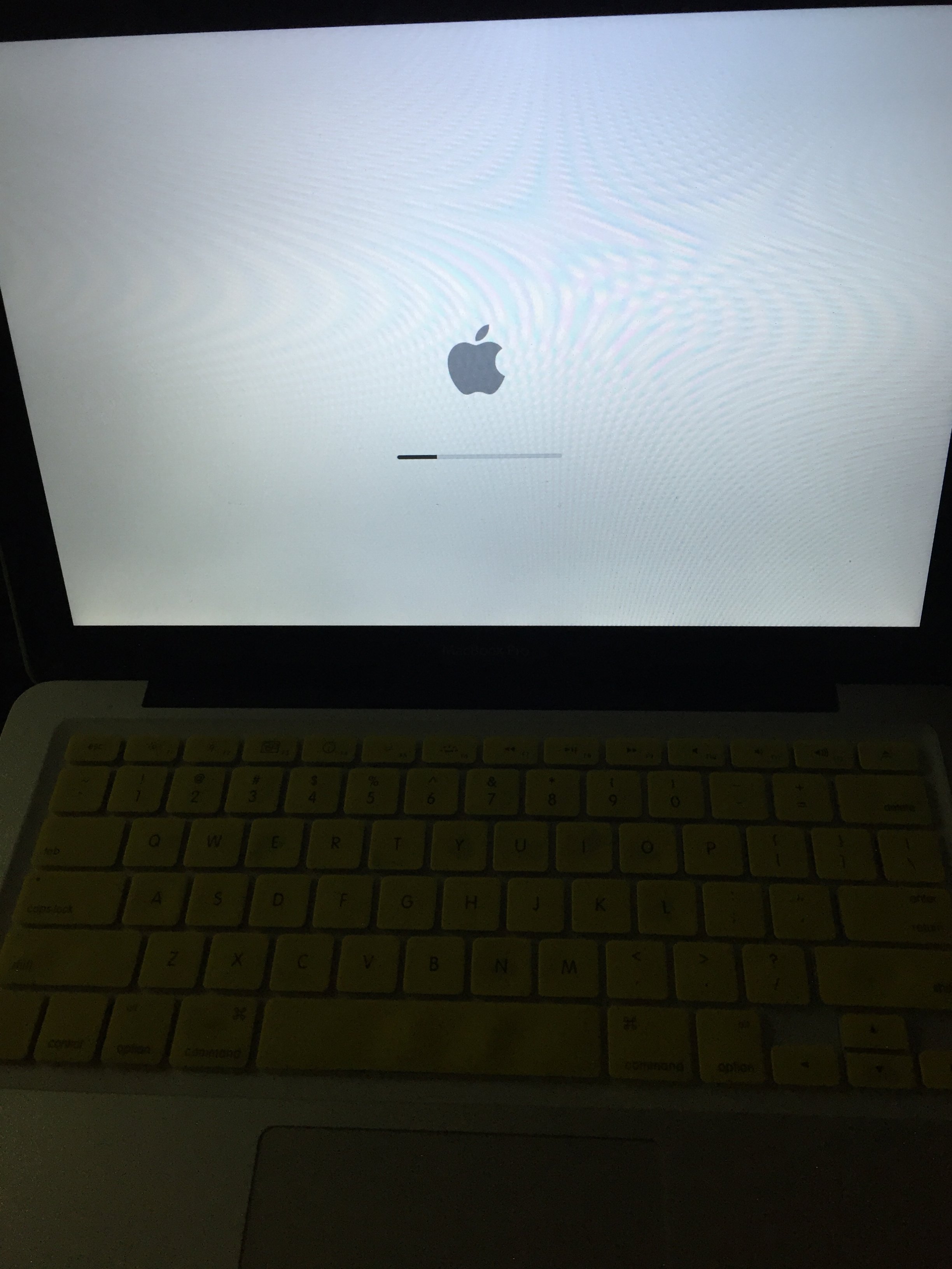

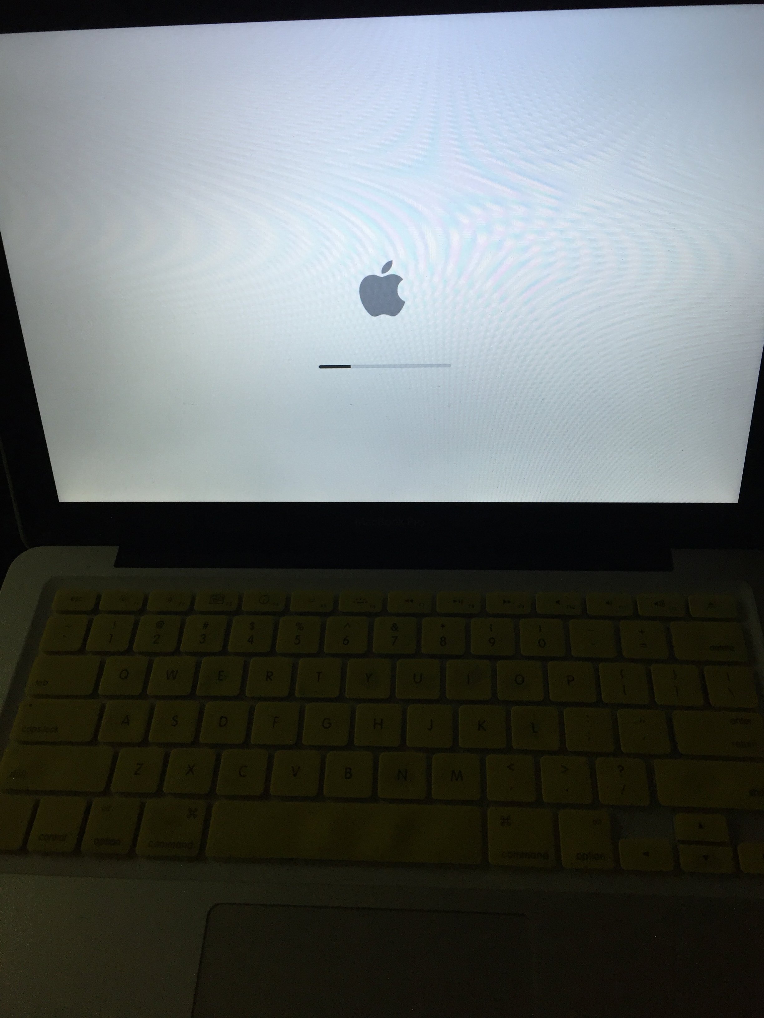

this is what I'm getting when I started my laptop.
I have macbook pro . we bought it 2011 so maybe this is 2009-2010 laptop.
I didn't upgrade it yet to SSD .

That is a (normal) boot progress bar.
Does it not finish? (What happens if you wait? Give it some time - at least 30 minutes - to do anything else)
Can you boot into your Recovery system (Restart, while holding Command-R)
Run Disk Utility then, and try to repair your hard drive.
Let me know what happens. That will be another way to see if your hard drive is any good, or not.
You can ALSO try to reinstall OS X from the recovery system. I don't expect that will work, but may help get your hard drive working again (maybe!)
Or, the reinstall will fail miserably, which again is your clue to replace the hard drive.

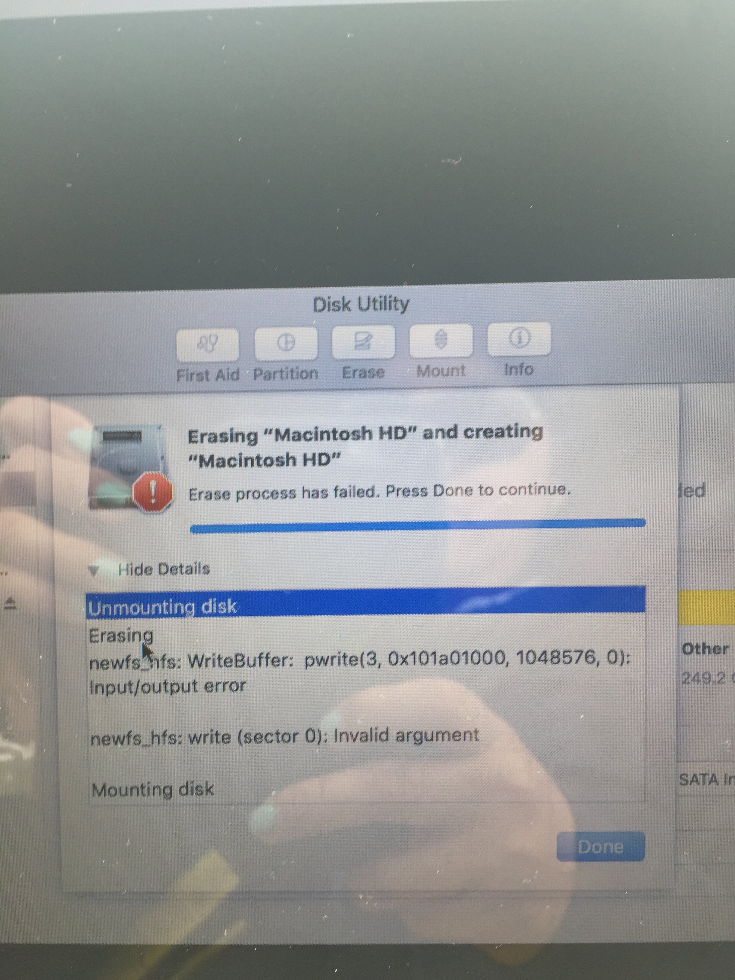

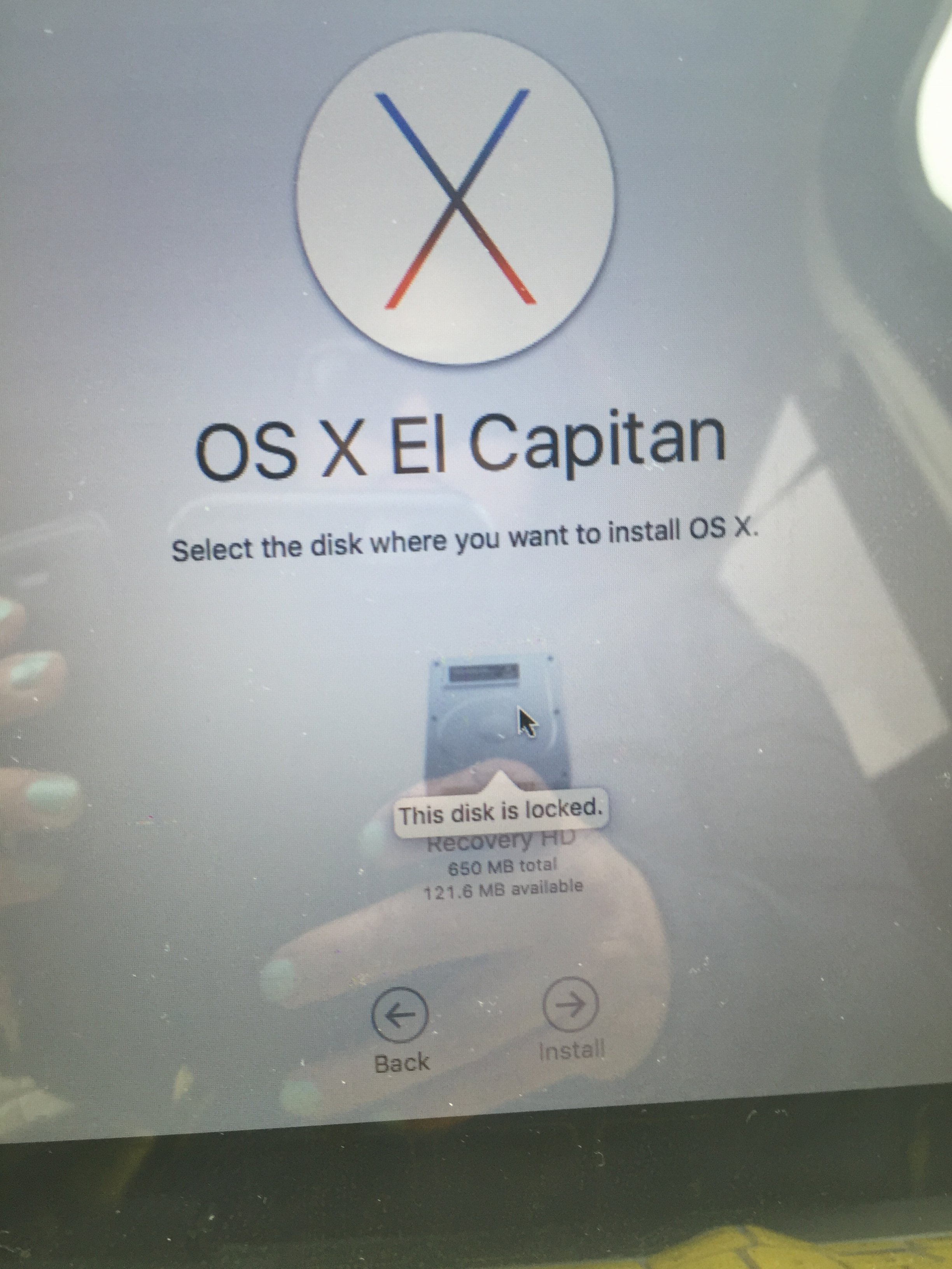

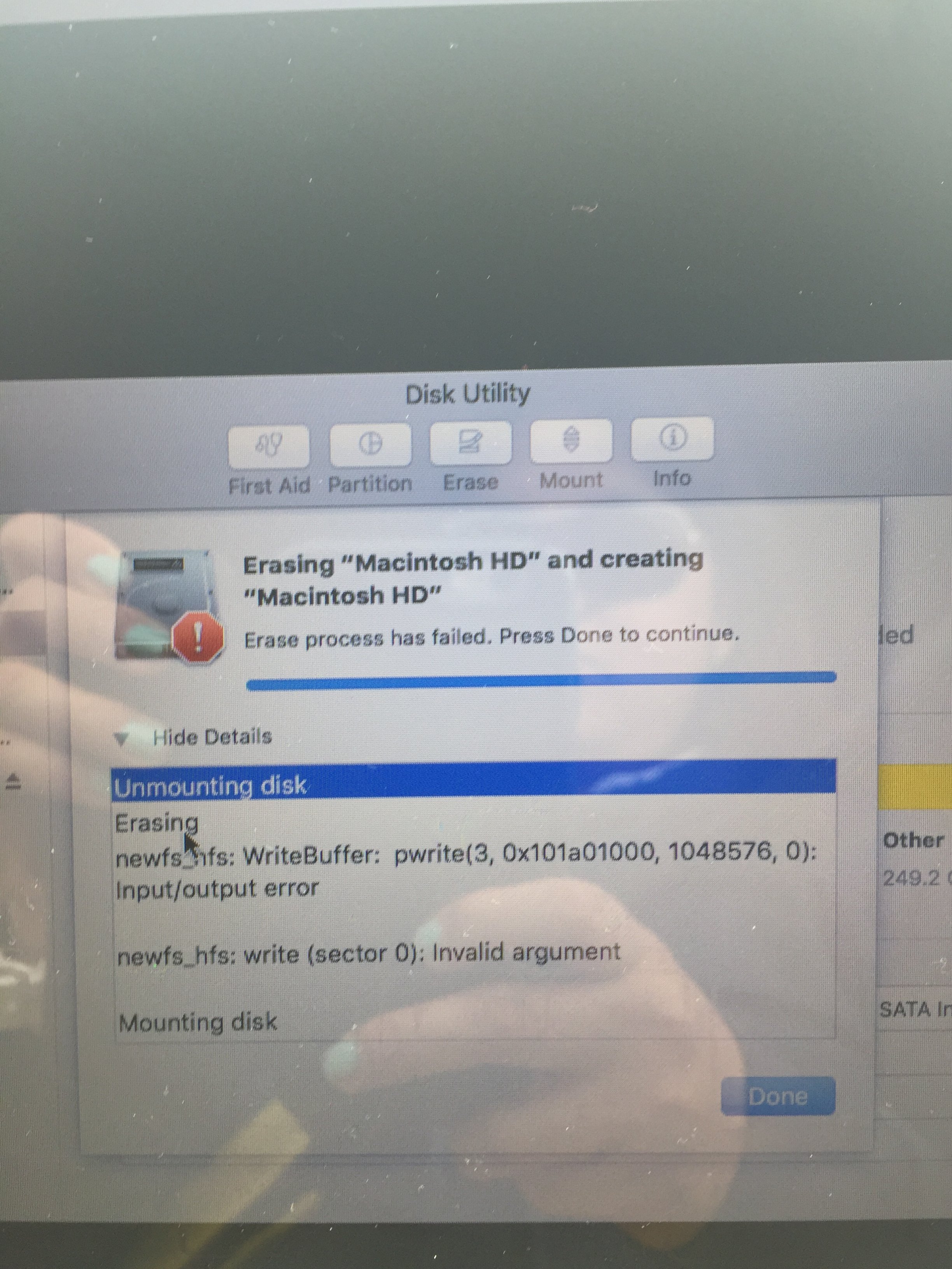

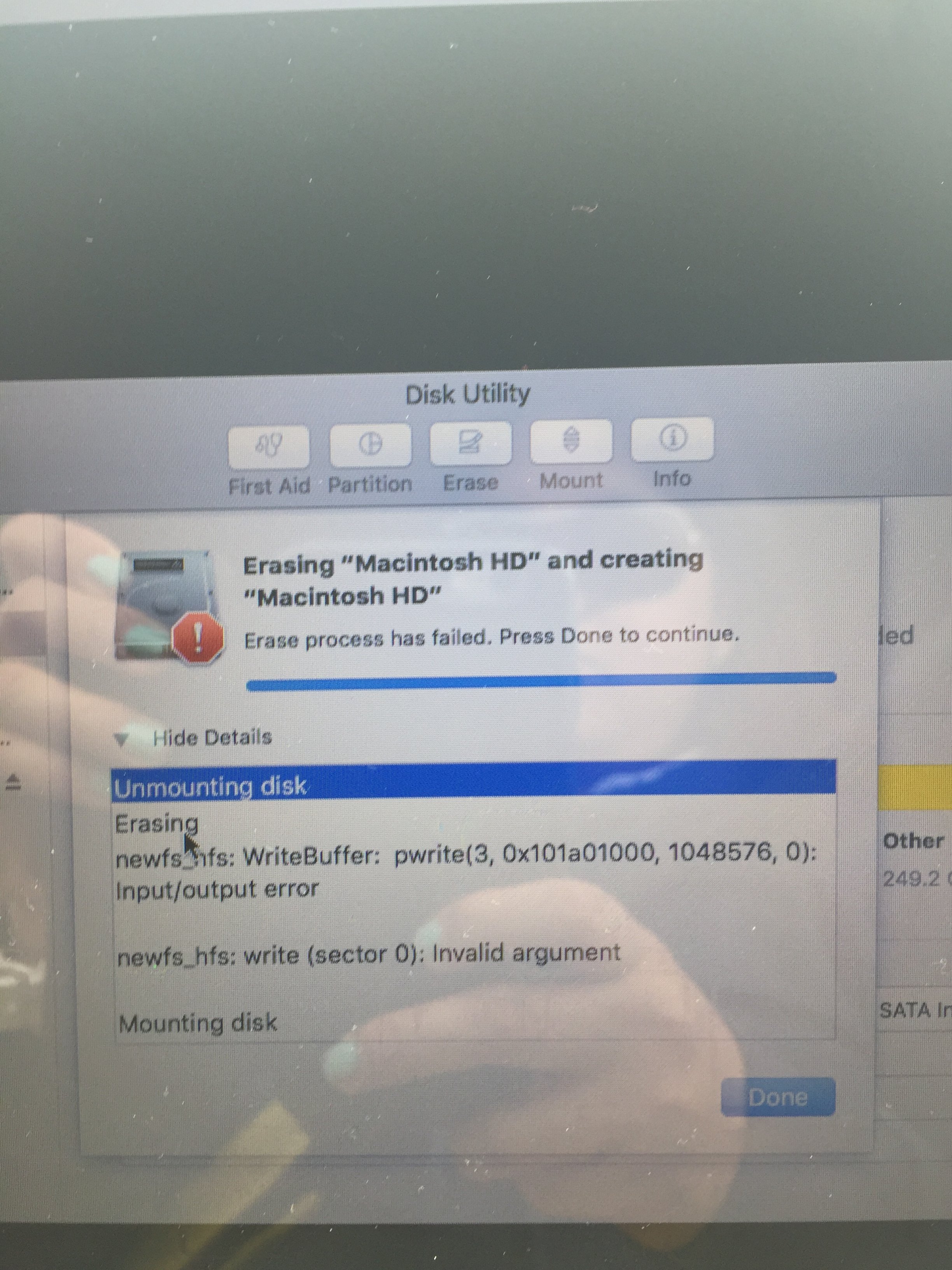

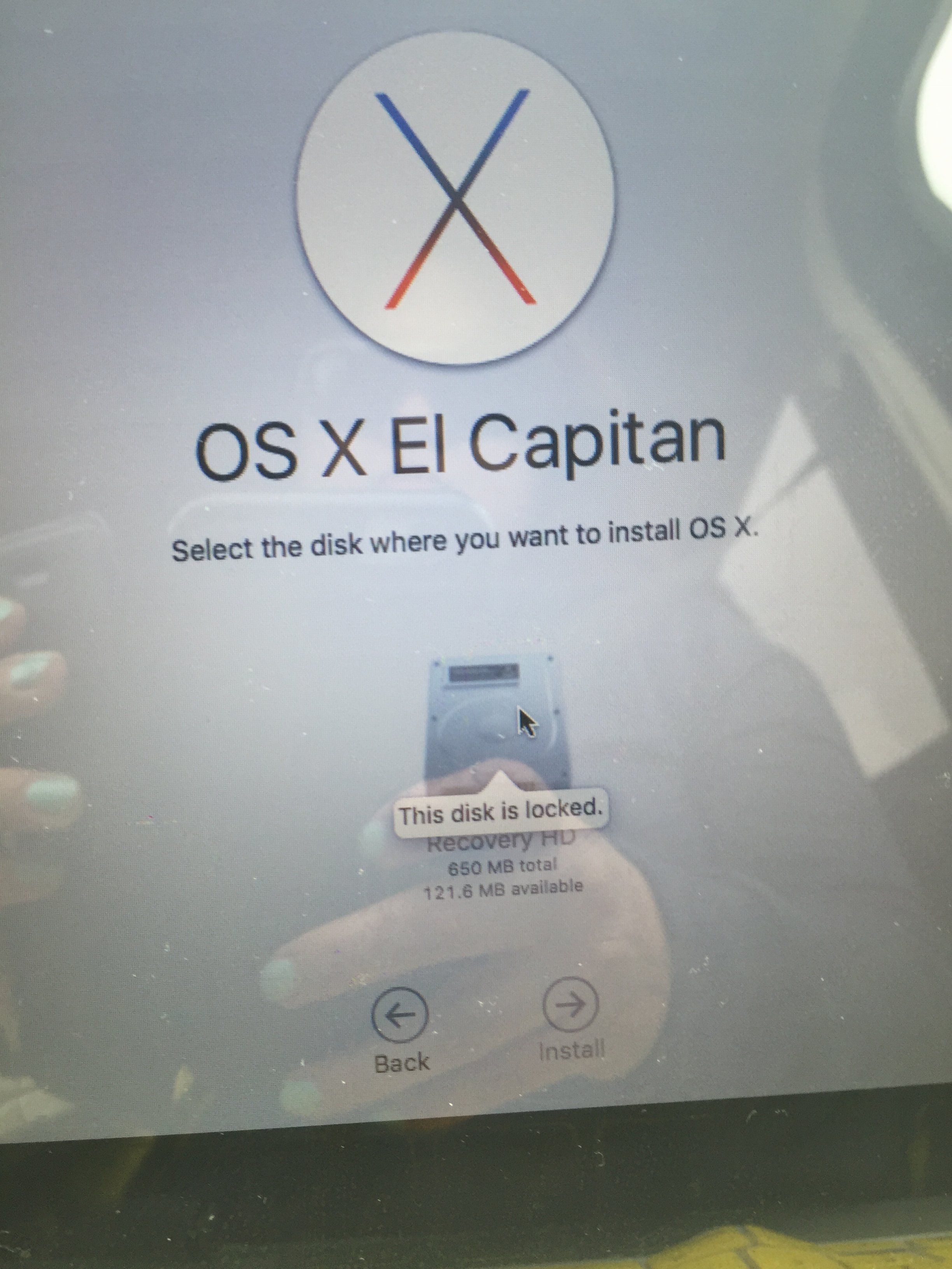

Please find the attached photos , I tried booting it through recovery system but error and also i cant reinstall OS X .

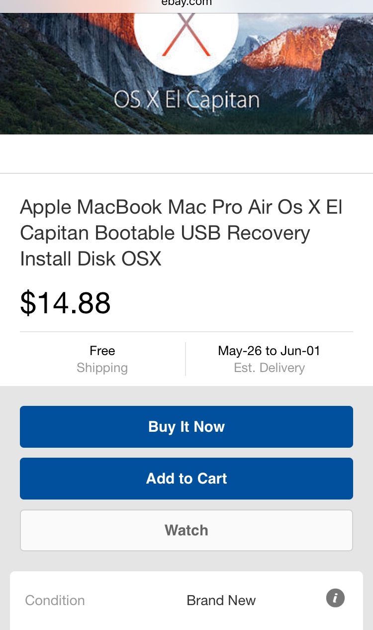

Would you recommend me buying that usb recovery from ebay? do you think it will work ? I am really desperate as I am starting my home based business and this happened 🙁

Also, after when the progress bar loading finished, my macbook auto shuts down and thats it. I need to turn the power button and it shows the progress bar again
Totally not worth it. If you know someone else with the similar Mac, they might have the original DVD. Or they can download El Capitan from the App Store and create a bootable USB stick,
https://support.apple.com/en-ca/HT201372
And like DeltaMac said, you probably need a new hard drive. You can get a 500GB SSD for about $100. ie.
http://www.bestbuy.com/site/pny-cs1311-480gb-internal-sata-iii-solid-state-drive/4825401.p
You can find the installation instructions on ifixit.com.

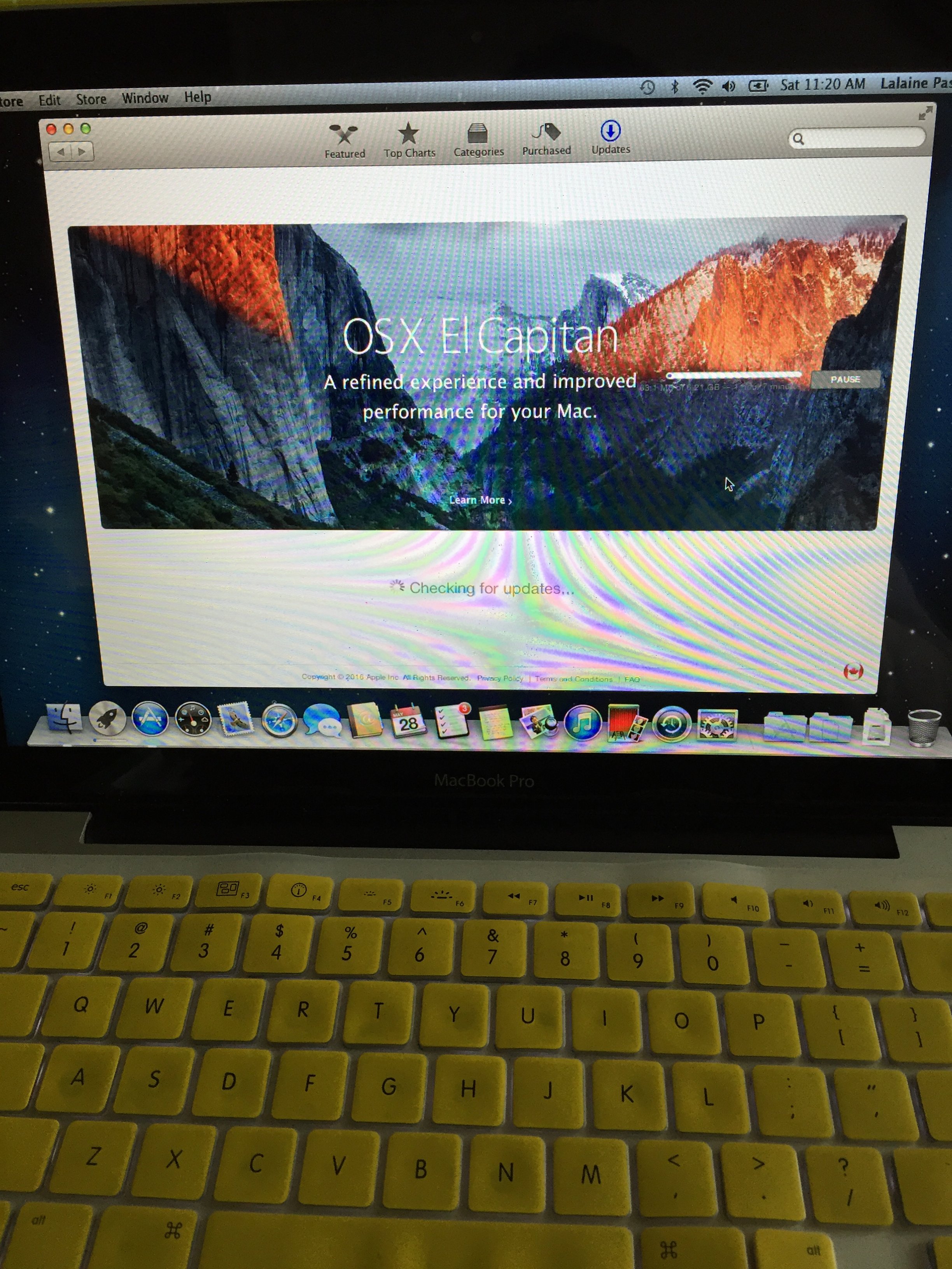

Thank you so much for your help my macbook is working grea. I followed your instructions. I am using SSD and my macbook pro is running so fast!! Unbelievable that I could do it myself to save some $$$ while starting a new business.
Thank you again and Have a wonderful day!!!

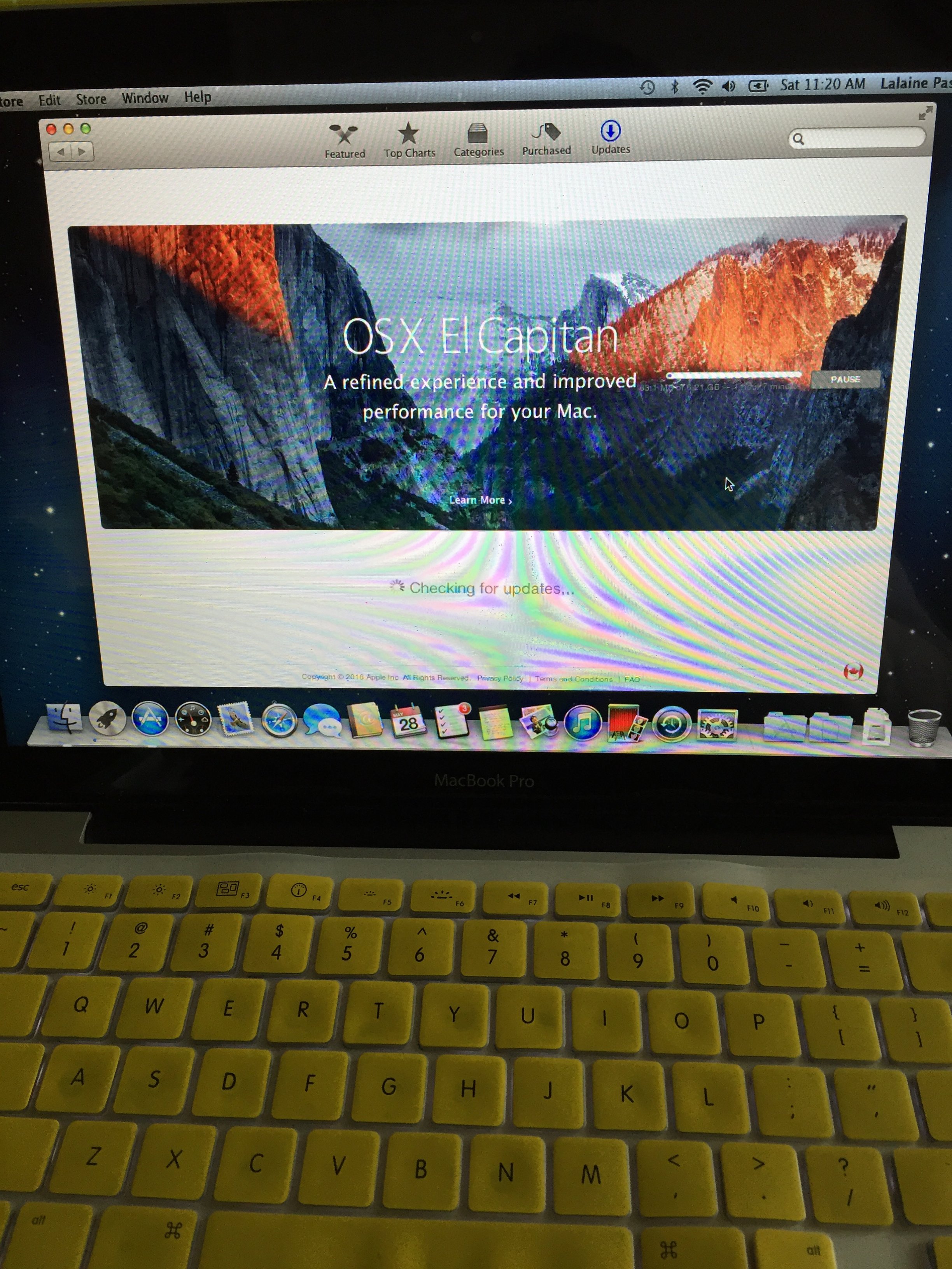

Please find attached photo my macbook pro 🙂

That's awesome! I'm glad you did it and it succeeded! 😀
