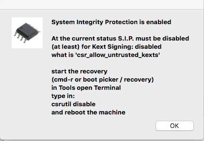

OCLP still not on drive (I think so), when I starting to install it, after "backup firmware" message says :
So , after when I'm restarting Mac&holding cmd-r it does not enters Recovery Mode :-(

After that I tried to run RomDump again but the same window popped up saying that I need to disable kext in S.I.P. :-(
