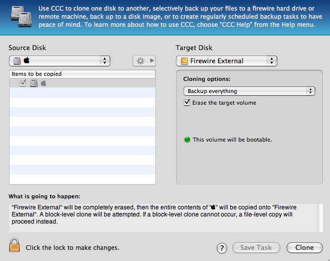

What happened was I upgraded CCC to 3.1, and when I cloned my Macbook HDD there was a green light saying, "This disk is bootable." From there it cloned the entire contents of my internal HDD onto my external firewire drive.
I'm think now I might need to just reinstall 10.4.x onto the new drive, and then clone the FW onto the new drive inside my Macbook.

Here's the grab of what the CCC screen looked like that I used.

He will not be able to boot from a firewire drive (or any other drive, for that matter) with a MacBook if the drive was not initialized with a GUID partition table. All Intel-based Macs require this table for boot drives. You can do all the CCC, Option keys, Startup Volume Preferences you want, but it will not boot. Until the OP tells us specifically how the drive was initialized, we cannot help him.
I agree. However, I don't believe CCC confirms a drive as potentially bootable unless it's formatted in HFS+ (and not NTFS or FAT). Presuming it didn't warn him otherwise when he made the clones, the drive should already be formatted properly.
As far as I'm aware, CCC does not check the drive to determine if it's initialized with GUID or APM, both of which are available with HFS+ initialization (for Intel or PPC Macs, respectively). From the Disk Utility help:

Wow, thanks for all of the overnight replies. It looks like I made a mistake way back when I initially formatted the disc. It is partitioned an "Apple Partition" instead of the GUID setup. I was hoping I wouldn't have to repartition the external b/c I've got a lot of files on there that are not on my laptop.
