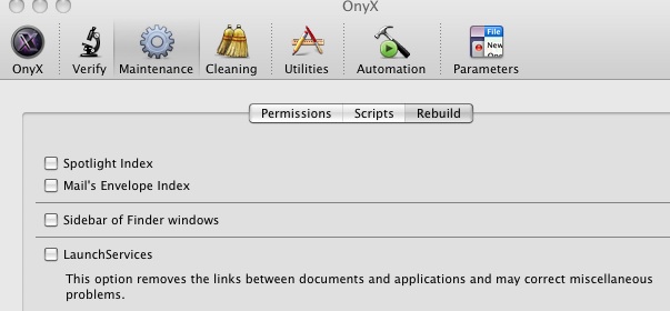

I'd give "onyx" a try and use it to rebuild your "launch services".
