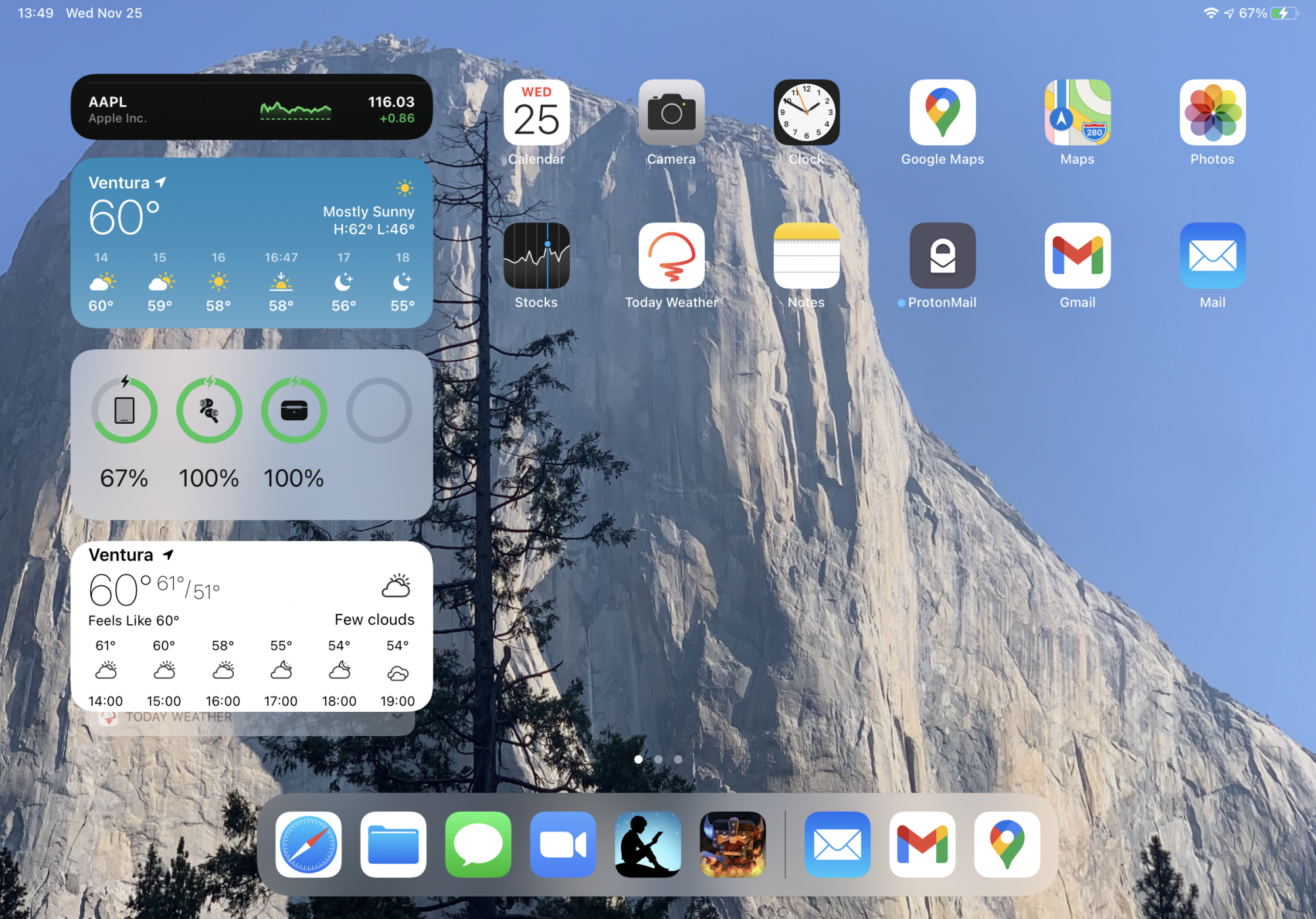

I started changing things over from USB A to USB C. The RavPower and cable (not Apples) I use to “quick” charge my 11 ProMax, my 12 ProMax, and AirPod Pro. O also have a second unit that I keep USB C to USB C for my IPP 11 and MB.

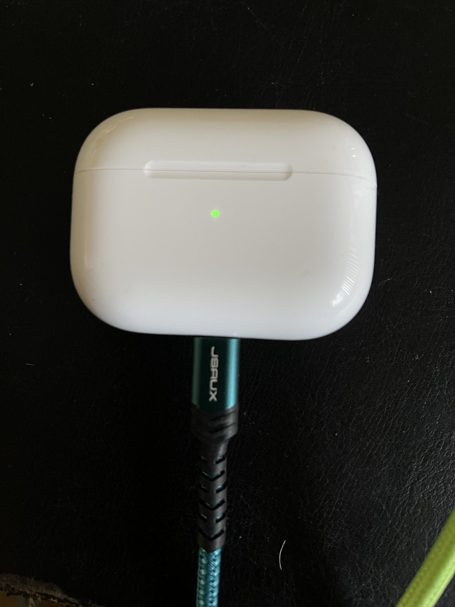

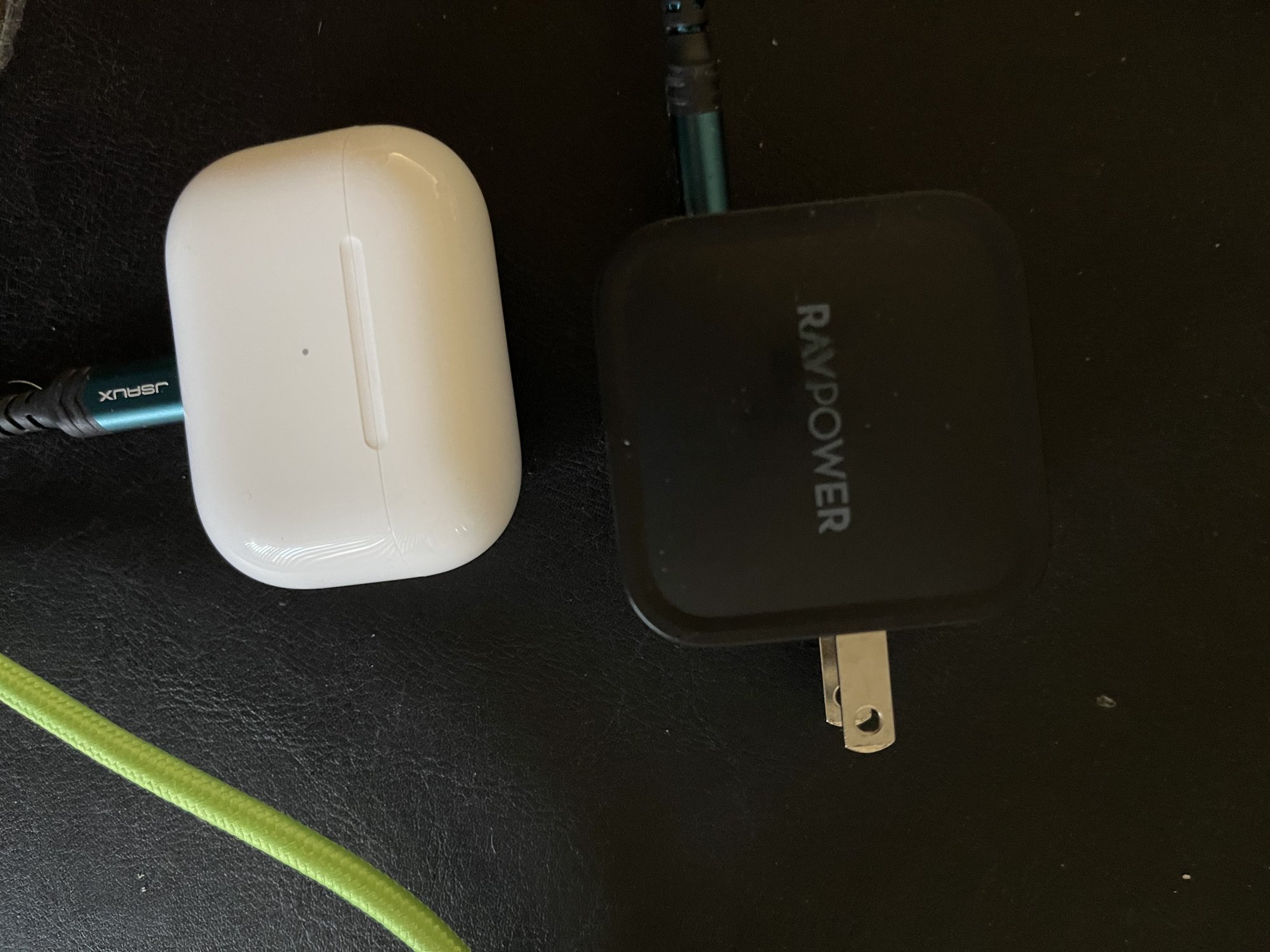

Honestly I never gave it a thought. The AirPods case was low so I just plugged it in. Plugged them in a little while ago and right up from 24% tp 100%. Here is the unit and actual cable I use. 10 ft cable 🤭
