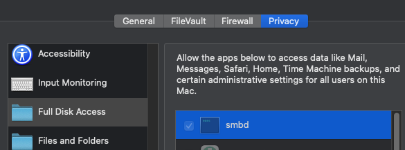

I solved my problem by putting /usr/sbin/smbd into FULL DISK ACCESS under Privacy tab in the Security & Privacy system preference on my iMac (Catalina).
The Macbook Pro (El Capitain) know connects just how I think it should.

I registered here JUST to help you out @yukoncamino as I just ran into this exact same insanely frustrating problem, and the above fixed it straight away!
So, once you are in the Security & Privacy Control Panel, select Full Disk Access in the sidebar, then click the plus symbol to add something. Now here's the trick... while you're in the dialog to select what you want, you will not be able to see the /usr/ directory! BUT... if you type COMMAND-G it will present you a prompt of where would you like to go, and in there you can type /usr/sbin/ and hit enter, and you will be taken to the correct directory, from which you can select smbd and give it full access.
This instantly solved my problems and everything can again access all the external drives on my machine, over the network... including Time Machine. HAPPY DAYS ARE HERE AGAIN! =)
