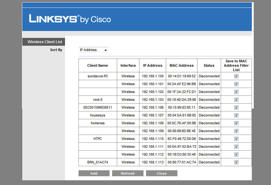

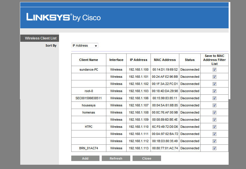

Yes it is enabled and I see a list of all the computers and devices but I see nothing that allows me to add anything. There is a wireless client list button and when I click on it, it opens a window showing all the clients (see screen shot). There is a add button but when I click it it seems to add what is on the list but gives no option, no new window, nothing to add anything else.
How do I add mac addresses?
Or... is it a matter of the router scanning for local devices and their mac address within range? If that is the case it does not see my mac's.
